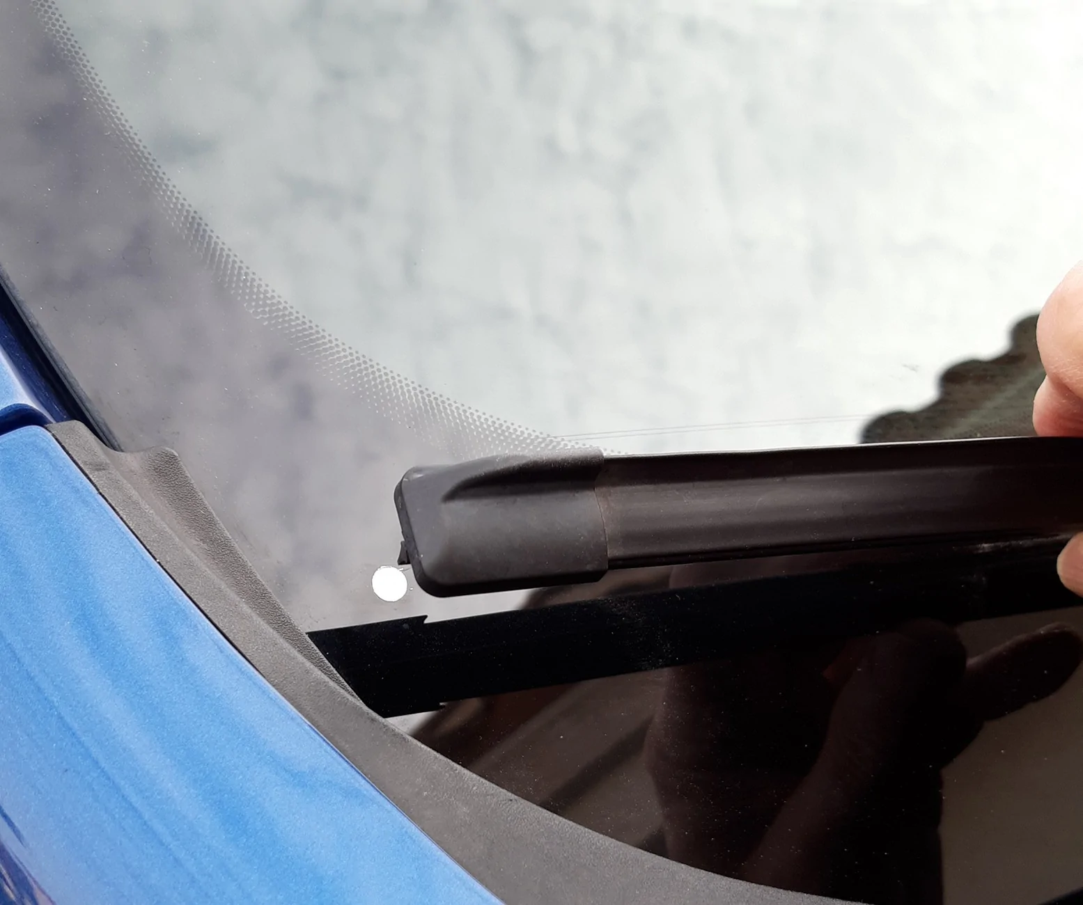

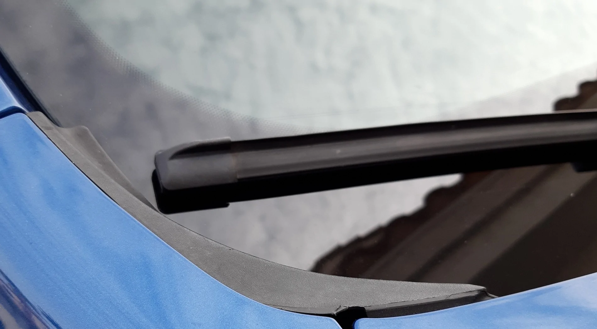

So it could be seen more easily. I put a dot of 3M vinyl over the windshield wiper parking mark. My wipers and blades are original to the vehicle from the factory. There is no way with my wipers parked on the dot they are hidden.
Ford Maverick Windshield wipers 20251230_094414
I would like to see a picture of OEM passenger wiper blade and arm indexed down one on the spindle.
I maintain it would be parking on top of the cowling.

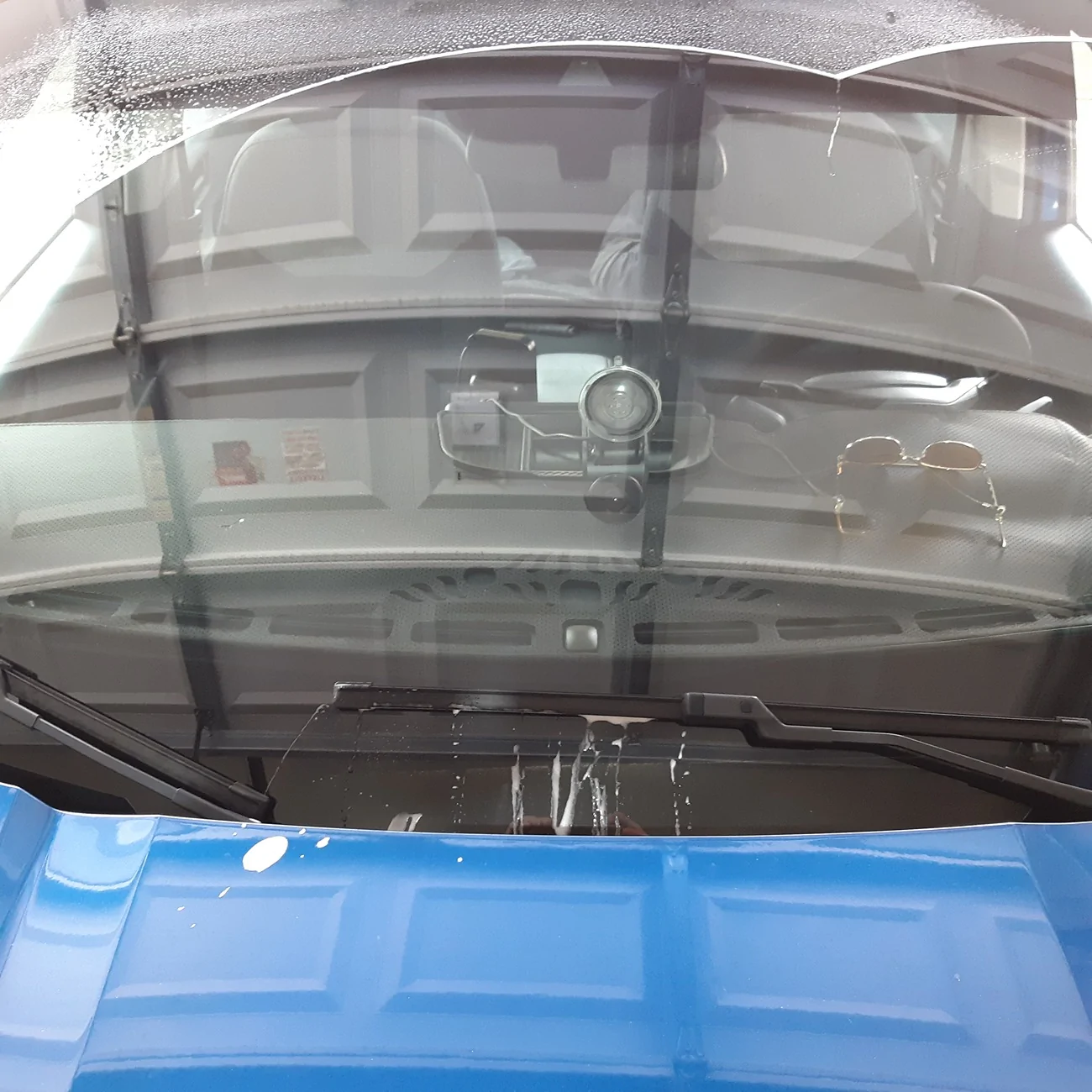

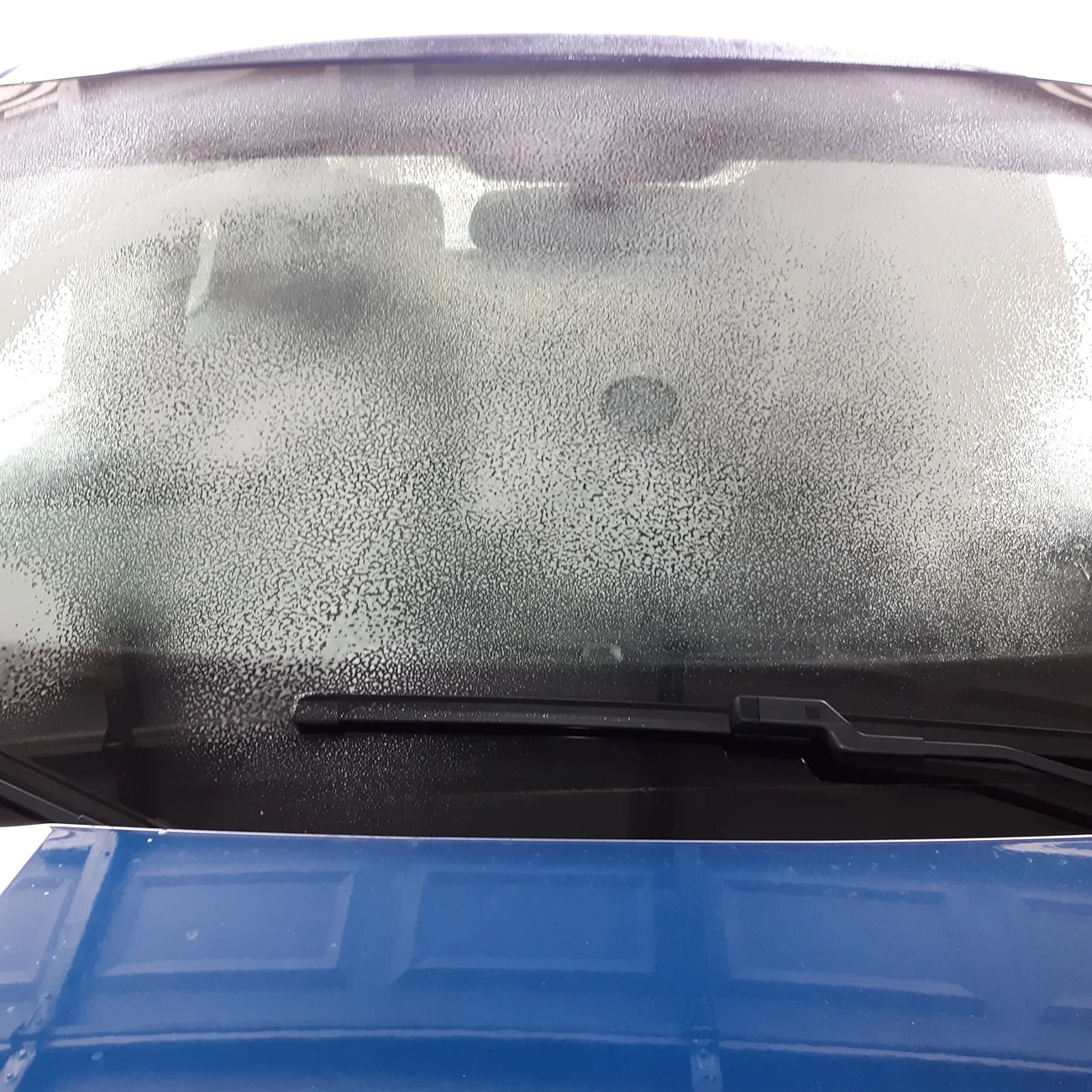

Your post gave me an idea.
No need to wait for rain or car wash.
Aerosol window cleaner works.
All original wipers. Original Factory wiper position. Wipers visible above hood, when parked.
Here is a Baseline wiper sweep.
Ford Maverick Windshield wipers 20251230_111446
Sorry about the reflections. Best I could do in 5 minutes time.
Ford Maverick Windshield wipers 20251230_111628
I really want to see the effectiveness of a shortened and repositioned wiper blade sweep.
Please, post some pictures after wiper modifications.

holy cow I need to clean my windshield!

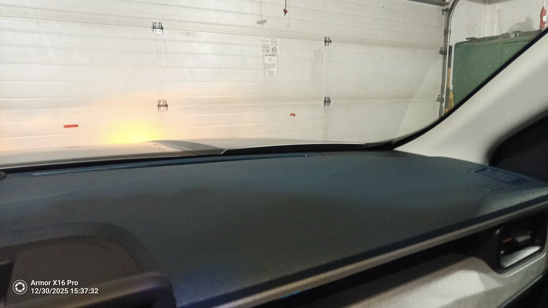

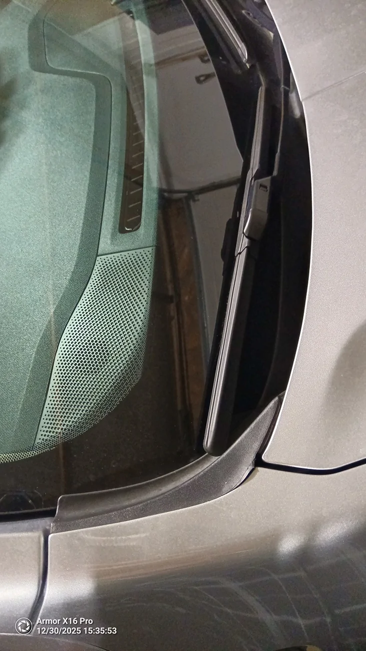

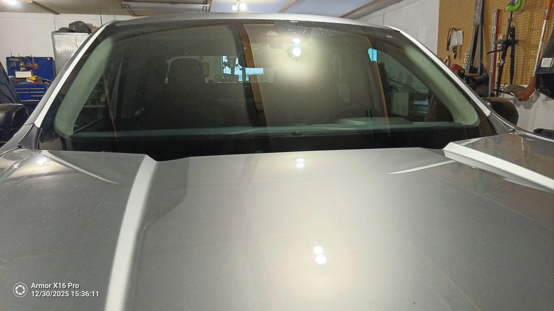

So this is the position of my passenger wiper with the 19" blade on it. You can't see it from inside or outside when looking straight on.
Ford Maverick Windshield wipers IMG_20251230_153554_862
Ford Maverick Windshield wipers IMG_20251230_153612_755
Ford Maverick Windshield wipers IMG_20251230_153732_747

Look's good.
It may help reduce wind noise.
How is the sweep as far as keeping the camera area clean?
Lower the driver's side arm too?
Appears lower - but could be camera angle.

Look's good.
It just misses the camera by a tad. I will get a clean camera warning if it's snowing hard. I going to try a 20" when I have time.
