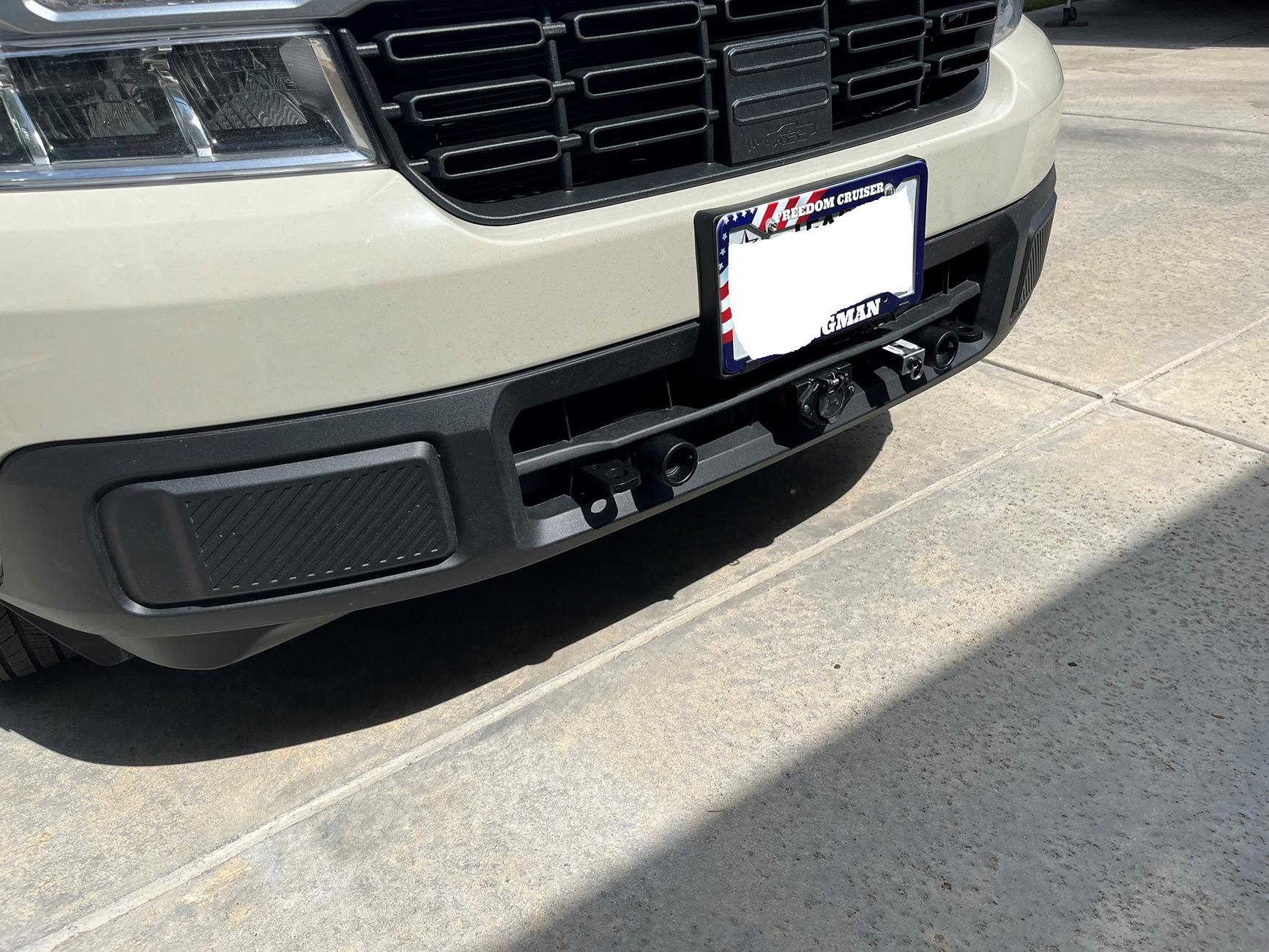

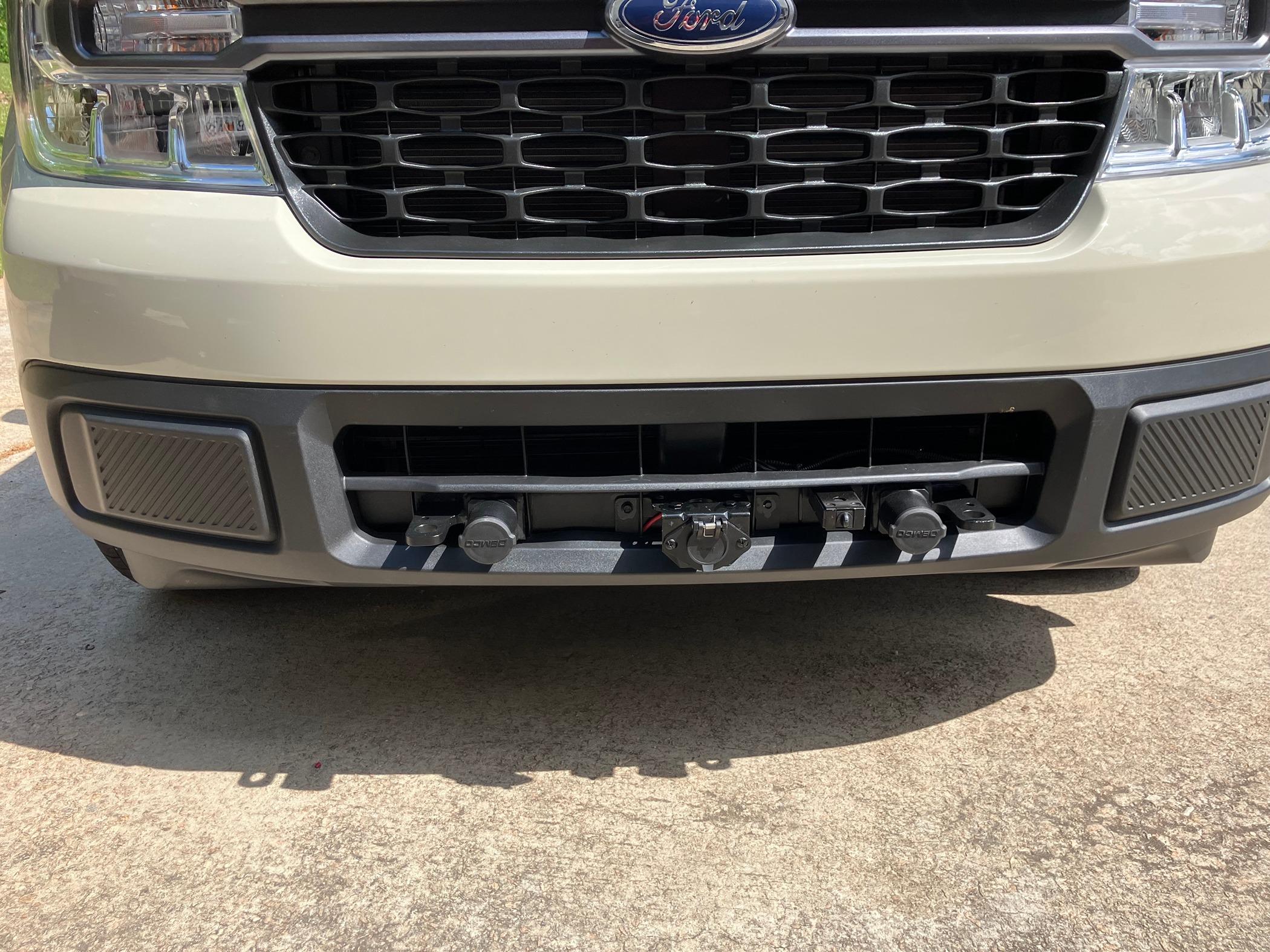

Brad, thanks for breaking all this ground for us. I have ordered all the parts from eTrailer to install the Demco base plate and tried to get all the necessary wiring materials too. I will use the Roadmaster Nighthawk bars and the Blue Ox Patriot Portable Flat Tow Brake System - Proportional. I ordered the battery charge kit and the tail light diode system also. I checked eBay for the diode set your recommended but they are no longer available. My question for you is did you need the brake light switch mod to separate the coach turn signal and brake lights from the Maverick lights? eTrailer seems to state that this is necessary but in all my readings, you and no one else seems to mention adding this mod.
That is one of the reasons I elected to go with cab mounted mag lights. Too much intrusive wiring on the truck and brake switch. The brake relay is necessary. I've already tapped the lights with resistors for the Diode Dynamics LED lights so did not want to add anything else to that loop. And once you try standing on your head in a contorted position for any length of time trying to get to that brake switch you will understand why. I just used my 6 pin to wire in a charge line to the RV. But overall like the Demco install. A special thanks to @phoneman01 for the idea about how to use the Demco bracket in combination with a 6 pin connector

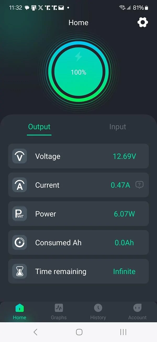

Another follow up. I will be trying the aux power station method of powering the Blue Ox portable braking device. I bought a EcoFlow River 2 Pro, 768 wh power station, which has a 12v cigarette lighter port that the Blue Ox wants. I think that will provide enough juice to drive all day, plus it will be available for other outside power needs. I'll let you know how it goes.
I was going to use a portable power station...but I decided to just wire a cord/socket directly to the battery under the back seat so I don't have to worry about it. I did also add a bluetooth battery monitor to keep track of the Maverick's battery. I used a victron SmartShunt knockoff in the Maverick, not to track electron flow, but just to watch the voltage. Was reassuring.

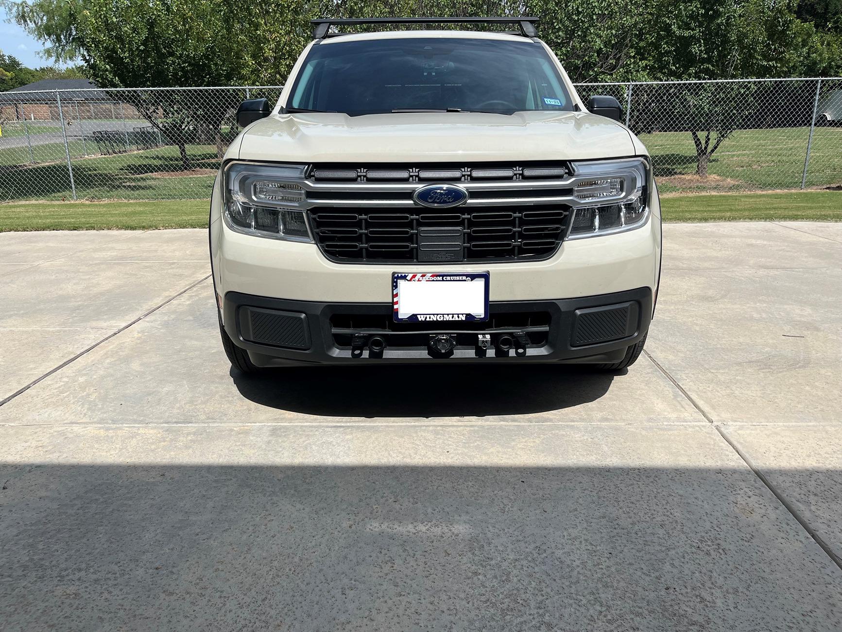

Looks great! How did you attach the break away switch?

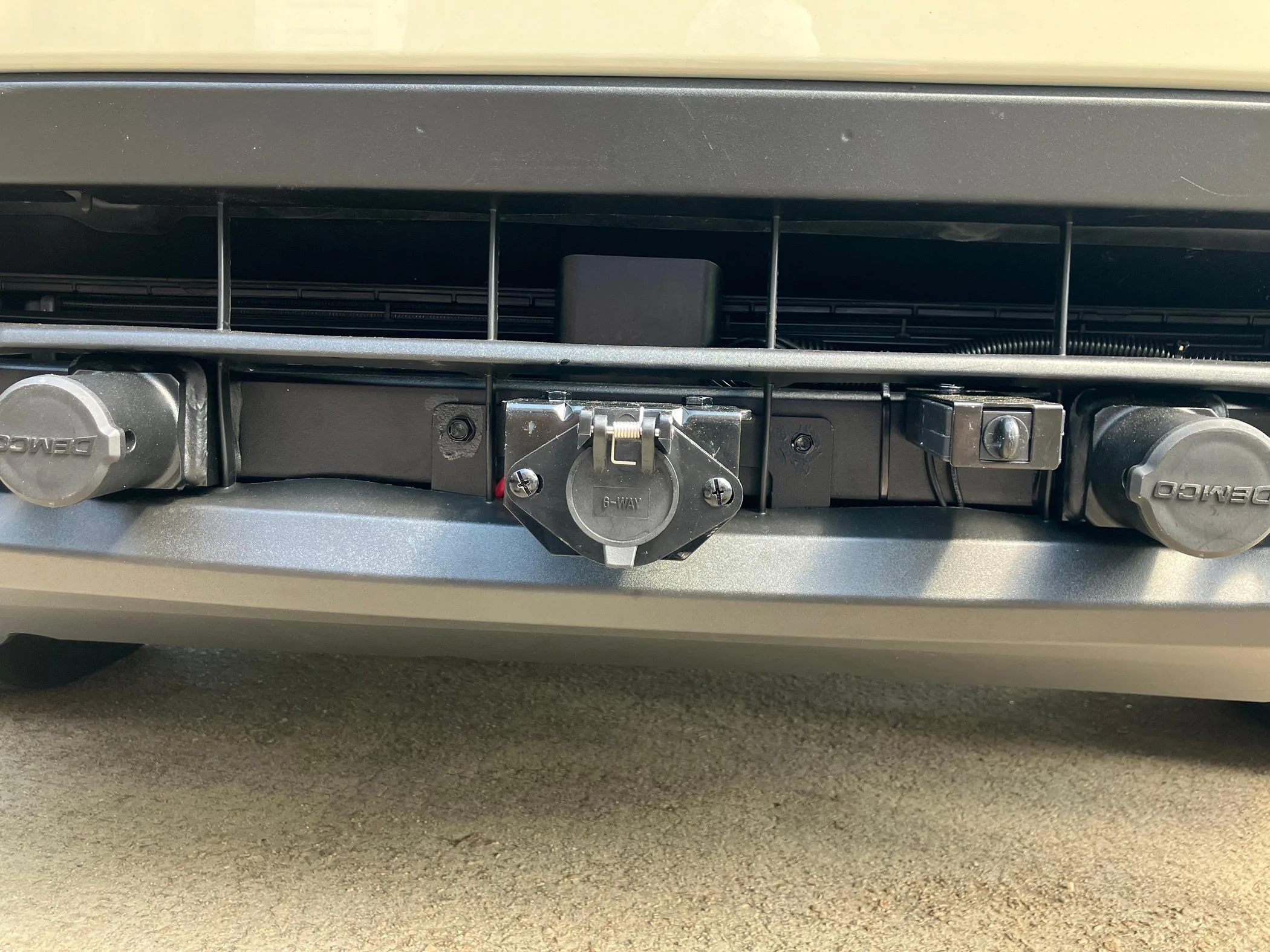

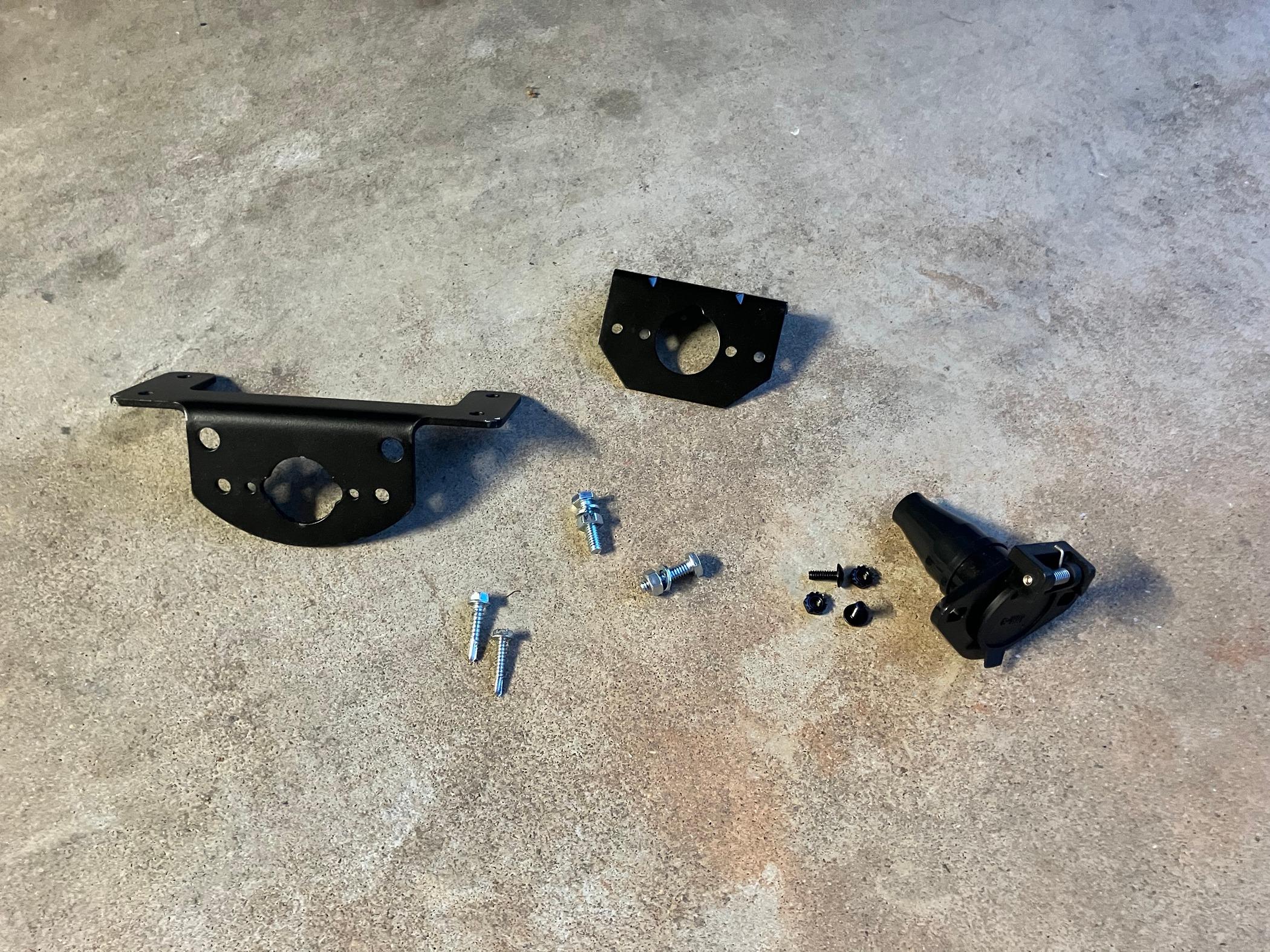

I finally completed my install. The 6 pin mount took some head scratching and wall staring but I figured out a good one...I hope. I used the huge bracket from Demco as a mounting plate for the much smaller bracket and "voila!" I have a front facing mount. Self tapping screws and bolts through both brackets secured everything well.

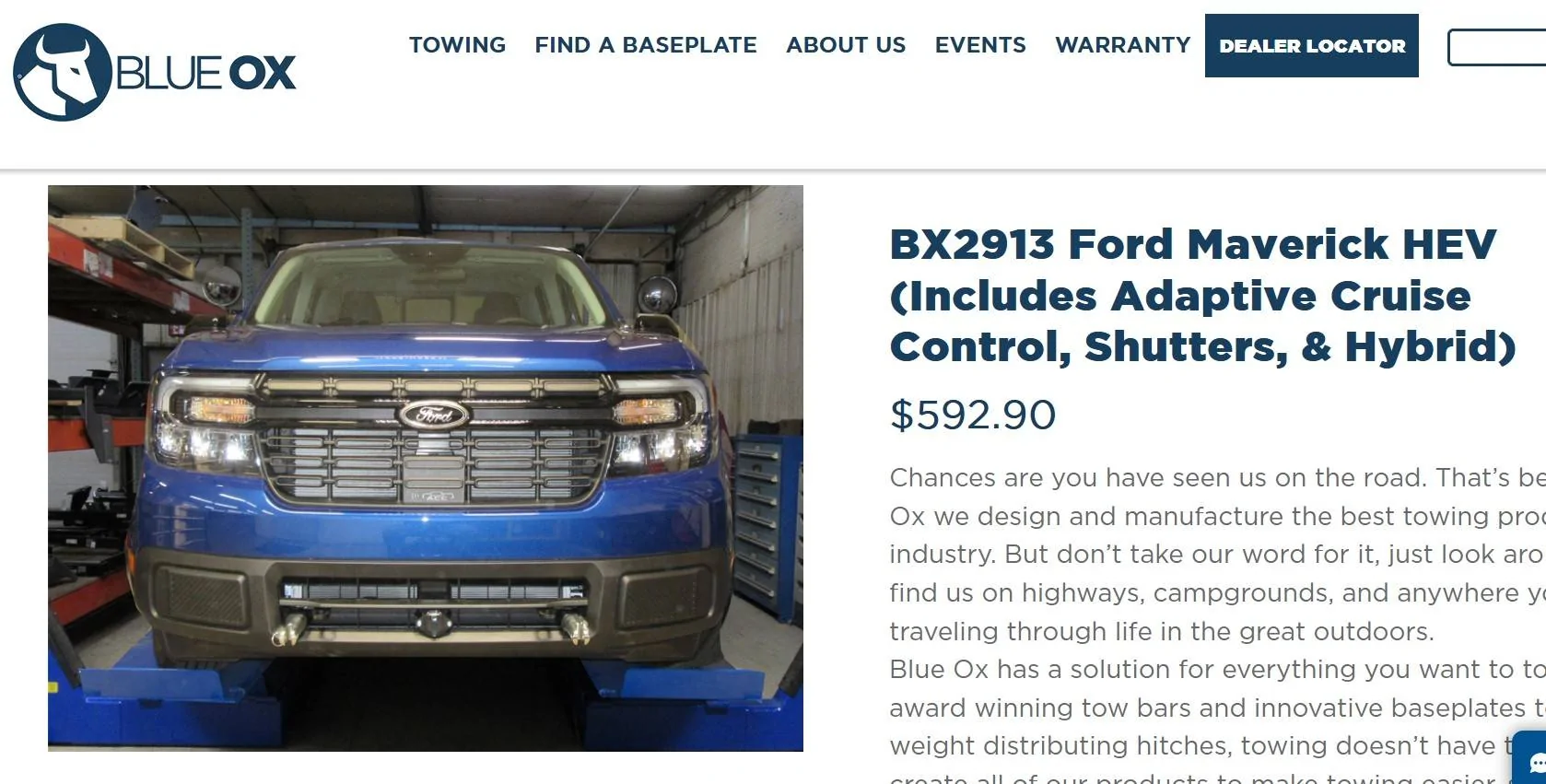

To update this thread, Blue Ox has quietly modified its 2022-2024 baseplate to include a bolted on center crossbar, after multiple failures which they reportedly did not accept responsibility for. I think Blue Ox might have a baseplate for a 2025, but I would never use any more of their products after their treatment of the folks with failures on the earlier 2022-2024 vrsions without the crossbar... that they seem to have finally admitted was necessary.

They also now seem to have a 2nd (new) design, that has the attachment points moved inward.
https://blueox.s3.amazonaws.com/wp-content/uploads/2024/11/18120051/BX2913.pdf
