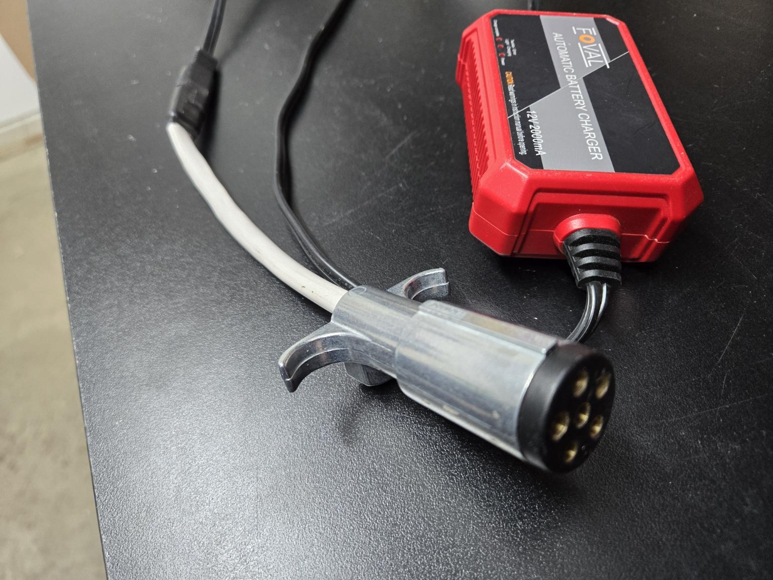

Since our Mavericks head into Deep Sleep often, I decided to make use of having the 6-pin socket installed. I made a short cord for the Foval 2000MA charger to feed the battery (through the Hopkins maintainer that has a 5A fuse...so you don't want to use this with a high amperage charger). Thus I don't have to keep opening the hood and using alligator clips.

Thanks again Brad! Since I diode and fuse the charge wire I may forego the mini charger. I'm still mulling over the portable power supply.
If I have one....count 'em....ONE deep sleep problem, an AGM will be installed.

Deep sleep happens OFTEN in both our Mavericks. But never, ever have I had a problem starting either. Both have jump boxes in them, just in case. I've only used the little charger a couple of times, but my (retired) driving is pretty random.
I'm about ready for the dealer to service the 2023...but only having 3309 miles on it (plus 2622 towed), it is not driven enough to avoid Deep Sleep. I may turn off the auto updates and see if that does anything.
