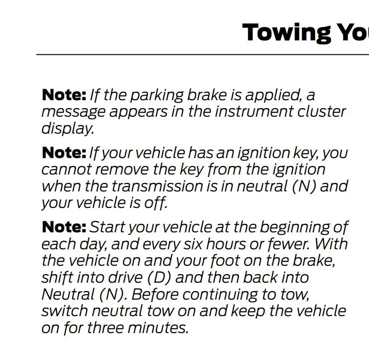

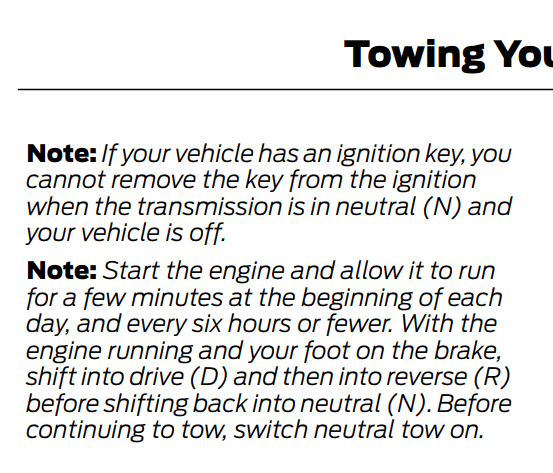

I do want to point out that there is a difference in the 2023 manual and the 2024 manual. It is found on Page 293 in each manual, but the instructions are DIFFERENT, and I've never been able to get reasoning/clarification. These instructions are relative to initial setup each day, and when you tow longer than 6 hours in a day.
The 2023 manual finishes with a Reverse to Neutral shift:
Ford Maverick Flat Tow Set Up Instructions 1718477674394-bl
The 2024 Manual does not have you shifting into Reverse at all in the process:
Ford Maverick Flat Tow Set Up Instructions 1718477829083-q2
From my days towing a 1998 Honda CR-V, I remember that the instructions were that the last shift when preparing for towing was from Drive to Neutral, with a warning to NEVER finish the process with a Reverse to Neutral switch. Very different transmission, of course, but the difference in manuals caught my eye.
