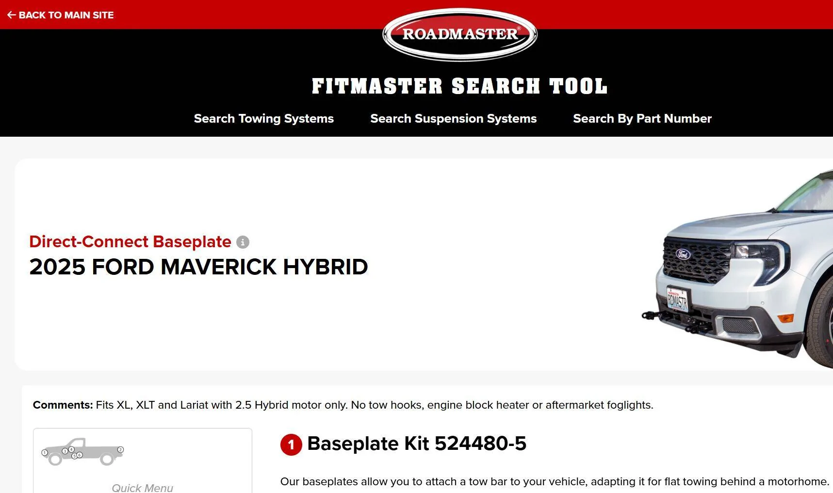

I ordered the Blue Ox base plate because Roadmaster had a problem with my engine block heater needed for Alaska. My install is scheduled for 6/25/25.
See below from Roadmaster :
Comments: Fits XL, XLT and Lariat with 2.5 Hybrid motor only. No tow hooks, engine block heater or aftermarket fog lights.

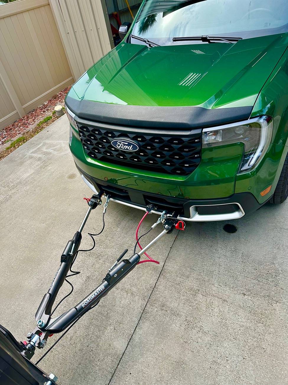

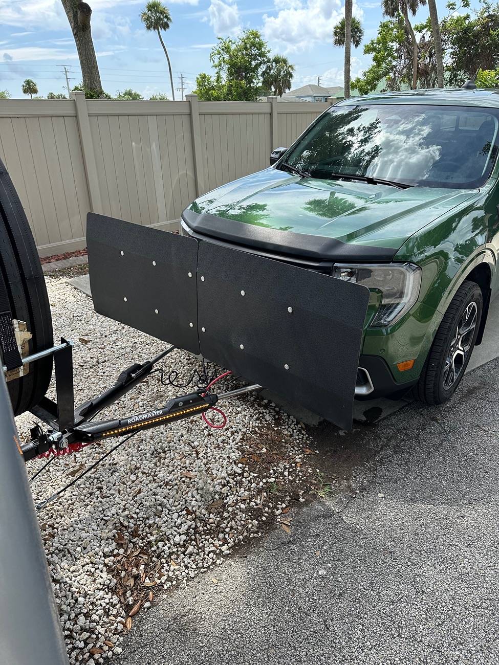

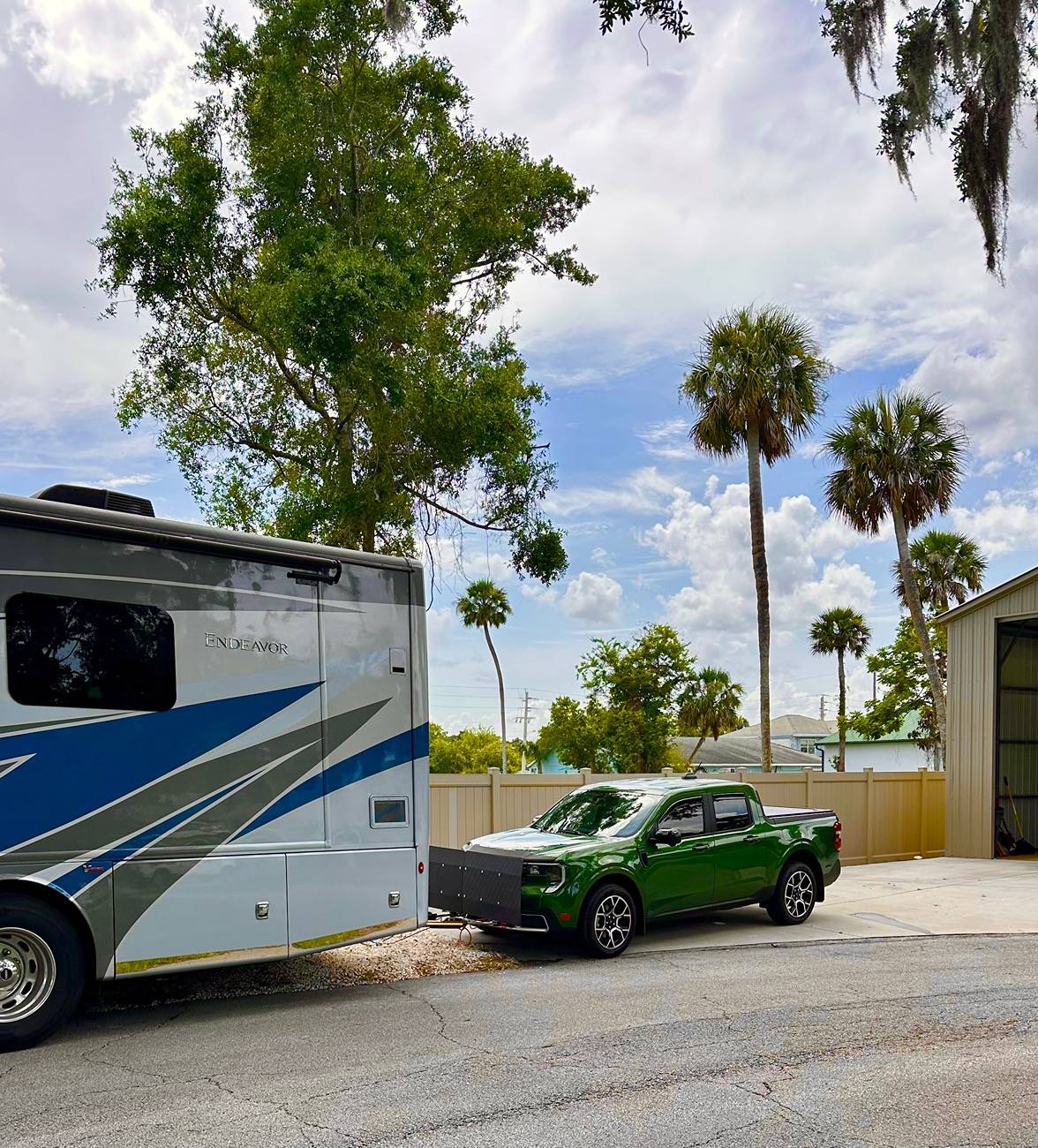

I just installed a RoadMaster Baseplate and paired it with the RoadMaster Nighthawk Tow Bar and then adapted my BlueOX Karguard onto the Nighthawk on my 2025 Maverick Lariat AWD Hybrid
Easy, Solid and Clean install - I am very happy with this set up

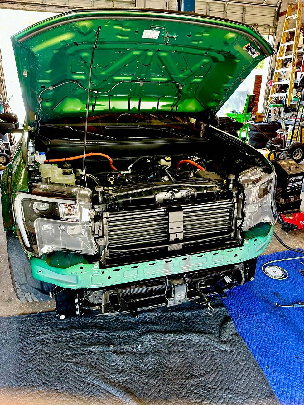

How much of the Front Shutters did you have to remove or Alter ?
Nice clean install work.

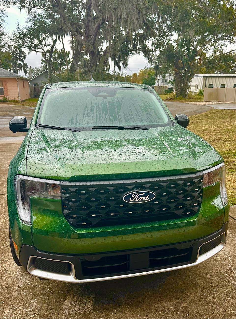

It was not very disruptive as you can see in the before and after photos the horizontal shudder remains in place I only modify the shudder vertical pieces on the very edges to make clearance for the tow adapters fixtures - the installer has done a few and we both had no concerns and after testing it works great without issue - thanks for the compliment on the look

My 2025 Maverick Lariat AWD Hybrid does not have the 4K Towing Package I have no intention to pull a trailer with it I purchased it primarily to flat tow behind my MotorCoach and could not be happier - I have a BlueOx set up for my 2004 Jeep Wrangler TJ and it works great but after the issues I saw with the prior Models of Mavericks with the wide spread BlueOx setup I decided to avoid them for this application.
thank you for the compliment on the installation although I did the installation locally I really appreciate all the support that RoadMaster provided I started the process with them before they started their engineering in early January this year
One last thing the RoadMaster Nighthawk tow bar allows you to thread everything through the towbar (safety cables, wiring harness, etc) so there is nothing hanging down I think the photo I posted was the Initial set up before I cleaned up everything so when you disconnect everything lifts out of the way with the towbar so everything is together
