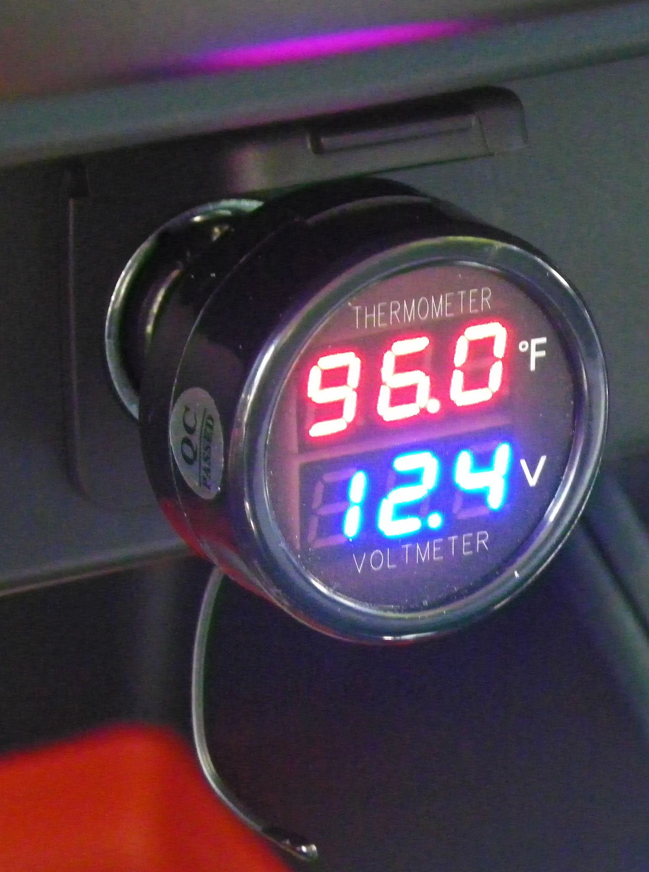

Did you have this volt meter plugged in to your other Maverick and if so did it ever indicate a low charge status?
Yes.
In the 2022 I saw voltages below 12 volts a few times.
If the voltage got to near 11.8 volts then the Deep Sleep happened soon afterwards and a message appeared on the App.
This was before I had the TSB-2060 done.
After TSB-2060 was done the battery voltage stayed above 12 volts.

I'm looking at getting one of those. Seems like a good use for that socket. At least you get a warning it seems if things start going south.

Montana
Jun 13, 2023
4,093
6,351
From eBay.
Here is a link to one like it in RED only:
Car Truck Cigarette Lighter Style Digital Thermometer Voltmeter Voltage Meter
The one I bought had options to have the display in RED and BLUE like the one I got.
Searching eBay may turn up the one I bought.
I did something like this in my previous Tacoma, but I used this:
https://www.amazon.com/Upgraded-Cha...rette+lighter+style+voltmeter,aps,166&sr=8-16
So I just replaced the 12 "cig lighter" portion all together.
