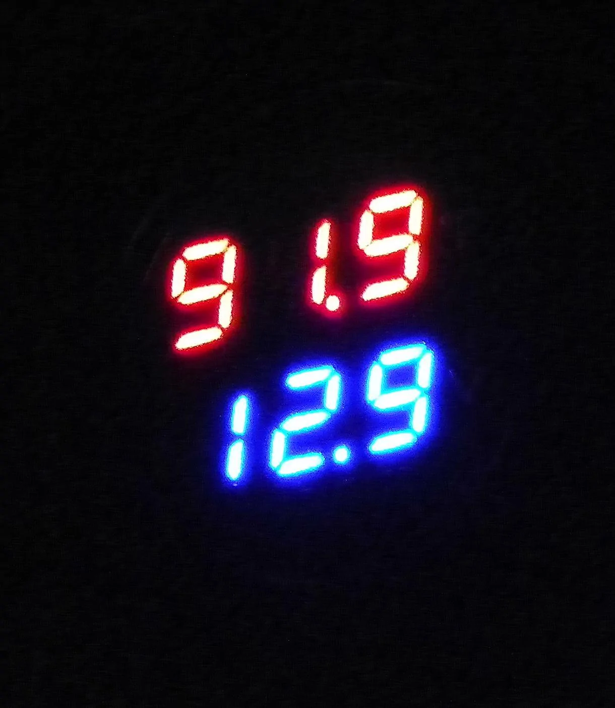

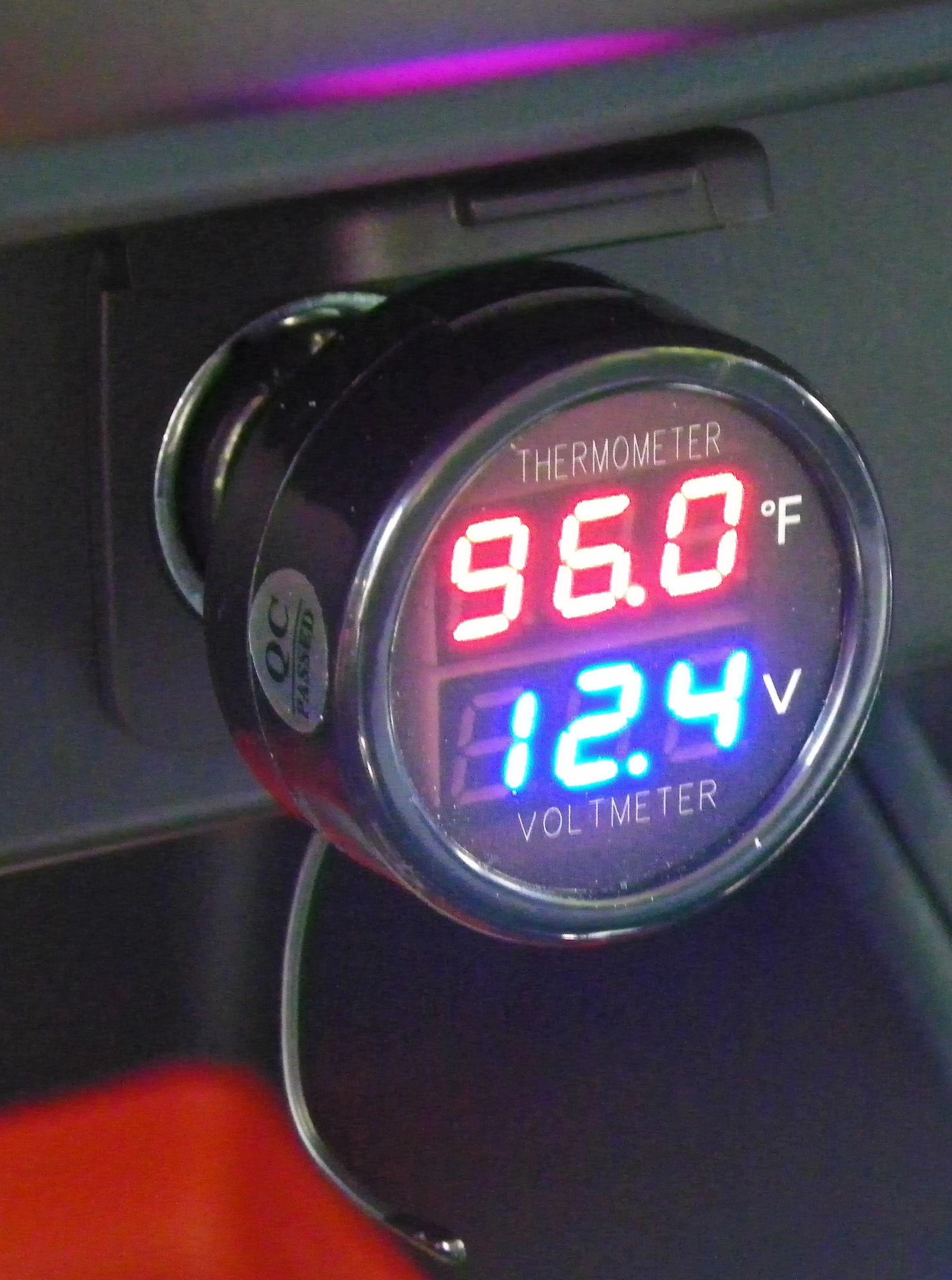

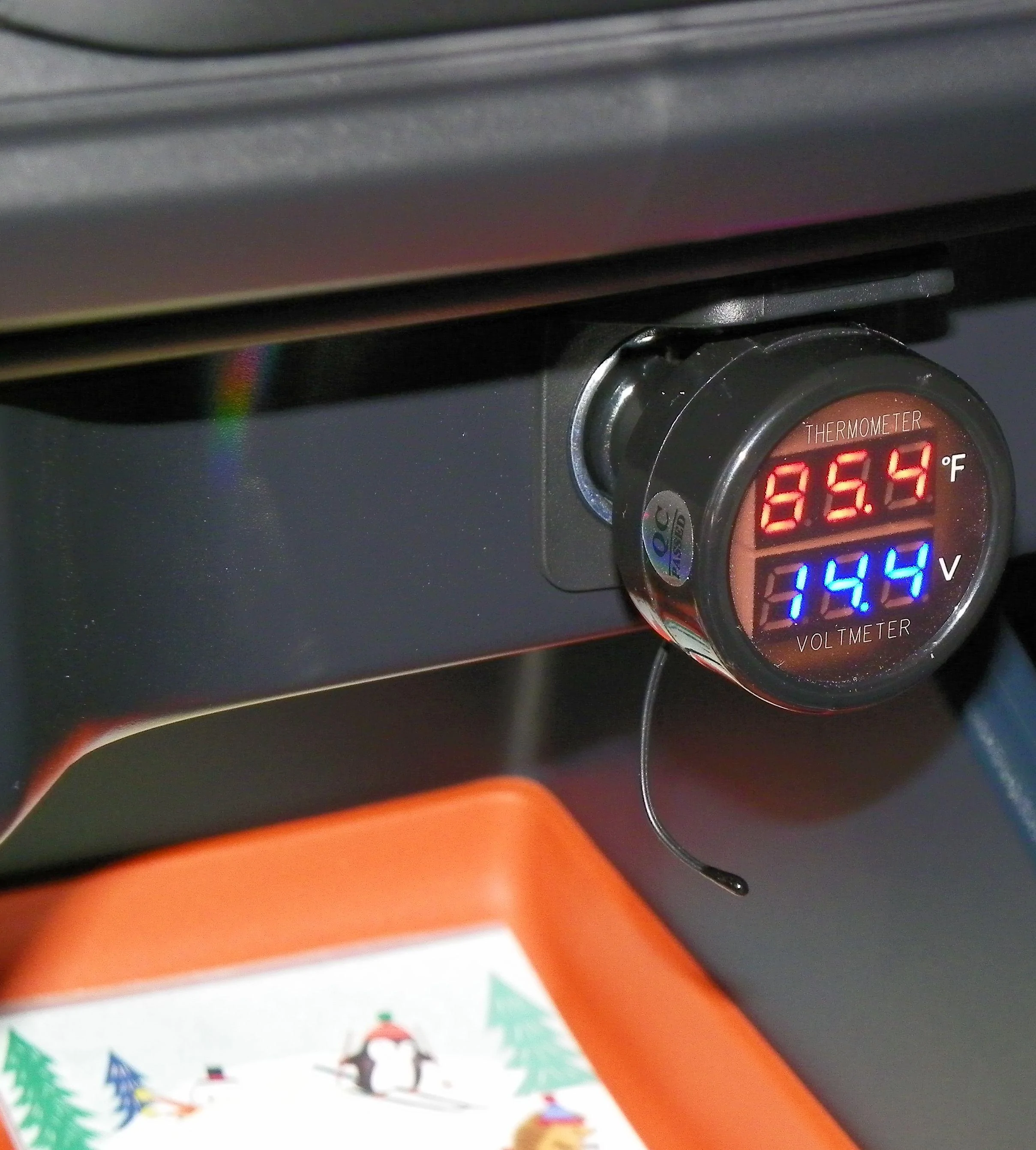

I have a 12 Volt/Temperature gauge plugged into the front 12V Power Socket and the 12 Volt battery voltage has always been between 12.4 and 12.9 volts when not being charged and shows 14.4 Volts when it is being charged.
12.4 Volts Overnight First measurement in the morning
12.9 Volts In evening after daily trips
14.4 Volts Charging

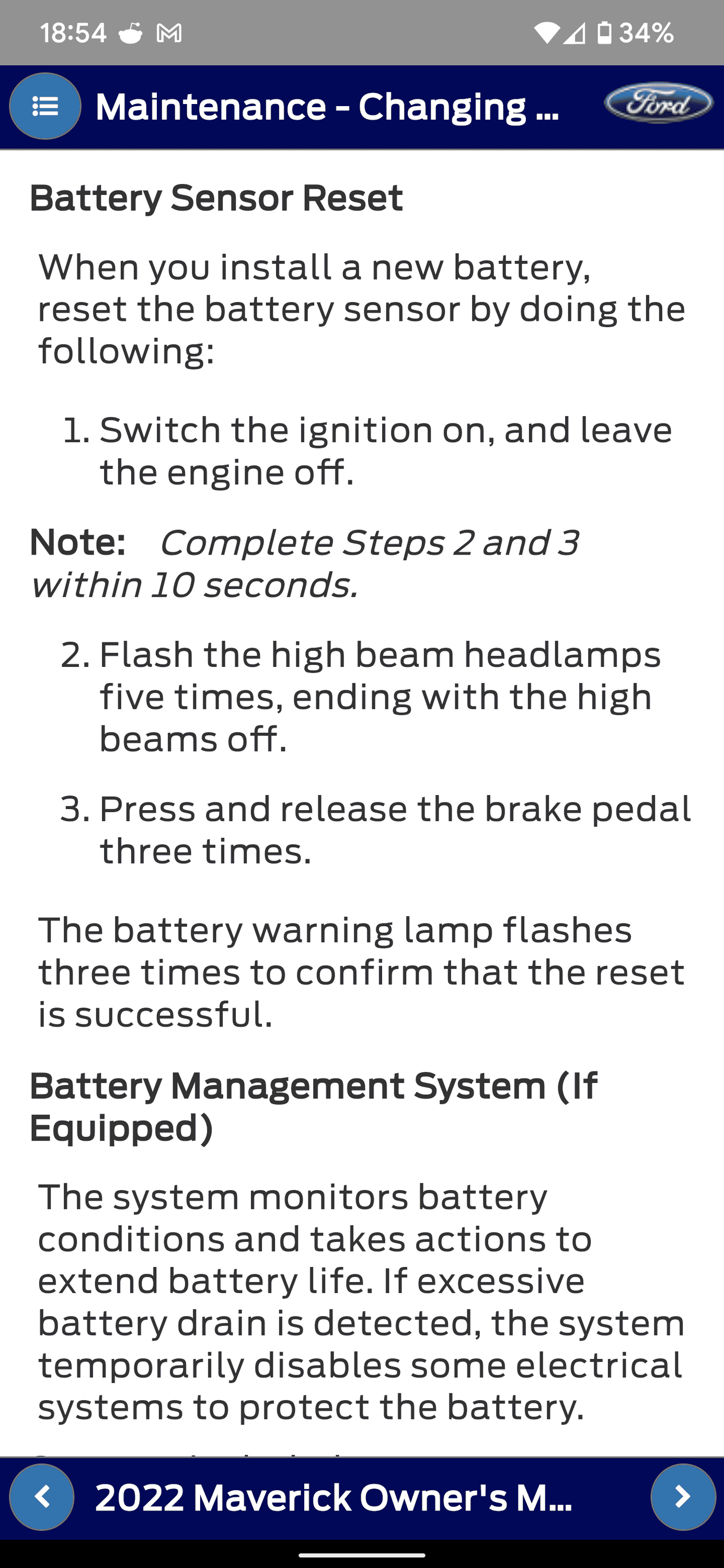

I replaced it myself with the Duralast several months ago and it's been all good. Except when I had the wiring harness and emissions reprogramming recall done Monday, it went into deep sleep the next day.
I reset my BMS and so far so good.

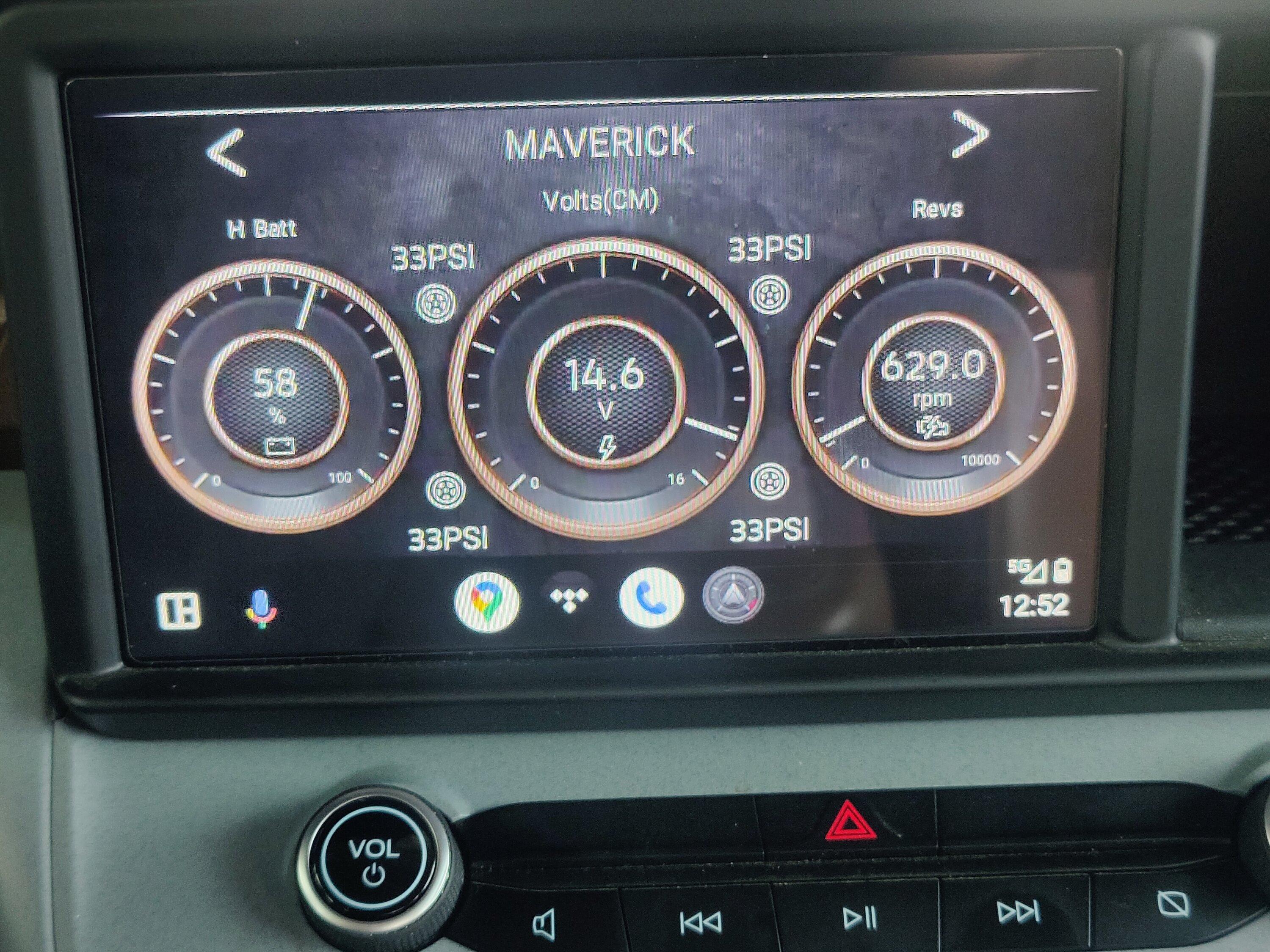

Ford Maverick Deep Sleep Poll Hybrid Owners Screenshot_20230131-185458
Android Auto torque plugin.
