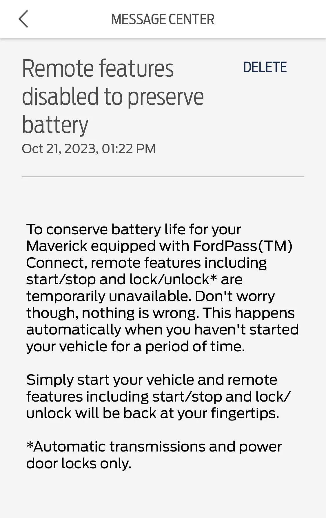

And just like that.... I got my first message.
"The period of time it sat" to trigger this:
19 Hours.
Number of times I opened car doors, unlocked doors, used the radio: 0
