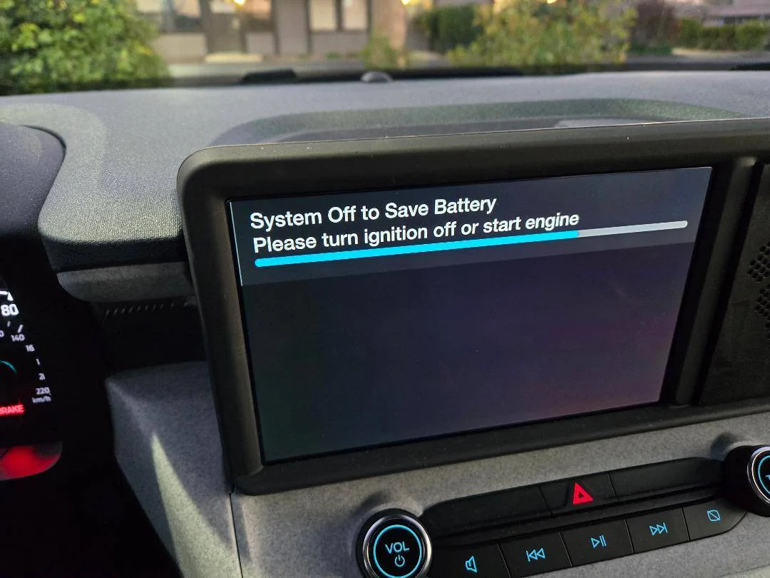

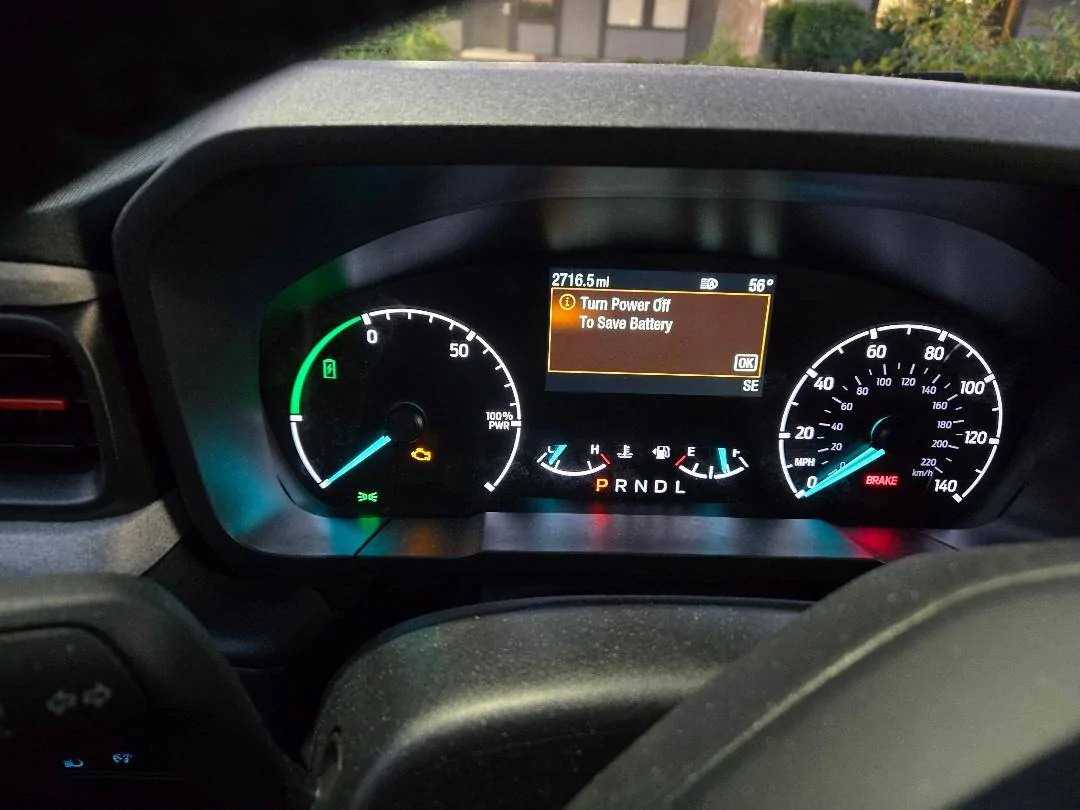

How do I upload photos. I can't seem to make the attach file button upload. I can choose the photos but nothing happens. I want to post pics of the messages on the truck.
Mark1
Sep 21, 2024
401
305
2024 Maverick XLT
Here are the 2 of the many photos, among others that I am advised to ignore. Like Cheech and Chong once said. Hey man what is this? Smell it. Smells like shit. Touch it. Feels like shit. Taste it. Taste like shit. Oh....must be shit. So own a vehicle that is not reliable or user friendly.
