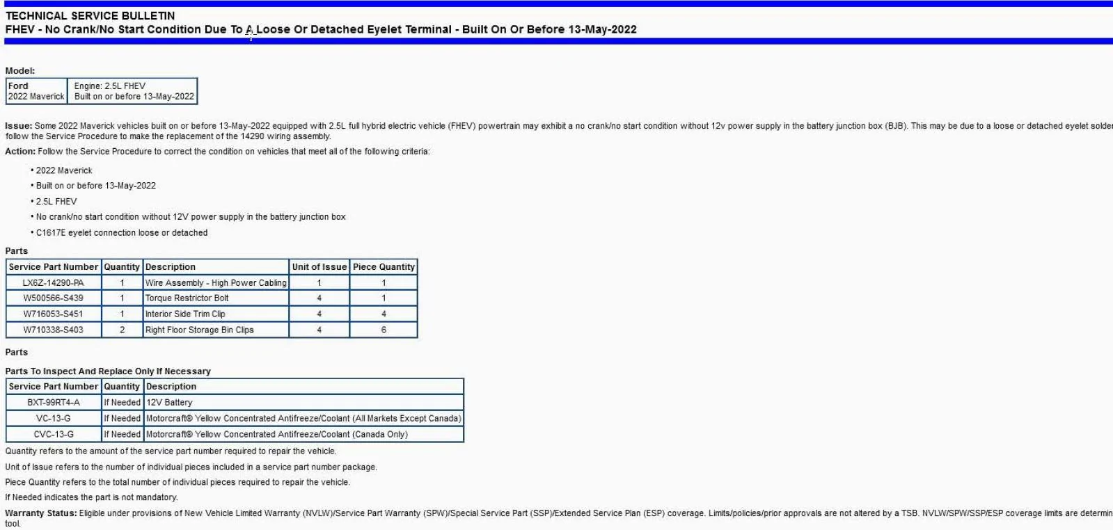

The dealership said that since this problem has been addressed in a Ford TSB, they are obligated to follow the instructions in the TSB to perform the repair. The wiring harness is to be replaced per the TSB.
Dealership near me has replaced the connectors on approx 7 instead of waiting for the harness. This was done before the TSB. Perhaps they are replacing the entire harness now, not an easy job.

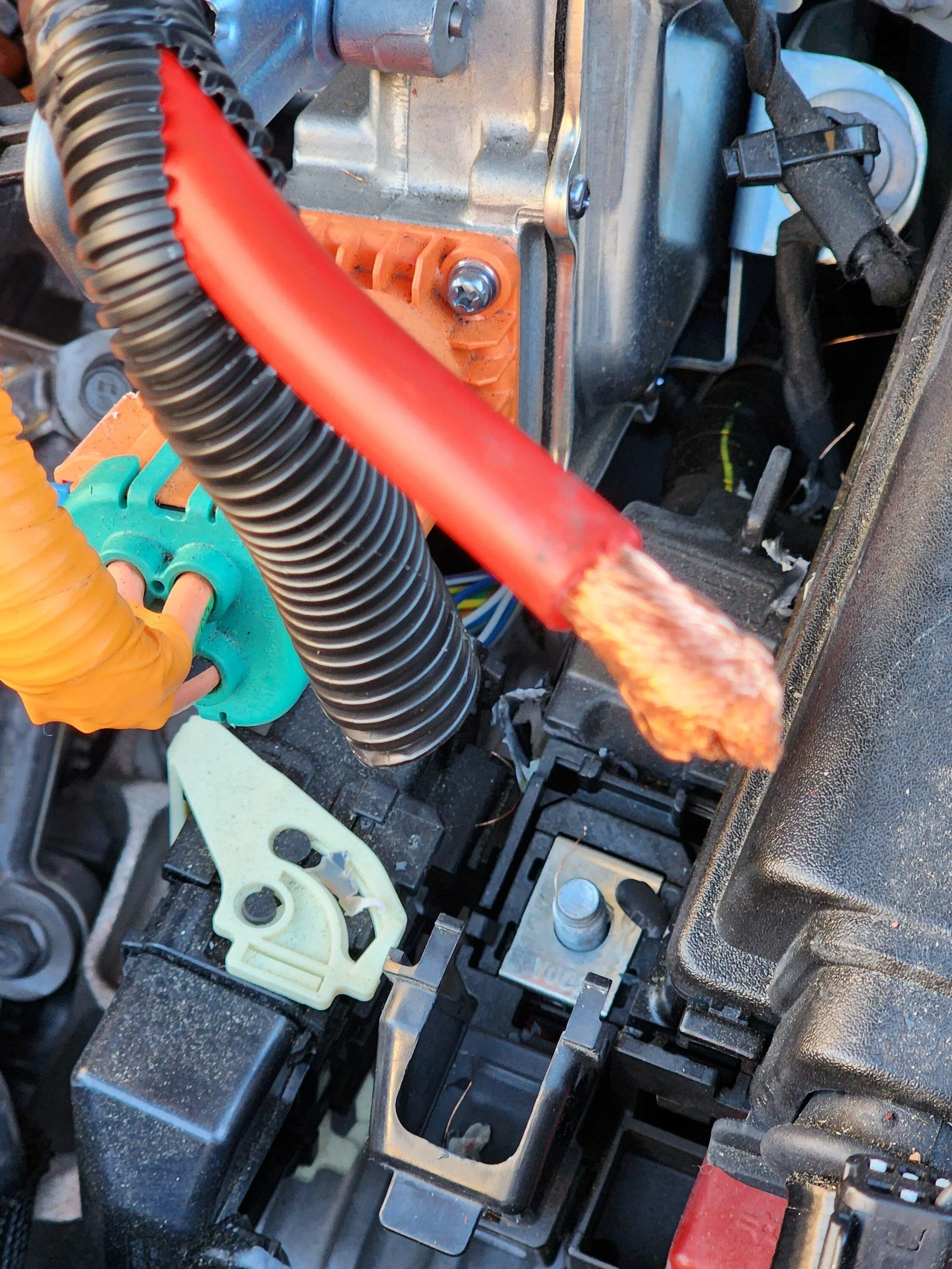

Hello,
I've joined the dead Maverick club, thanks for the invite.
Wire is copper stranded. Appears to be soldered at the very end of the connector, i.e. cold solder joint.
Replaced with new AL/CU crimp connector. Now I need to reset check engine indicator.
Don't suppose you happened to have any of the cable leftover you could shoot a picture of to corroborate it was copper core? There was a lot of handwringing over the cable potentially being aluminum and concerns about galvanic corrosion with dealers installing copper lugs as replacement. One member that replaced it themselves said there's was aluminum.
A picture would be interesting but without an analysis of it would mean little. I would certainly expect with a ten year hybrid warranty it should be a cupronickel, cupronickel coated aluminum alloy or cupronickel coated copper wire. Particularly with the type of solder joint which appears appears to be failing. How about someone fetches one off a wrecked maverick and has it tested? I expect a manufacturing error has been discovered and has been corrected so it would be best to only test one which has failed.
Well the picture certainly appears to be copper.
