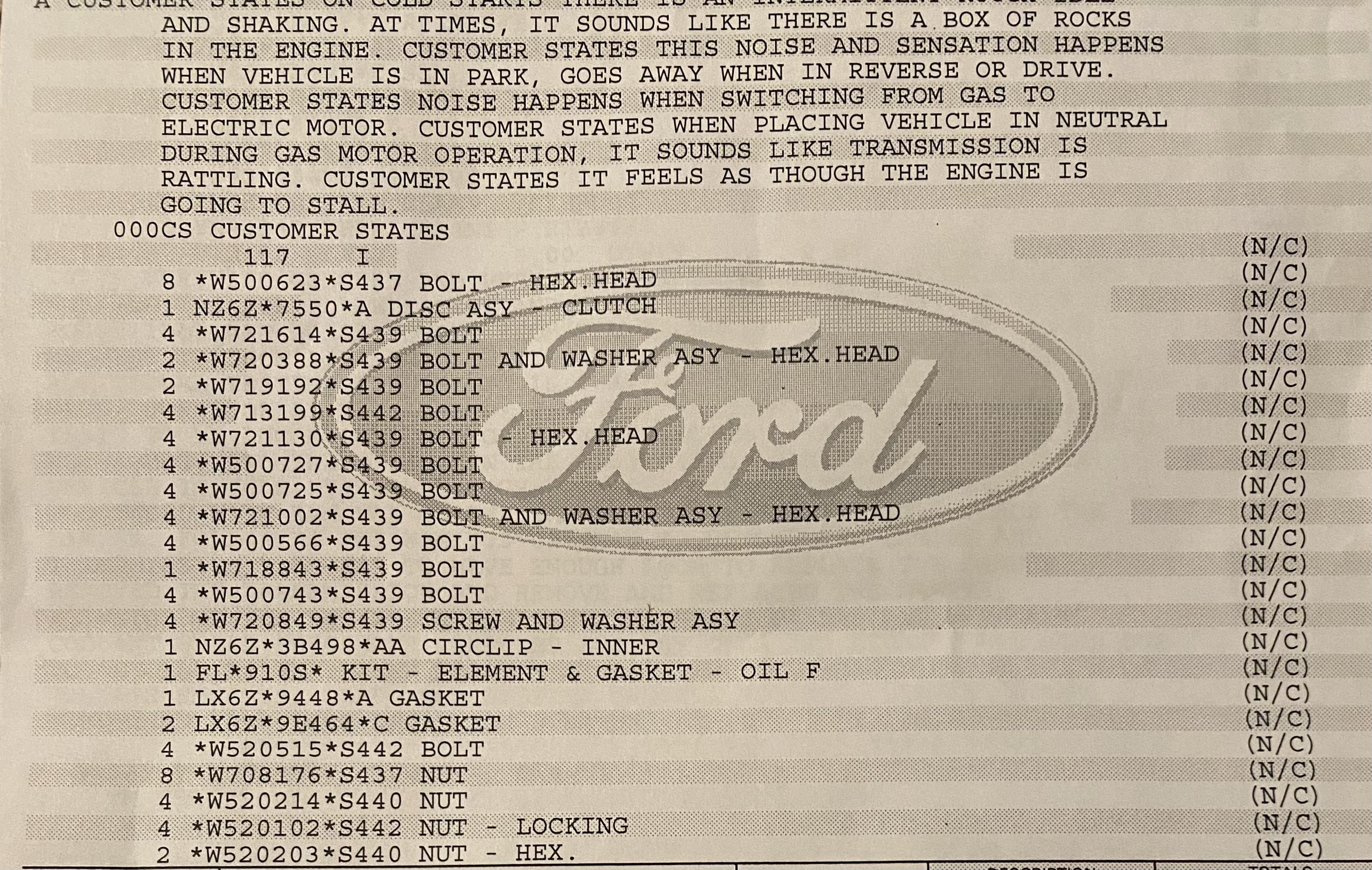

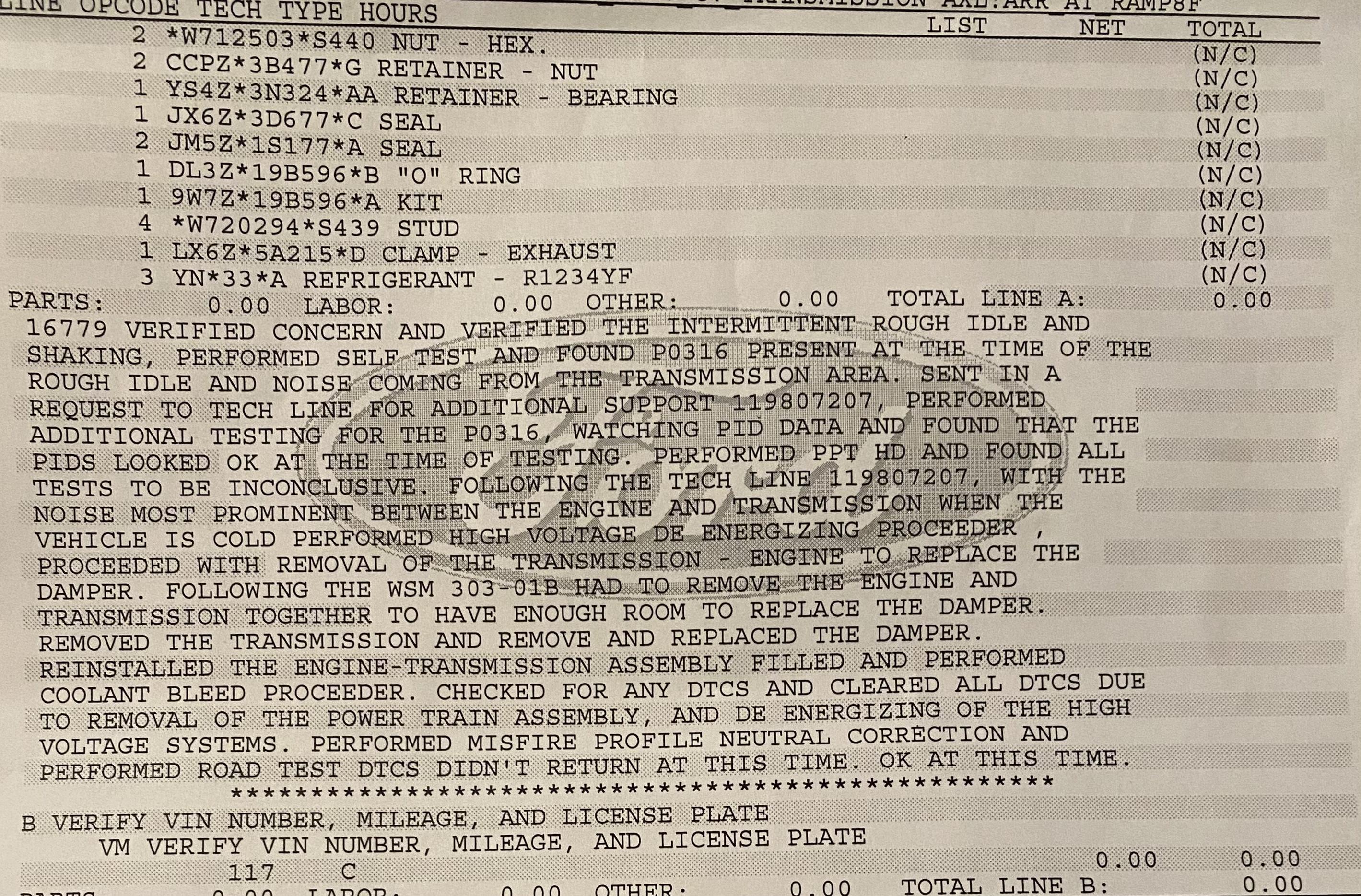

Received the maverick yesterday. I’ve included the work order in this post to help guide people and their dealers. It’s too soon to tell if this fixed the issue but I’ll keep this post updated with my findings. The fix involved removing the engine and transmission to gain access to the damper. The damper was replaced with a new one. It seems they also had to replace the engine coolant and completely discharge the high voltage battery. I’ll be keeping an eye on my high voltage battery because they said they ran into a “problem” getting that to charge back up to 100%. I honestly think they expected it to charge a lot faster than it does when in reality it takes a bit for that to happen while driving and braking. I am cautiously optimistic about this fix. It has worked for others with the same issue but this is their 3rd attempt to fix mine. Im also a little nervous about such an invasive repair in such a new vehicle. I definitely won’t be trying to fix this issue again if this doesn’t work and it’s going to be hard to not trade it in when I get a chance to get a 2024 Tacoma. We will see what happens. I also had the airbag recall done while it was there.

De-energizing is not the same as a "complete discharge". There is no reason to discharge the HV battery. They just completely disconnected the HV battery from the engine/eCVT so that it was safe to work on. At ~250 volts, it could cause death so you don't want it possibly energied while working around it.

Good catch. Yes I assumed that is why they did it.

Yeah, if they pulled the engine and transmission, they would have to refill the coolant system - at least that side of it... The battery / exhaust side should have remained intact and not needed refilling.
Not surprising they could not charge the HVB to 100%... It's not meant to be charged that high. Batteries kept charged between 20-80% last a LOT longer than if you fully charge and fully discharge them... As a general rule, the Maverick hybrid never charges the battery above ±70% state of charge in normal usage. The one known exception is when using engine braking on very long downhill sections, where it might go a bit higher.
