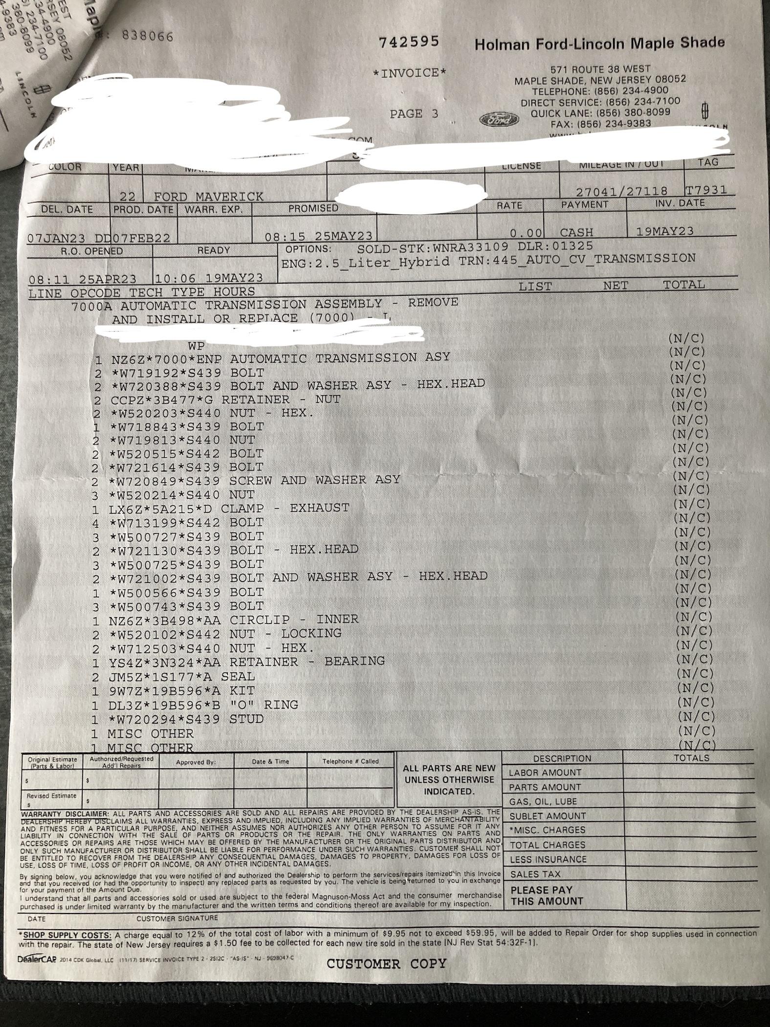

so LTIS unit means - they replaced your transmission?
does LTIS mean you received a lightly used replacement trans?
I am not sure…
I am uncertain if they replaced the whole unit, or if they replaced only a piece of the transmission. I will ask.
I checked my invoice, and it indicates that the whole automatic transmission assembly was replaced. Here is a picture for your reference:
