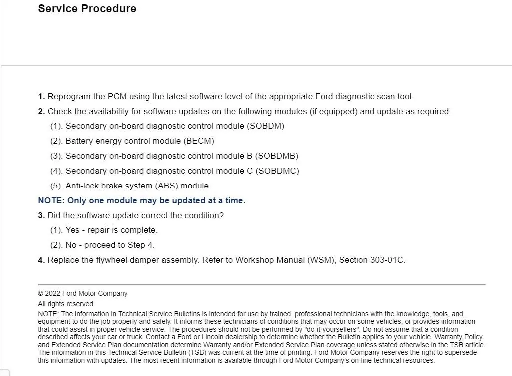

I had the issue.
Thought this was a hybrid thing?
But not sure.
I had the engine damper replaced.
Took 5 weeks to get all the parts in.
They gave a loner car (not a truck) for 5 weeks but at least I could get around.
The noise isn't loud enough yet to be picked up by my camera, but if I pay attention I can hear it and sometimes can feel it under my feet if I put it in the correct spot on the floormat, but it does make the exact same clicking/ticking/rattling pattern.
I thought it was a hybrid thing too since all the videos and problems are coming from hybrids. Now my EB is making that noise too.
So for you it was the engine damper? I thought the engine damper just holds the engine in place while damping the vibration/movement, weird. Has the sound came back?
