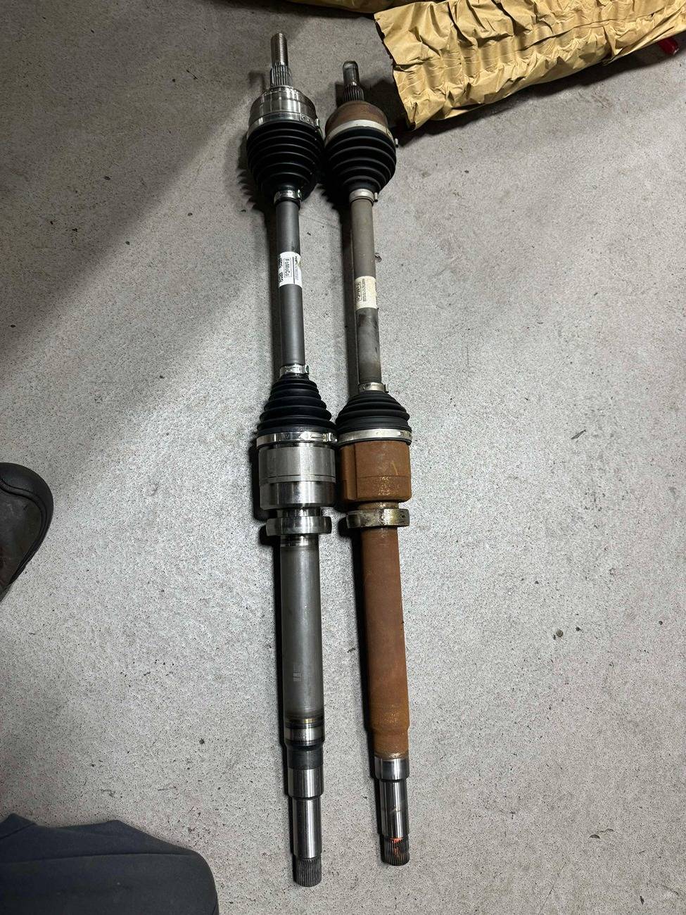

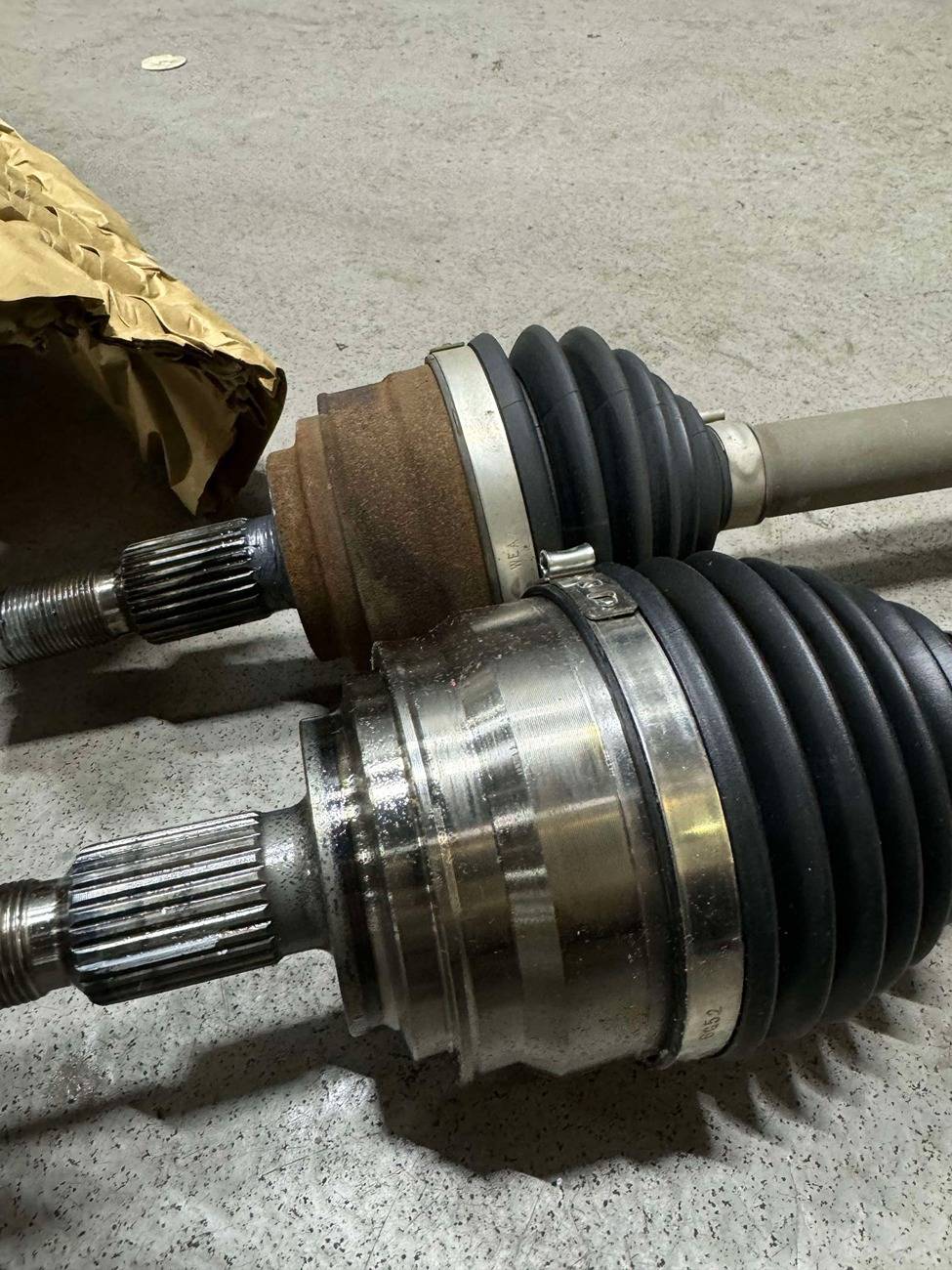

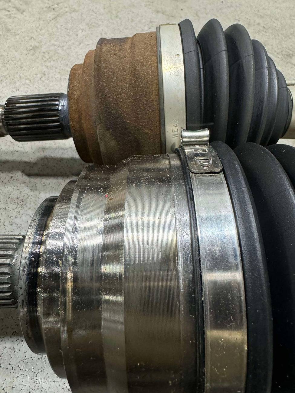

Yes, we actually got a set in for a customers truck this week. Side by side you can tell they've changed the design at the outer cv joint. The housing is slightly different, looks to be beefed up a bit.
Reminds me of the images I've seen comparing Tremor shafts to the standard shaft. Maybe they took Tremor design and fit it to standard Maverick applications.
I would assume they've probably adapted the new design off of previous ones to save development time.

I count more ridges in the boots and slightly larger casing. As of their angles were maxed out initially (boot ridges)

For everyone asking, they said they are the upgraded CV axles they put on. Here is the paperwork for reference.

Now that we've established that the CV axle design has indeed been improved, the question now is by how much? Is it gonna last 10k miles longer than the original design on average, 40k, 100k? That's the question that's yet to be seen.
Here's hoping we get a full on dissection of them to discuss the improvements moving forward. Good on Ford for addressing this, a lot of brands don't.
