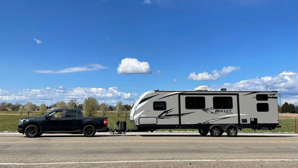

You mean like this? Hahahaha!

👌=How many seconds more does it take at what % power to get to say 40mph than your truck by itself. I am not saying it won't do it in spades but good possibility they know it was done. Also tilt sensors can be used to calc approximate load including tongue weight at average for that vin # configuration.

That's not my truck & trailer, it was from the weight distributing hitch thread a few days ago. My Alto Blue 4K Mav has not been built yet.
