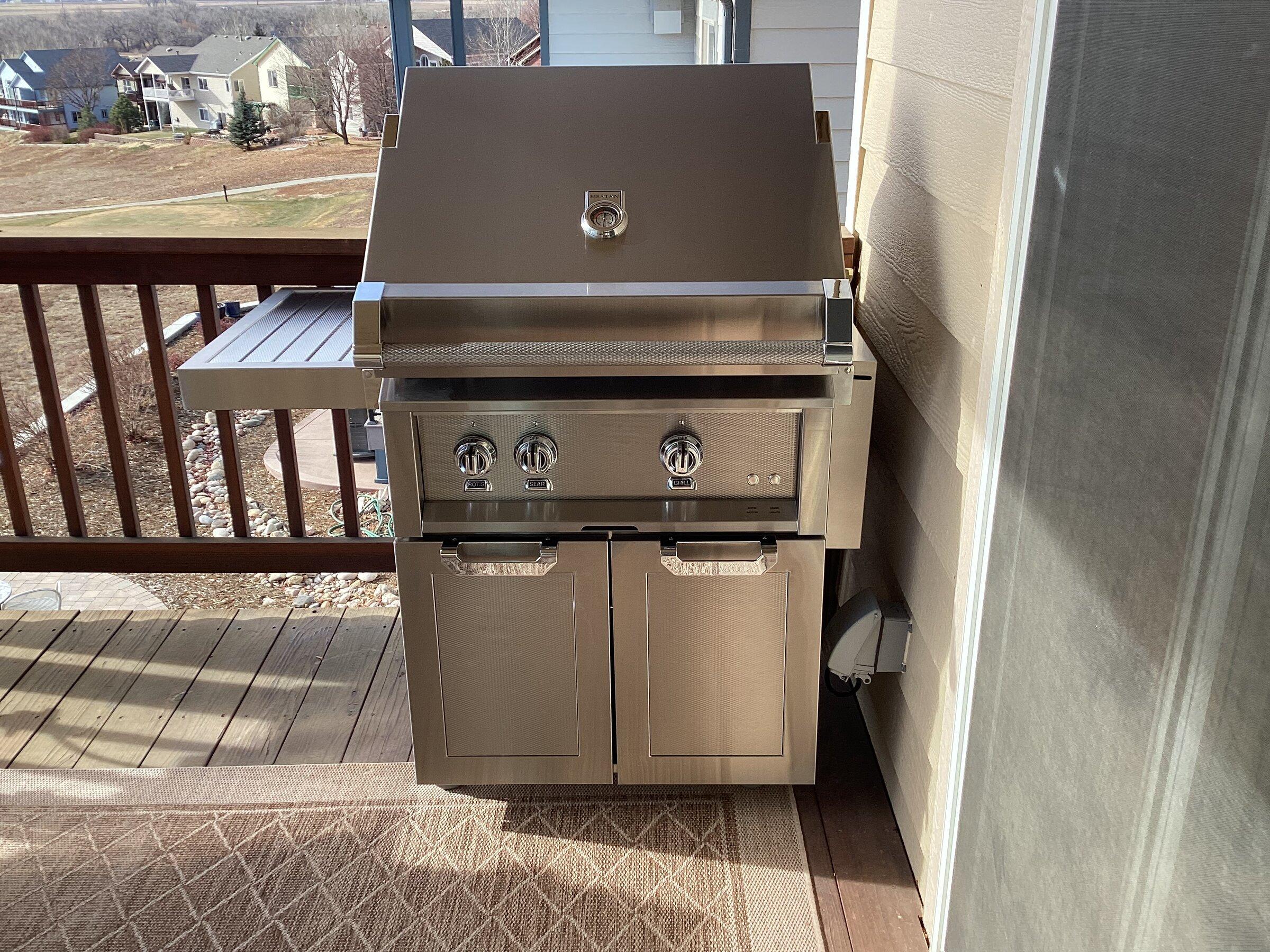

possibly another household item such as a grill….if you add to a high heat appliance make sure you get ceramic rated for 1600 plus degrees.Ya, try your hand on your wife's car first.
