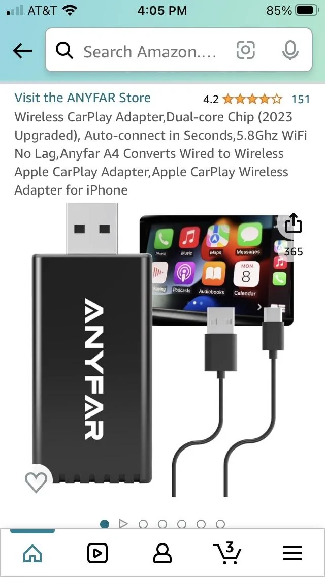

Mine is perfect and I am using an iPhone 7 I bought on Swappa for 99 bucks Mint with 98% battery. Sometimes things can be made too complicated needlessly just for the sake of making them. I wonder if this is the case with the newer iPhones. iOS 15.xx seems to run CarPlay very well.
Once in a while Google Maps will be blank but this also happens on wife's Jeep with U-Connect as well.
I’m using a 7 also and with CarPlay adapter see pic works great
Thanx!! The other day I got a message from Ford through the Pass App that the app will soon require iOS 16 to operate, thus no longer working on the 7 as 15.xx is the best it will ever get.
Browsing for used second or third generation SE on Swappa. Gen 3's can be had for less than 200 bucks in great condition with good battery and they have the A15 processor which should give updates for a while.
Yes thanks for the info I’m overdue for a new phone 📱
