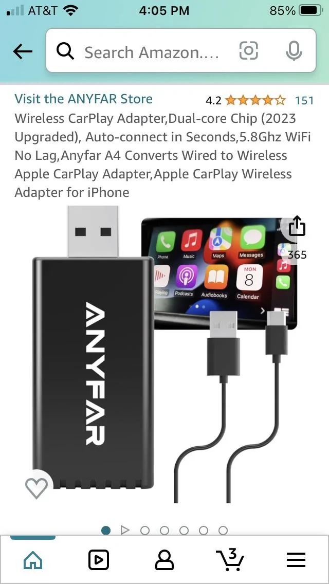

this cured all my issues with CarPlay
Ford Maverick Carplay issues F52C9BF1-BA18-4761-BA77-C23FD23E78DC
You’re right, I need to give these another look.
If you have that plugged into the usb port, and then plug the phone into the other usb port to charge, does the phone CarPlay supersede the wireless unit, or does it only charge the phone?

i have only used Bluetooth but direct wire to USB port will probably knock out Bluetooth. I’ll try both myself and update

So far still works just a little slower to hookup so turn off Bluetooth and plug it in and you charge and listen to your music 👍

USB trumps Bluetooth

I think the cords are a big issue here whether it be when you connect your phone directly with a cord or if you use a wireless adapter that has a cord.I use a cordless CarPlay adapter that plugs directly in to the usb port. I say avoid cords and plug straight in.
As Ozarkbeard said above get an adapter for the 12 volt outlet as your phone charging point. That’s where you should charge your phone if needed. You can then charge and be connected via Bluetooth simultaneously. Also if you go the wireless CarPlay route unpair your phone from the truck because you are going to have the adapter paired to the truck. The phone connects through the adapter.

the anyfar adapter took all the issues away,phone and CarPlay work great!

I plugged in and left Bluetooth on it still worked but much slower so it charges and plays
You plug into the cigarette charger port right?
