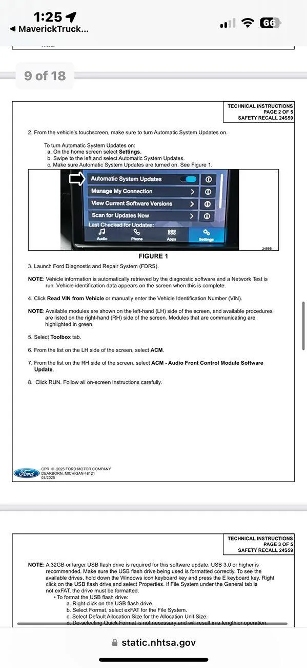

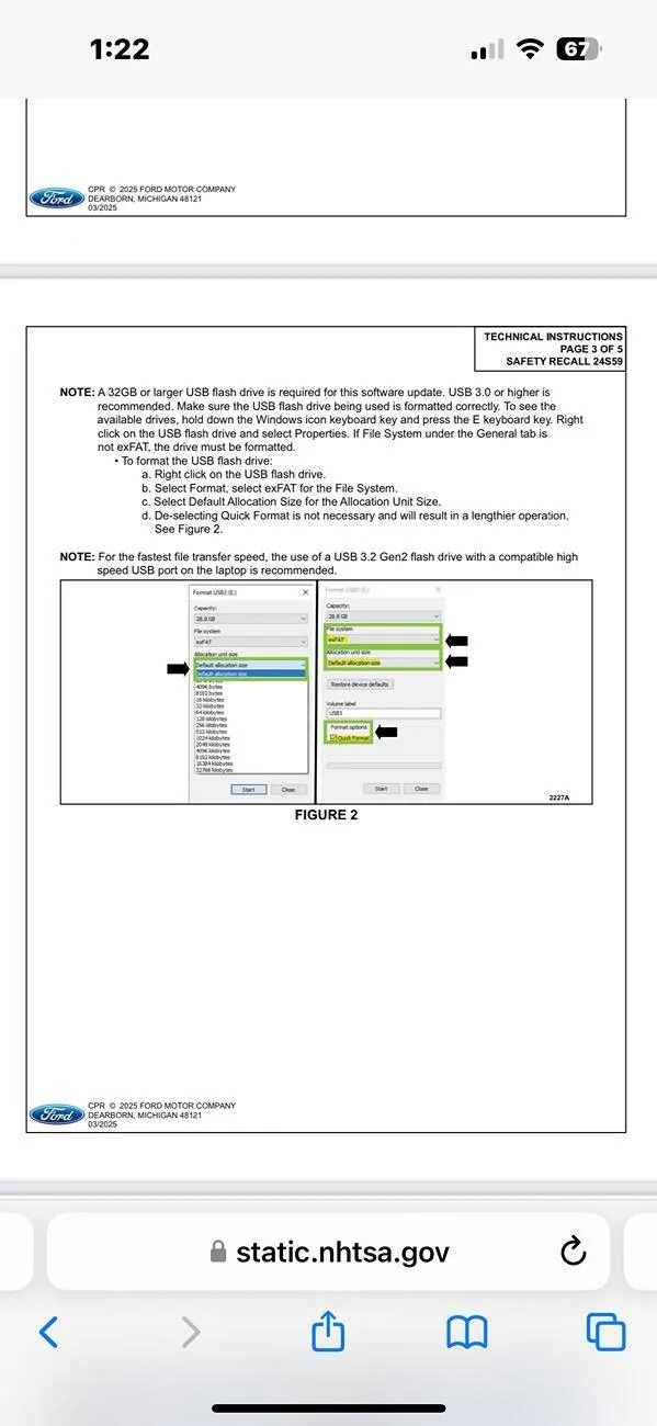

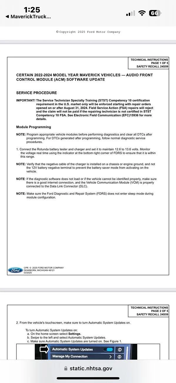

Is what they need to finish the update.
Ford Maverick Backup camera fix Recall is out now IMG_0630
