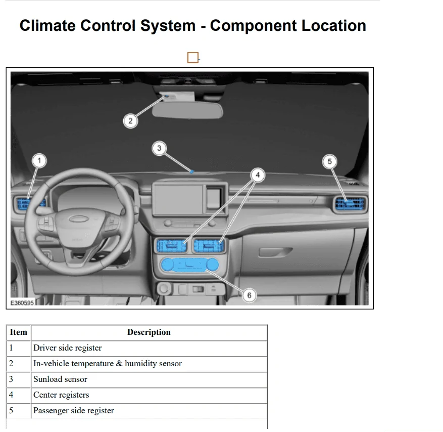

Where is the temp gage for the thermostat in the car? Is it on the dashboard?
Sorry to hear it's still giving you issues but it sounds like a trip to the dealer might be in your future.
Here is what I was able to find as far as temperature sensor location is concerned. I think #2 is what you are asking about. #3 might also play are role in regulating cabin temperature.
Ford Maverick Automatic climate control climate control
Here is what I was able to find as far temperature sensor location is concerned. I think #2 is what you are asking abiut.
Ohh that makes sense as to where the sensor is. Thanks!

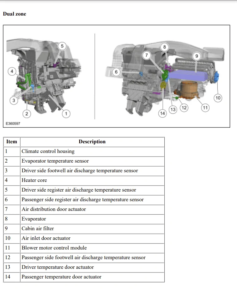

Absolutely! I don't know how far down the rabbit hole you want to go with this but I did a little more digging did turn this up as well.
Looks like there might be additional temp sensors located in the footwells and registers.
Ford Maverick Automatic climate control climate control1

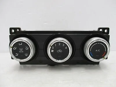

I really miss the fully manual controls in my old Subaru. So much simpler and user-controllable.
I mean you can do all of this with your Maverick,.....
No you can't.
Example: I sometimes find myself on a dirt road and suddenly behind another vehicle stirring up dust. I would like to turn the system on RECIRC. and turn off the blower. If you do that in this vehicle, the system will decide the fan and compressor should start running.
That is not full manual mode - it is software making decisions I'd rather make myself.
