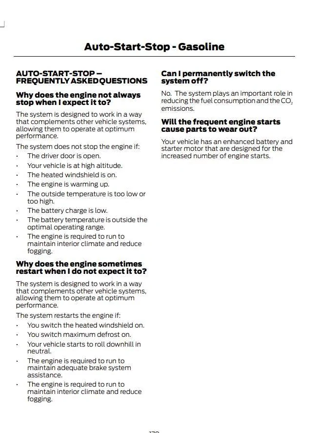

From the manual.......
Ford Maverick '24 XLT AUTO STOP not working auto stop start faq
