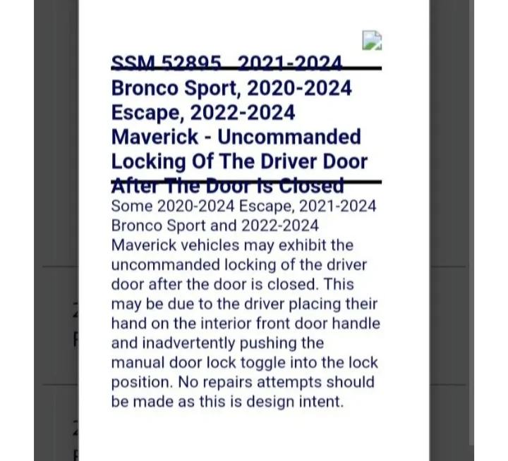

It's doing it again! I notice that, unless I push that top button in before shutting the door it locks. The other 3 doors don't do this. Grrr!

🤔 Do you mean like, pushing open the unlocked door, with your hand accidentally locking it. and then having to use the unlock button before you close it? Like shown in the video.👇🏼

You know what Ron White said about fixing human characteristics? There is one you can't fix. How many times do you need to demonstrate what is happening?
This video is exactly what Jeff says he's doing. Which shows how he's locking the door when he pushes it open. Maybe, if he watches the video, he'll realize what's happening.
Jeff
So pretty quick video to take then.
Your director Glenn has described the needed shot.
I'm not sure who our lighting crew is - but your camera may suffice.
Please don't request a stunt double.
But after the video you may want one.
