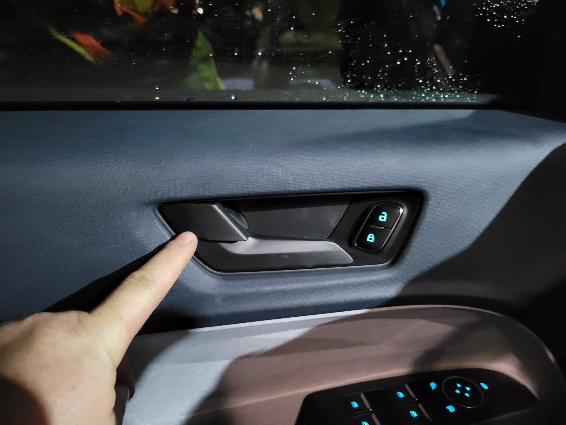

Happened to me a few times now. At my work, I drive around the yard from place to place, having to get in and out a few times sometimes. When I pull the latch to open the driver's door, sometimes my hand hits the manual lock located at the top where it's hinged. It's apparently just enough to lock it. Thankfully, when I put it in park, the doors unlock. BUT you can actually lock yourself out manually.
Didn't know if anyone else experienced this?
Yes, that has happened to me a few times as well. I still can't figure out exactly how it's happening, sounds strange I know but the lock seems to be in the same position. What I noticed, is that the other three doors will remain unlocked. I recommend memorizing the 4 digit key pad security #.

That happened to few of my employees what I did I change the settings on the radio screen to lock drivers door only and that did the trick but to lock all doors you have to hit the remote 2x,
