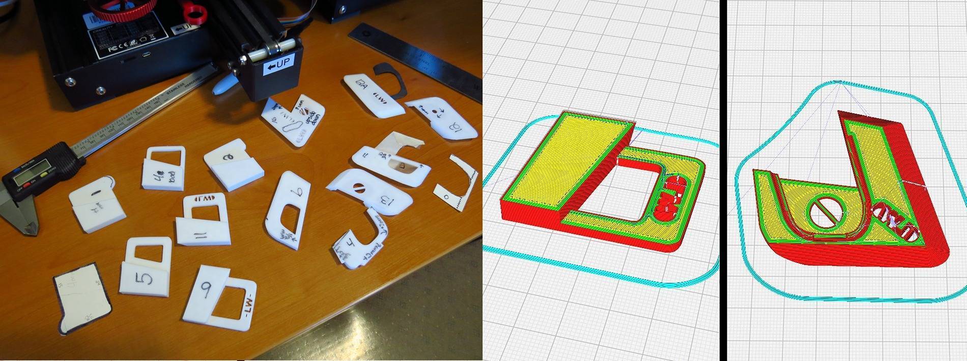

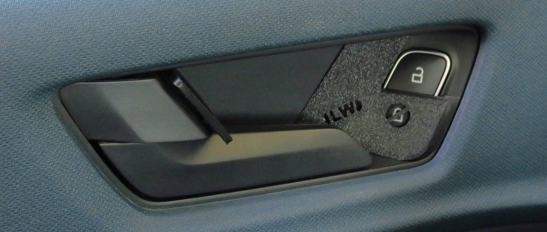

Thanks for the mention! Yeah, that thread is mine. I've had the locking happen to me more than once, and I'm pretty sure it occured 2 ways. Regardless, the accidental door locking due to the design/layout of the controls bugged me so I did something about it.
When gripping the door lever and opening the door, the side of your hand can accidentally push in the mechanical lock lever and a fingertip can accidentally press the elec lock switch. Aargh!
Ford Maverick Auto lock problems {filename}
This ended up being a good excuse to finally get familiar with 3D printing and come up with something useful. Bought the cheapest and most neglected 3D printer I could find on FB Marketplace and spent some time watching YouTube tutorials on the design software.
Measure, draw, print, fit, and repeat. Lots of trial & error involved but I ended up with a simple 2-piece solution that works well in preventing accidental pressing of the lock lever and button.
Ford Maverick Auto lock problems lock_guard_design-jpg-jpg-
Final version:
Ford Maverick Auto lock problems img_3579ab-jpg-jpg-
Read more about it here. They're available If anyone else wants a set.

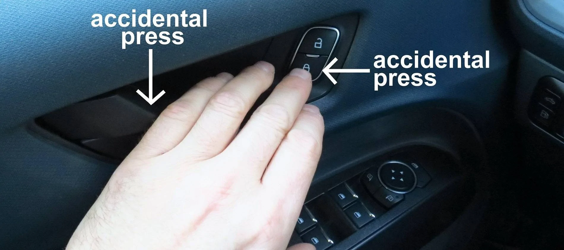

Jeff,

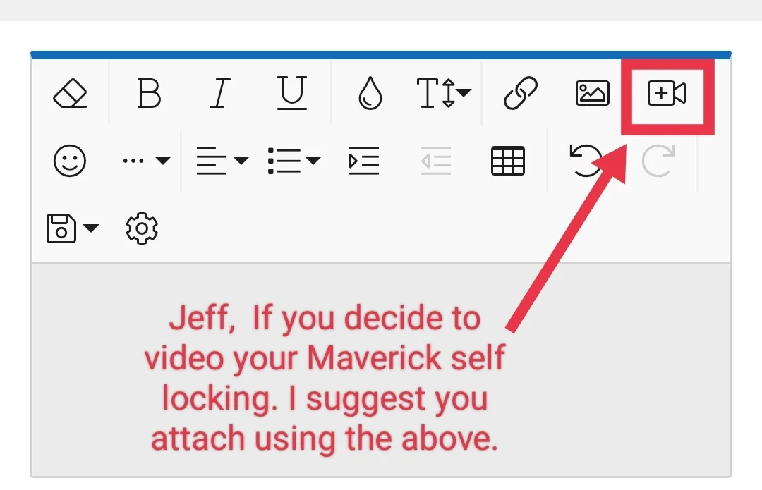

It would be helpful to all of us if you could show this happening.
Ford Maverick Auto lock problems IMG_20250913_093939

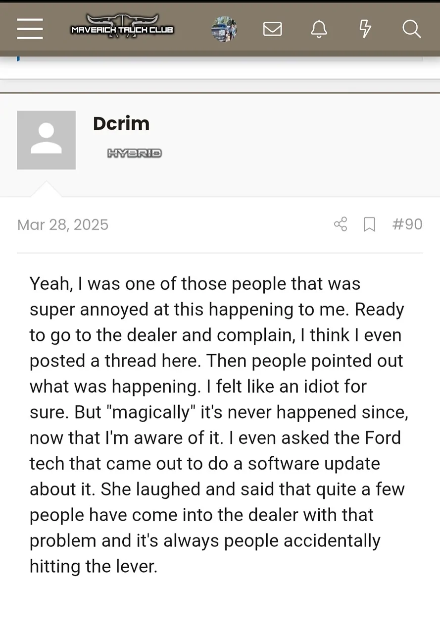

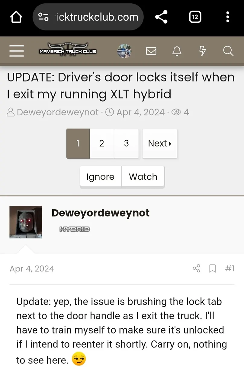

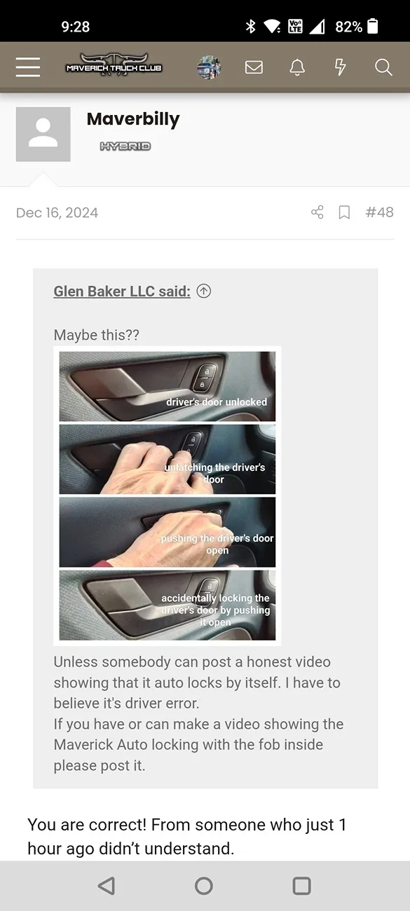

Here are some previous members who realize that they were locking the door themselves but in the beginning didn't think so.
Ford Maverick Auto lock problems IMG_20250913_093721
Ford Maverick Auto lock problems IMG_20250913_093633
Ford Maverick Auto lock problems Screenshot_2025-09-13-09-28-06-76_40deb401b9ffe8e1df2f1cc5ba480b12
Ford Maverick Auto lock problems 20250913_121358
Case closed. 😁

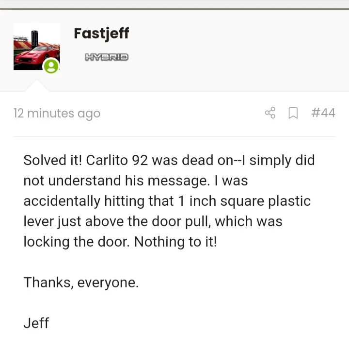

Solved it! Carlito 92 was dead on--I simply did not understand his message. I was accidentally hitting that 1 inch square plastic lever just above the door pull, which was locking the door. Nothing to it!
Thanks, everyone.

If he had mentioned the "auto lock" problem to the dealer they would have shown him this.
Ford Maverick Auto lock problems 20250913_122057
