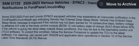

appointment Feb 6 SSM 51725 we will see
appointment was on time, no issues - now I no longer receive the message that the truck has been shut down to conserve battery. The vehicle is still dark, no interior lights, no door chime same as before; except now no notification. Truck has always started fine and continues to spring to life when you insert the key. So at this time it would seem that the notification message has been removed or altered. Time will tell if this SSM 51725 procedure was a fix
