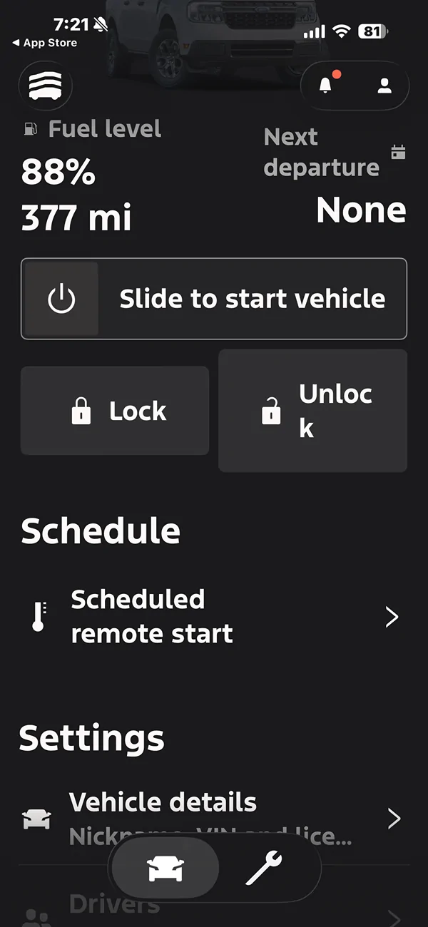

Just updated mine to see what would happen. Updated just fine except the unlock icon is goofy
