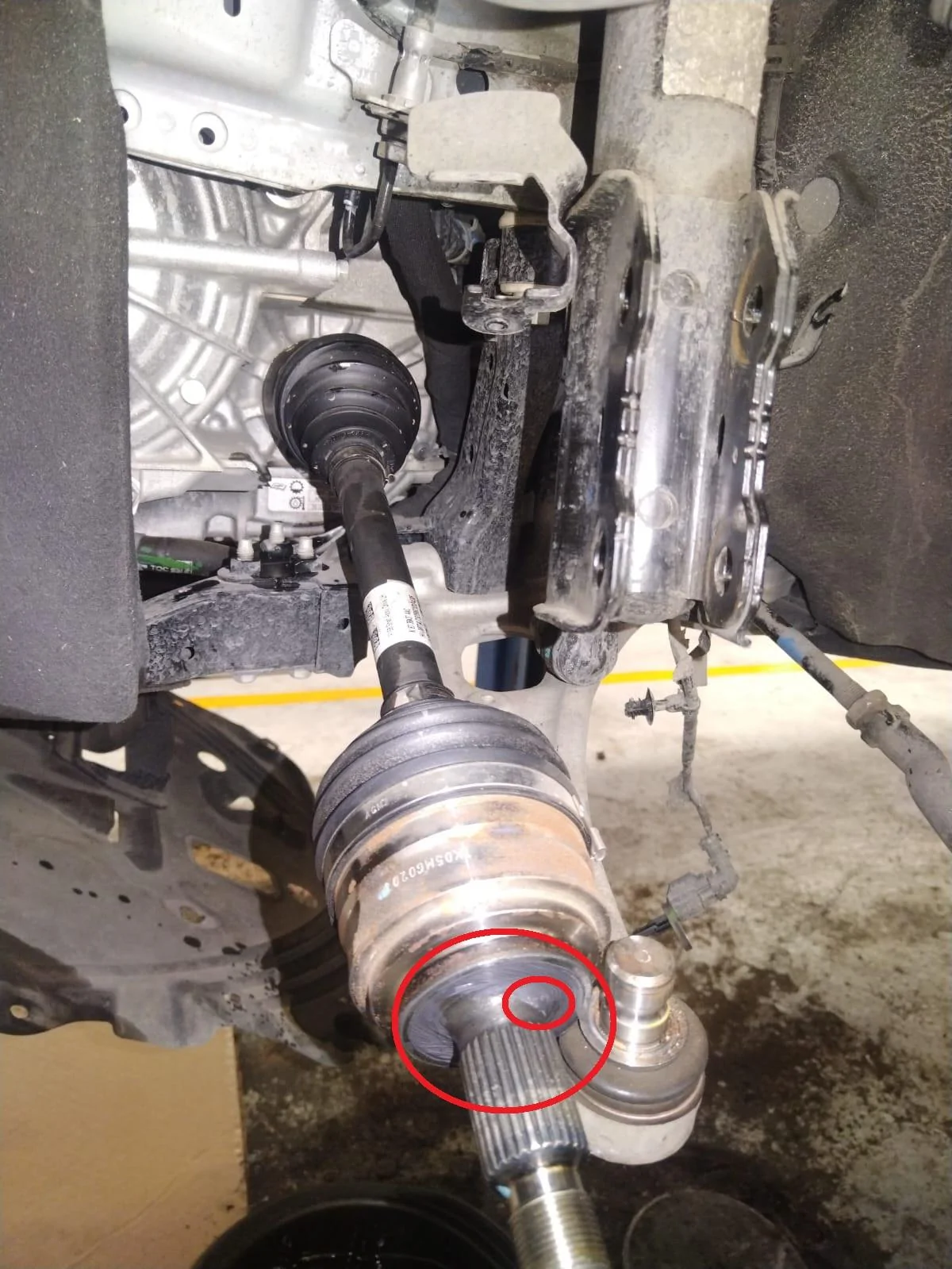

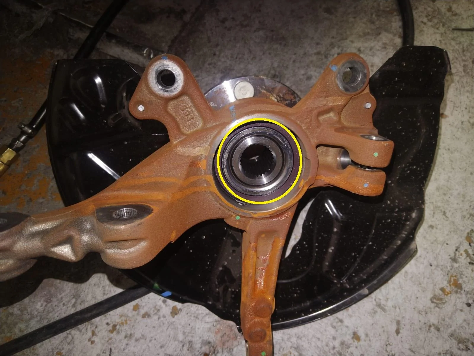

I´m from México.
Ford Maverick 2023 2.0 Ecoboost Lariat AWD
First CV Axle issue started at 3000 Km and the dealer detected the issue at 4000 Km. The dealer changed of the driver side the cv axle, the bearing and all the piece the piece that houses it .
Ford Mexico says that its an isolated case.
My truck remains in the shop due to a knock sound in another place while doing parking maneuvers.
Ford Mexico close my report for second time
Now I´m searching return my truck to change because its an security risk.
Sorry about my english.

Started with vibration and a knocking soud when drive slowly and turn the wheels for examble parking moves.
Now the knokcing sound after the replacement of the cv axle of the driver side its in the center
