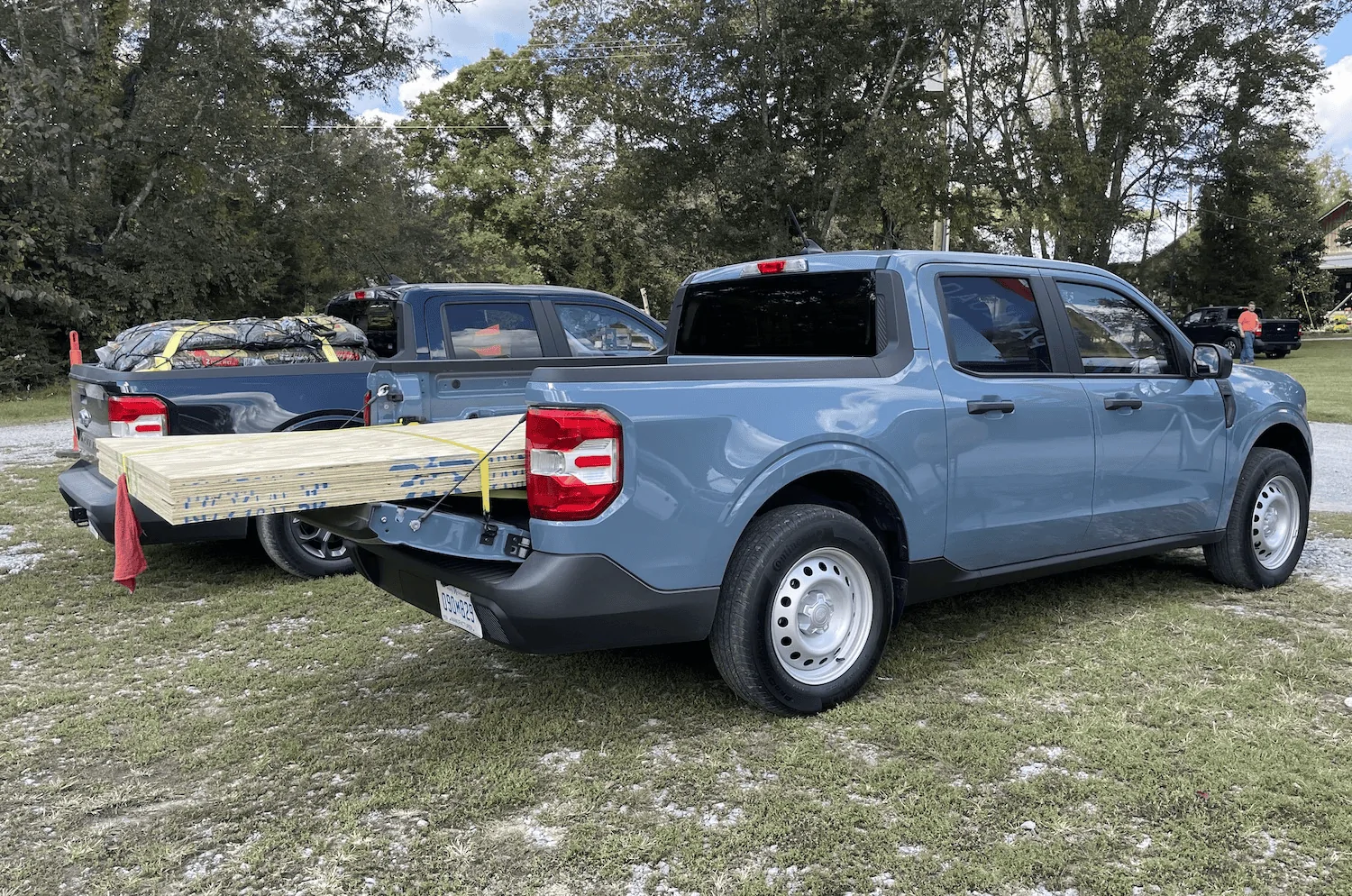

Looking at pictures on how they haul plywood I see the overhang being substantial.
Let us know how it goes, but maybe is best to have one layer of plywood underneath as others suggest.or at least some nice 2x4 blocks as close as possible to the tailgate hinges

How did they get so many Mavs together in the wild? Two side by side hauling things, then that looks like a Mav parked in the top corner of the photo.

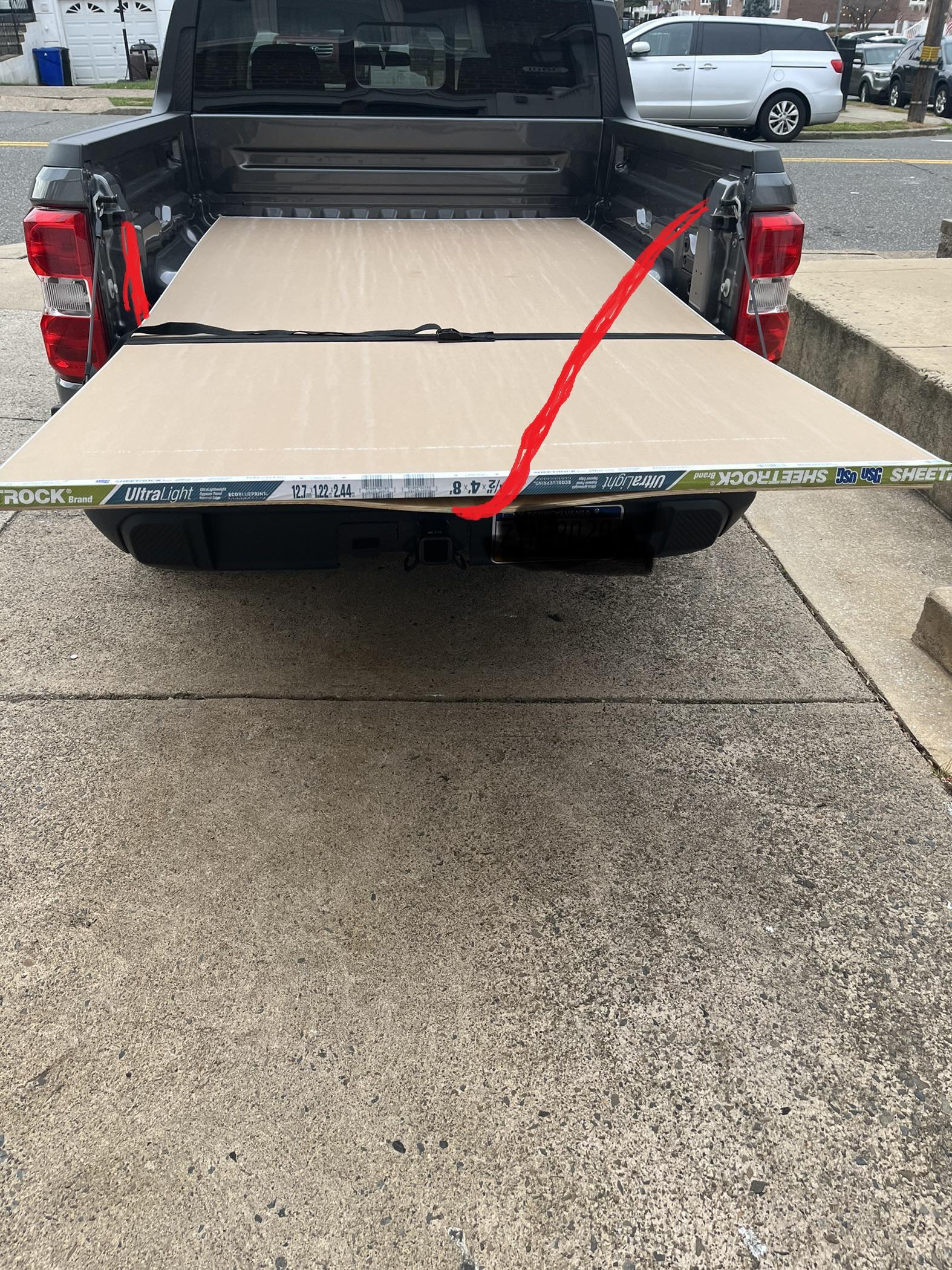

12 5/8 sheets at 62lbs a sheet. It squats a bit and you feel the front wheels being lighter. Still under the max payload by about half. I used a 2x6 under it in the slot it's 54 inches across so I cut a blade width shorter to fit the board in.
Almost looks like one of Ford's traveling demonstrations from before it was avalble for sale in 2021.
