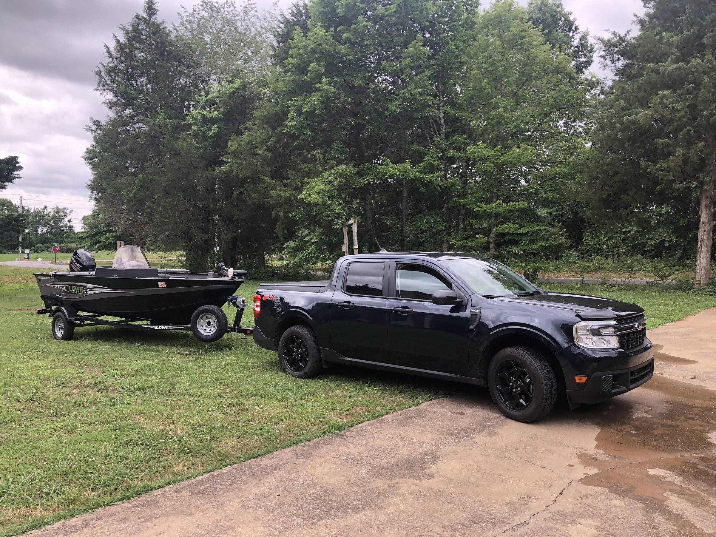

I pulled my 16.5 aluminum at around 3200. It pulled with ease. I used the Tow mode. With the AWD I had no problems at all launching. The rear end maybe dropped and inch or so.

Did you use a 2" drop hitch or something else?

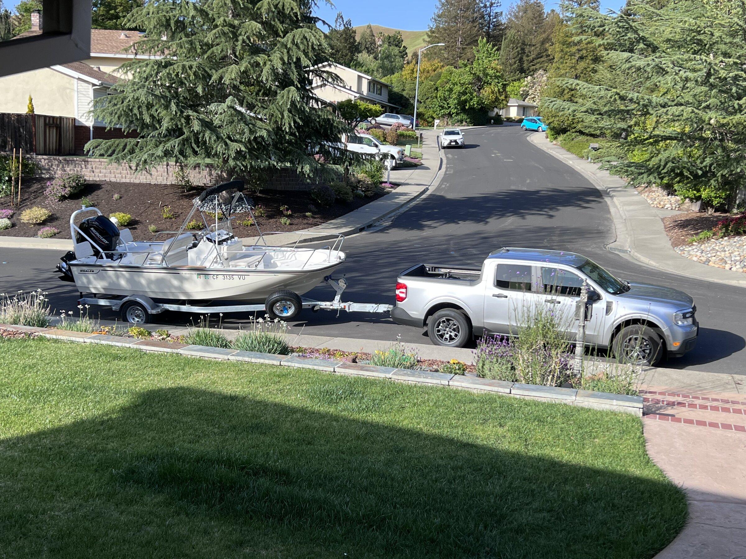

There is a person in my neighborhood that was towing what looked to be a 16 ft runabout.
I was more concerned with the trailer being too small than the truck.
