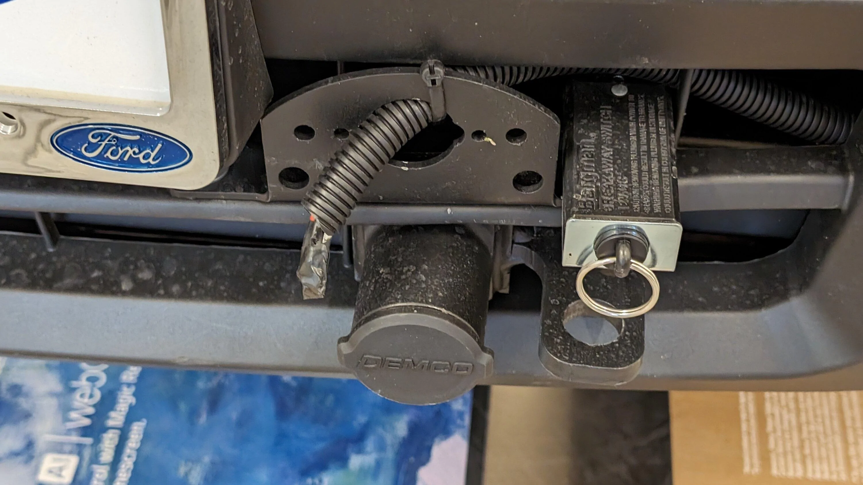

On a related note, I am going to pull my 6-pin socket out as my right taillight wire must have slipped during the last trip and I lost power to that light.
I left my 6-pin mounted rather loose, with 3M VBH tape holding it in place. Hopefully, I won't have to take the fascia off, but if I do, I'll be able to check torque, etc. and see how the mounting bolts have fared over the two long trips...2622 miles and 2720 miles. Demco made a fine Baseplate...but did a poor job of considering the 6-pin placement. If you notice on their picture of their installed baseplate, there is NO electrical pictured at all. When I contacted them, they told me they just "leave that up to the installer". Had they just welded 2 little L brackets like Roadmaster did for my Wrangler, it would have been easy.

Completely agree! Great base plate, great look but wow, the cables and 6 pin... well let's just say there was no thought to that.
On a related note, I am a complete novice here to this, my first coach and towed. I had no idea that the baseplate or wiring kit did not include the 6 pin or cable for it. I had the truck apart and put it all back together as I was lacking the parts to complete it. I'll have to do the wiring the hard way after my parts come (Amazon - after your comments, thx!) without the benefit of a removed front end.

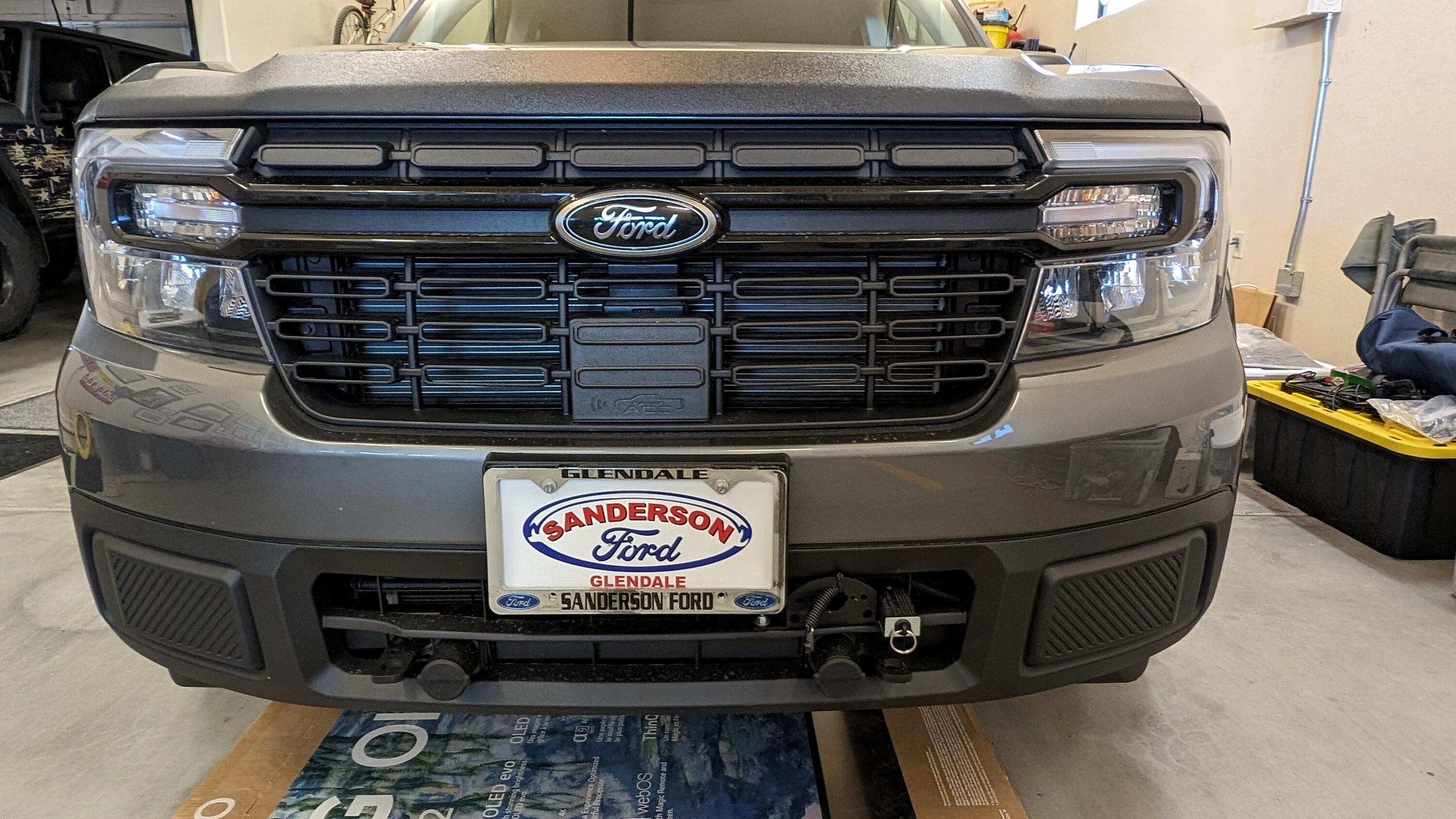

I finally got around to installing the Demco baseplate on our 2024 Ford Maverick Hybrid. A pretty easy install with the following notes. You have to cut a small section out of the air dam system to make room for the baseplate. In addition I had to remove small plastic tabs from both driver and passenger side so the baseplate lower mounting holes would line up. The provided hex bolt to remount the PAD on the drivers side was too short even with washers removed. Had to buy a longer 3/8 inch grade 8 bolt, and nut. But overall a very easy install. I still have to mount the Readybrake surge system.
