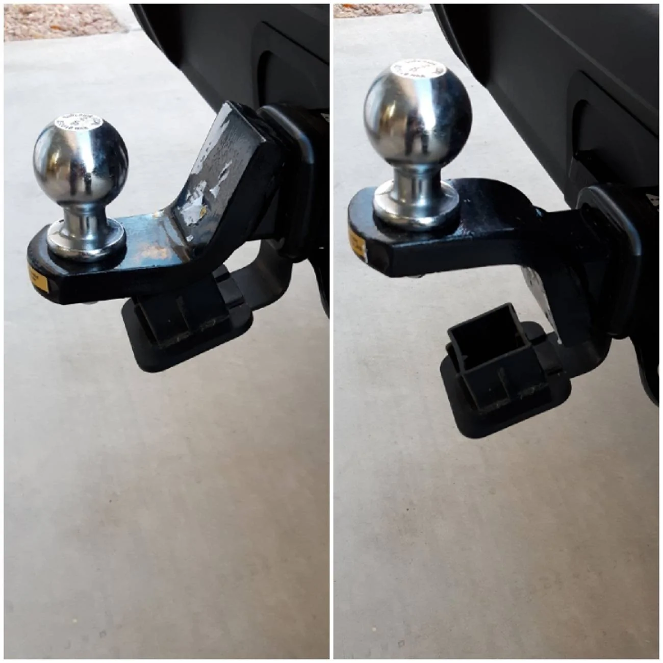

Maverick Lariat
3/4" Rise works perfect with U-Hual trailers, and I have an 8" drop for my small Carry-On trailer. A normal 2" drop would probably fit the bill for 90% of the users out there.

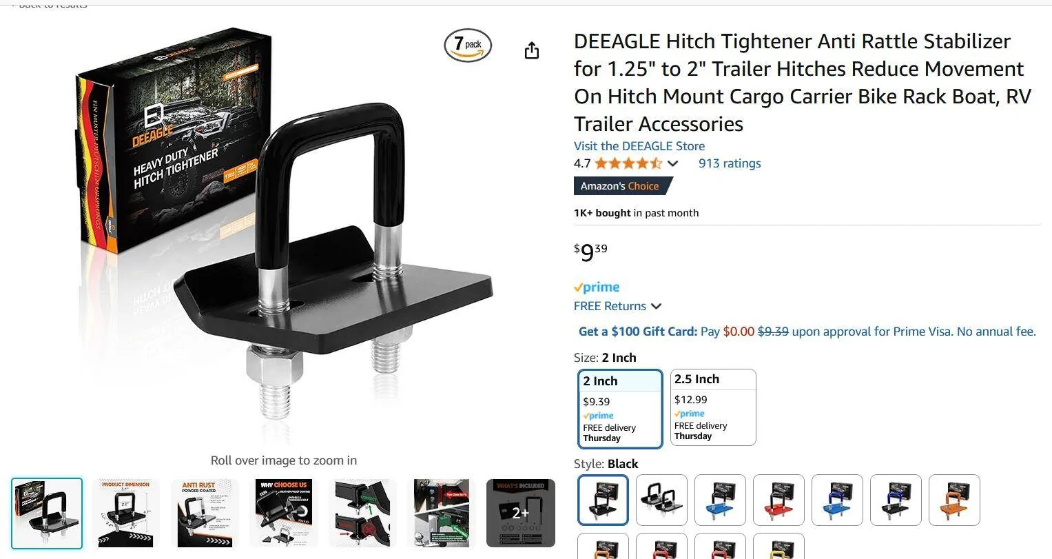

Be sure to get one of these too. They are needed for any unibody vehicle to reduce the clunking of the hitch.
Yeah, highly recommended, can make a big difference w/ a hitch and especially if you slide in one of those receiver mounted platforms that some folks like.

The anti-rattle devices are nice to have, depends on what you put in the receiver though. I've used it with and without, and honestly don't notice much noise difference. Saves some paint damage on the receiver though. Buy some primer and matte black paint too, because those anti-rattle devices, and ball mounts, will scratch the paint on the receiver over time. If you leave it, it will rust out.
