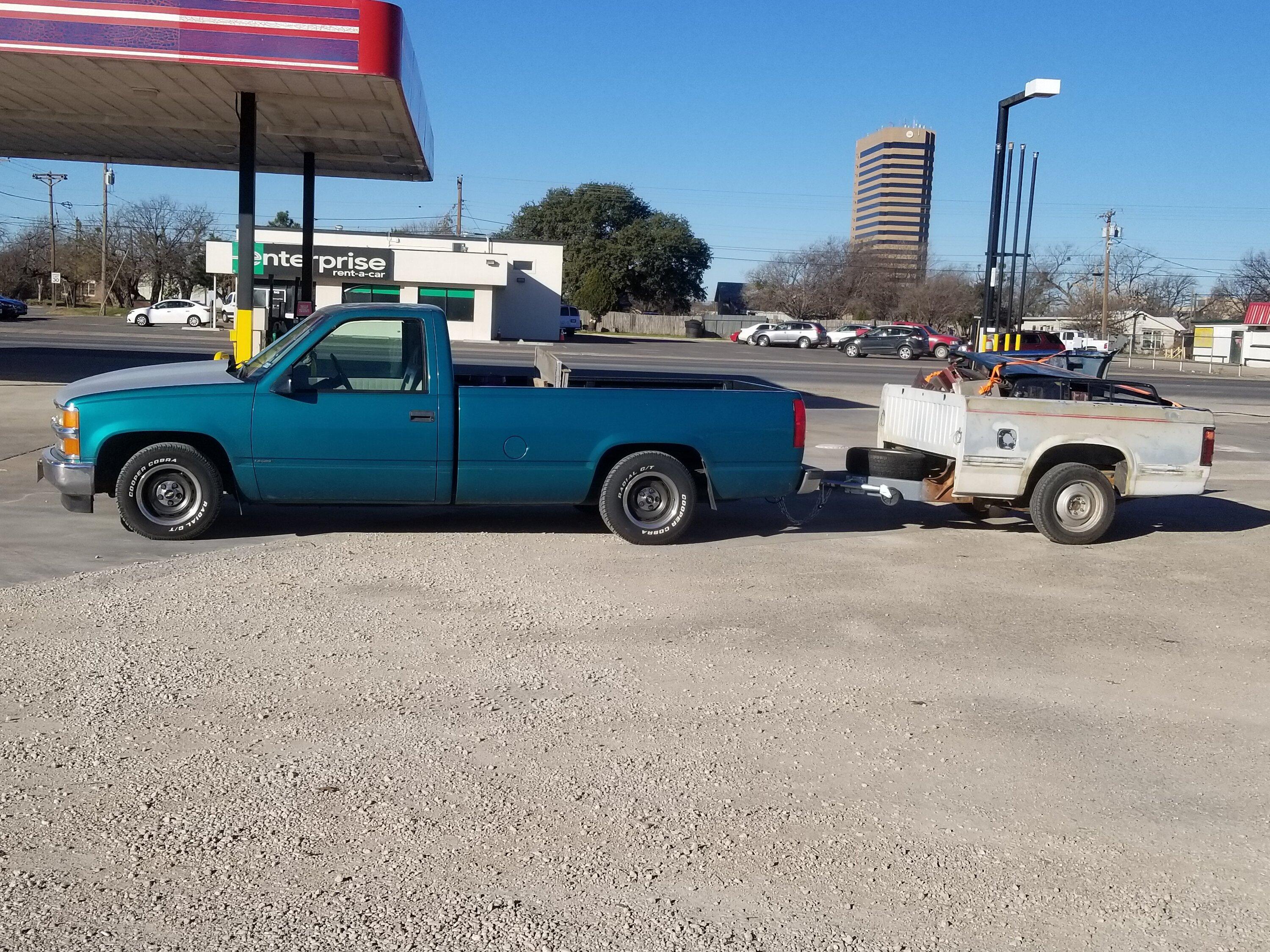

I picked up one of those like the one in the first pic, I will likely flip the ball around. My trailer is an old converted dodge dakota pickup bed into a trailer. Maverick may end up sitting too low for it. But then again my silverado has a 2"-4" drop on it and sits just right with the trailer.

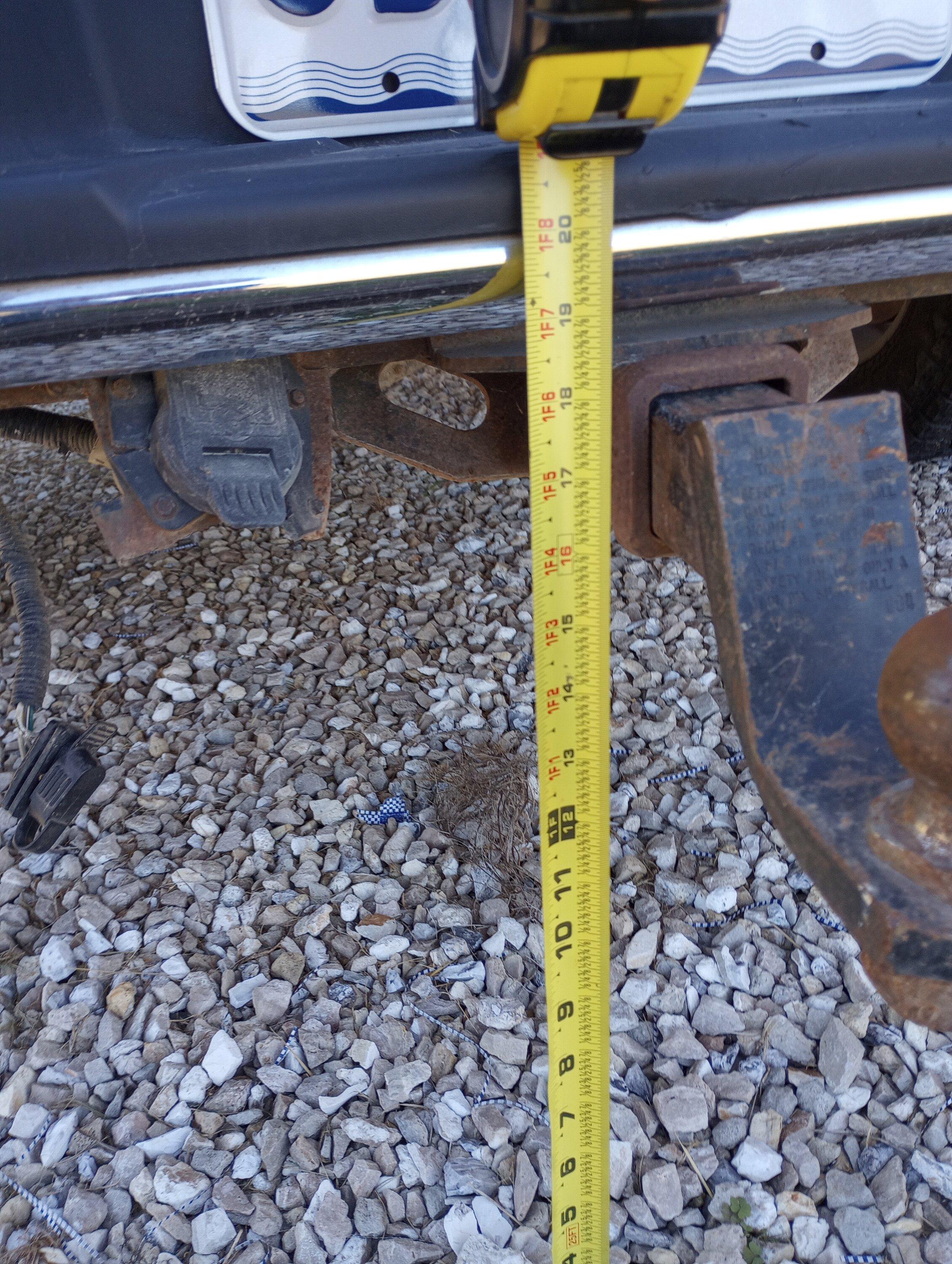

FWIW, MY 2006 F-150 4x4 receiver hitch is almost an inch lower to the ground than the one on my XL Maverick AWD. I'd just wait until you get the Maverick before you buy anything.
Actually it's a wash. Neither are sitting on pavement so there's that factor.....

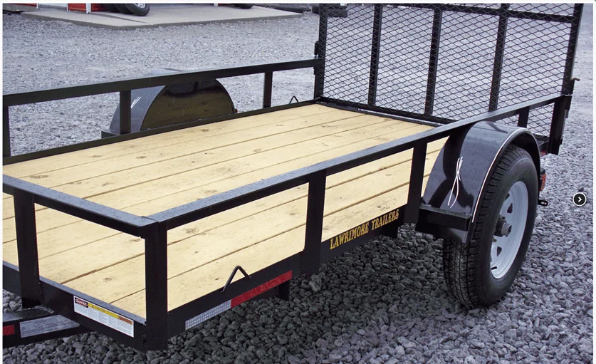

I just jumped in to learn about the trailer ball I need to get and I just wanted to say:
"You have a very nice trailer."

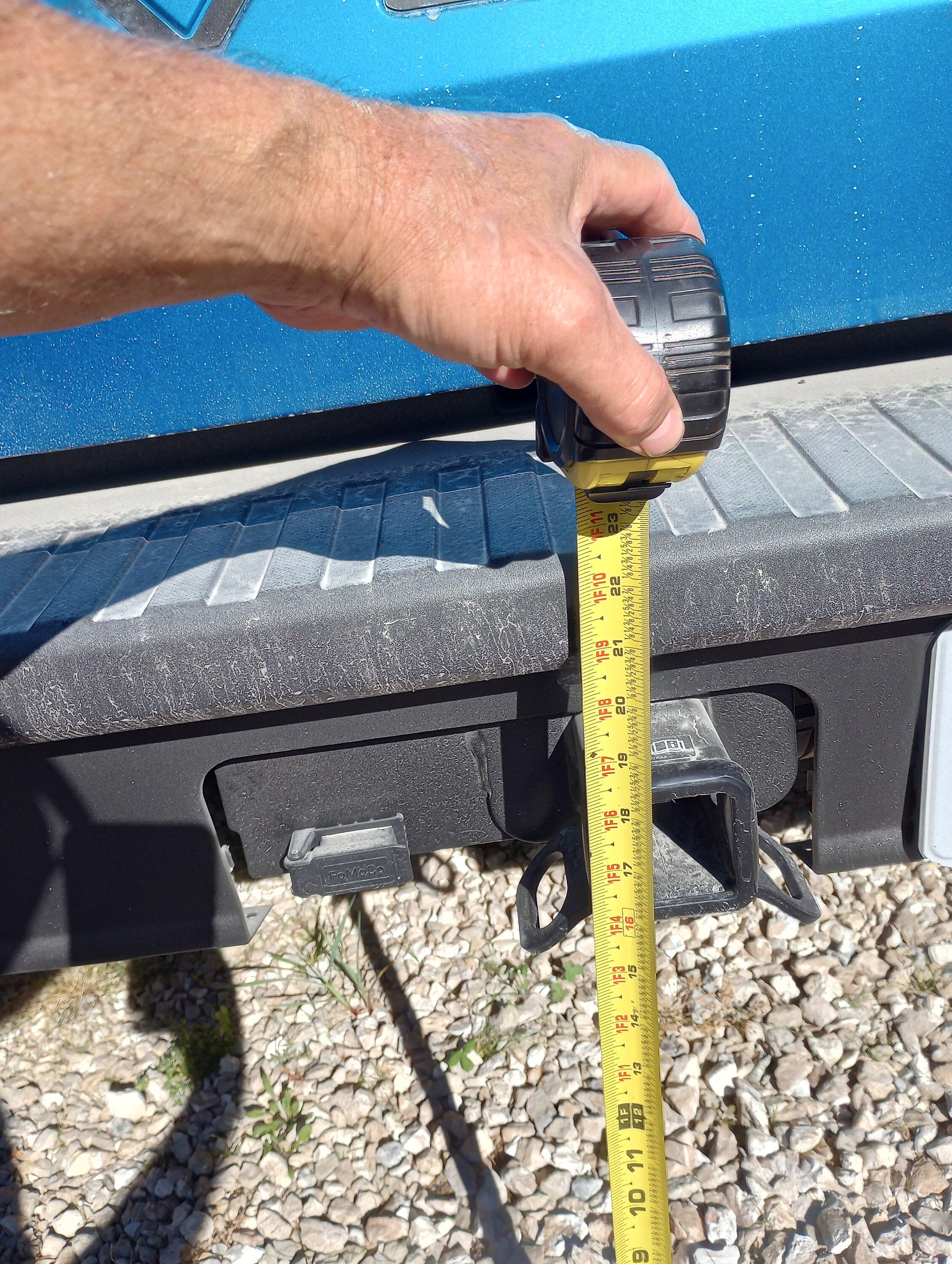

I'd wait and once you get your truck (whenever that is! :)) then do the measurements that @Maverick2022XL describes. You always want your trailer level or slightly above level at the tongue., never lower at the tongue.
