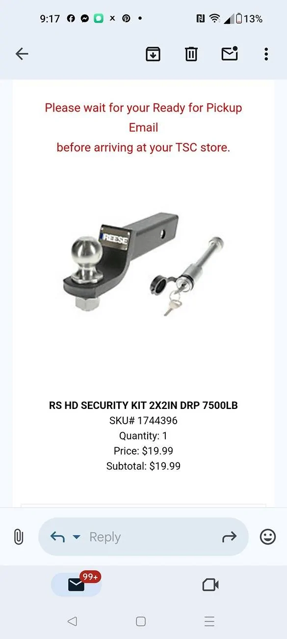

Got mine at tractor supply last year. All their Reese stuff was heavily discounted.

Yup... go to TSC and get the set shown above ⬆ or go to Harbor Freight and get theirs. There's no use throwing away your hard earned $$ on something you likely will use only occasionally and towing w/ a Maverick it's not like you are going to need some big hairy-chested beast of a hitch, anyway. Yeah, YMMV.

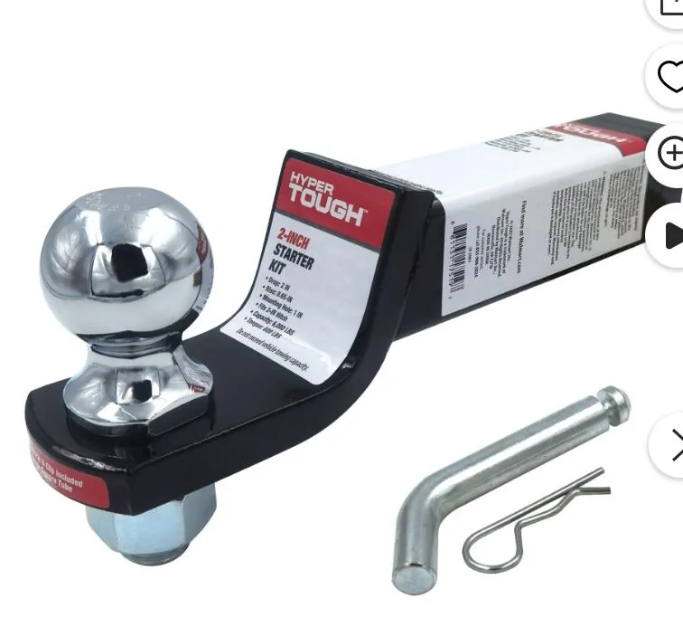

Basic hitch pin , or locking pin ?
Aremite
Sep 22, 2024
43
WA
2025 Lariat Maverick
Hey!
Let's keep this going !
After looking closer at the one I said, it doesn't come with a hitch pin 🤔. So this information would help me too!

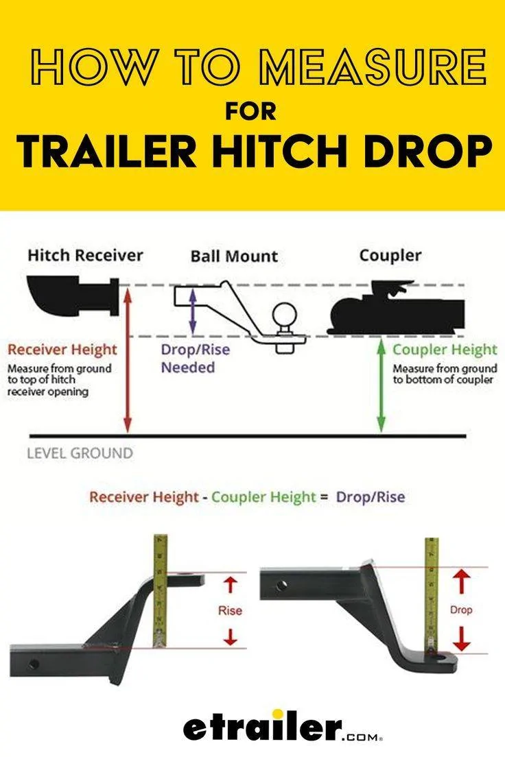

Here is something I copied off the web that shows how to measure drop relative to the truck and trailer - it may come in handy if/when you start swapping trailers.
Mods - If posting this somehow violates any rules please delete ASAP
