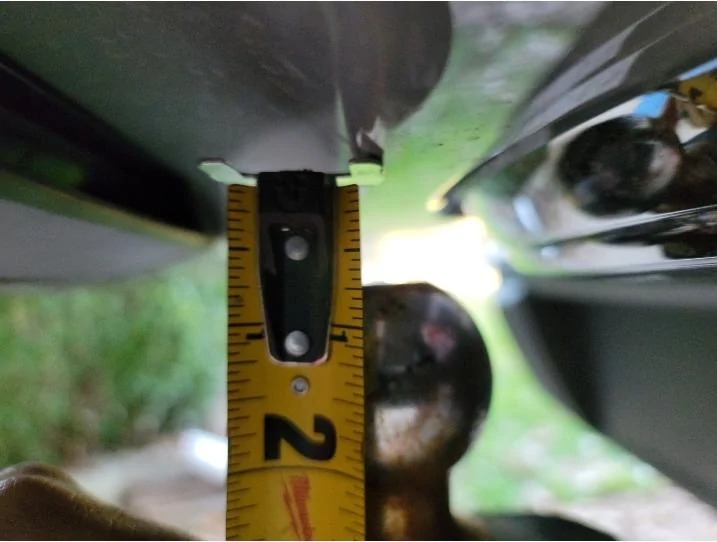

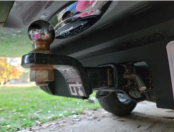

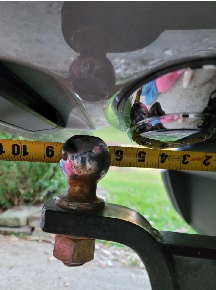

Just over 1k miles and finally slapped a ball into the hitch then promptly frightened myself dropping the gate down.
Worry not, though it looks scary, I couldn't get the tailgate to actually touch it.
