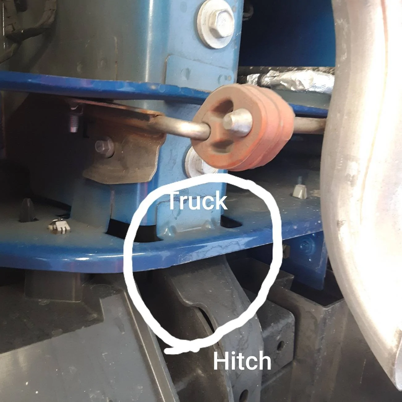

Here is a picture of the mounting of my OEM Ford hitch. The OEM hitch actually slides into the bed support/"frame" member and is bolted in place with the two silver bolts.
Factory installed Hitch AND Wiring $100 when ordering.
Definitely worth it.
Good Luck
This is what a factory install looks like.
