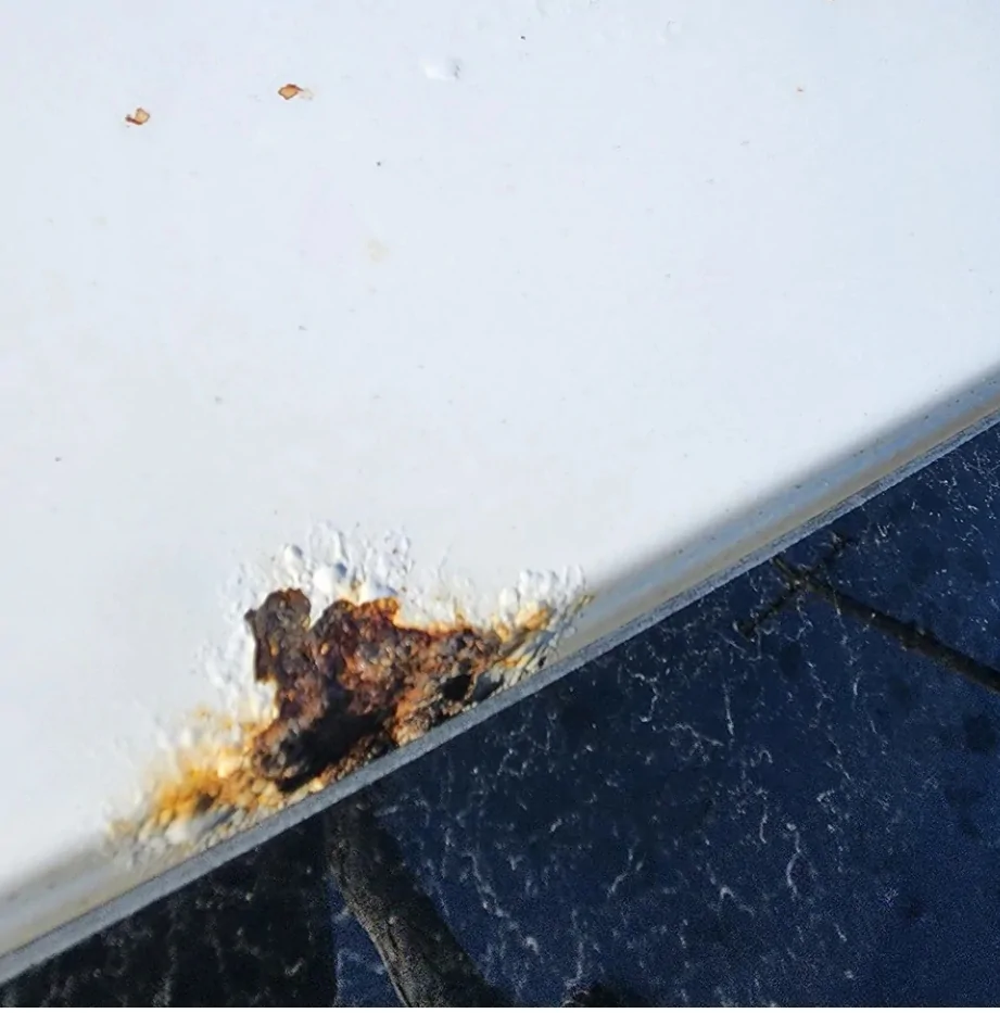

My rust points are typical of what others have said. The rear tow receiver which I wire brush and Tremclad every spring. Most worrisome are the three bubbles at the top of the windshield caused by rock chips. I wipe Fluidfilm on those every time I detail. Not sure if that helps but it won’t hurt. I also spray Fluidfilm on lower door panels and rockers every fall

Sadly, one of our members has this area.

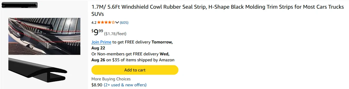

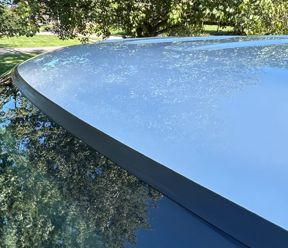

I just installed rubber weatherstripping from Amazon across the roof where it meets the windshield to hopefully help prevent chipping and future rust along the edge. There are multiple types. Somewhat tricky to install and separate at the same time to get the bottom rubber strip piece down and under the glass edge. It fits nice and tight across the top.
Very nice job. 👍
Thank you for posting pictures.
