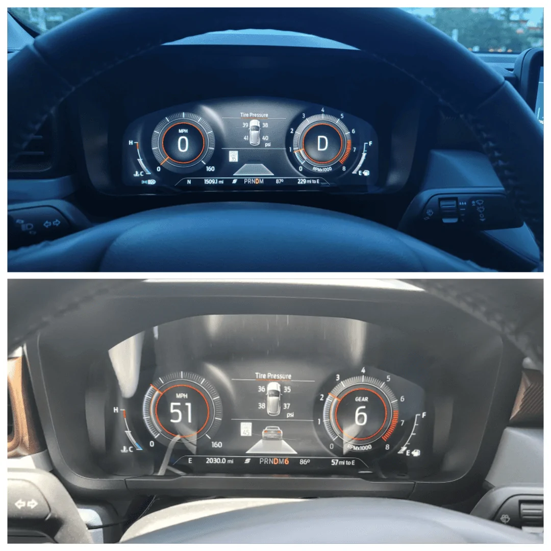

Made a lil progress. Gears now show actively switching when driving and in Sport Mode the digital rpm gauge now becomes the gear display. ;). Will update later when I get further along. Top pic is what the cluster showed before.... just the giant D... bottom pic shows now.
Mind sharing how to change the D to the current gear? I also have the Escape cluster in my Mav.

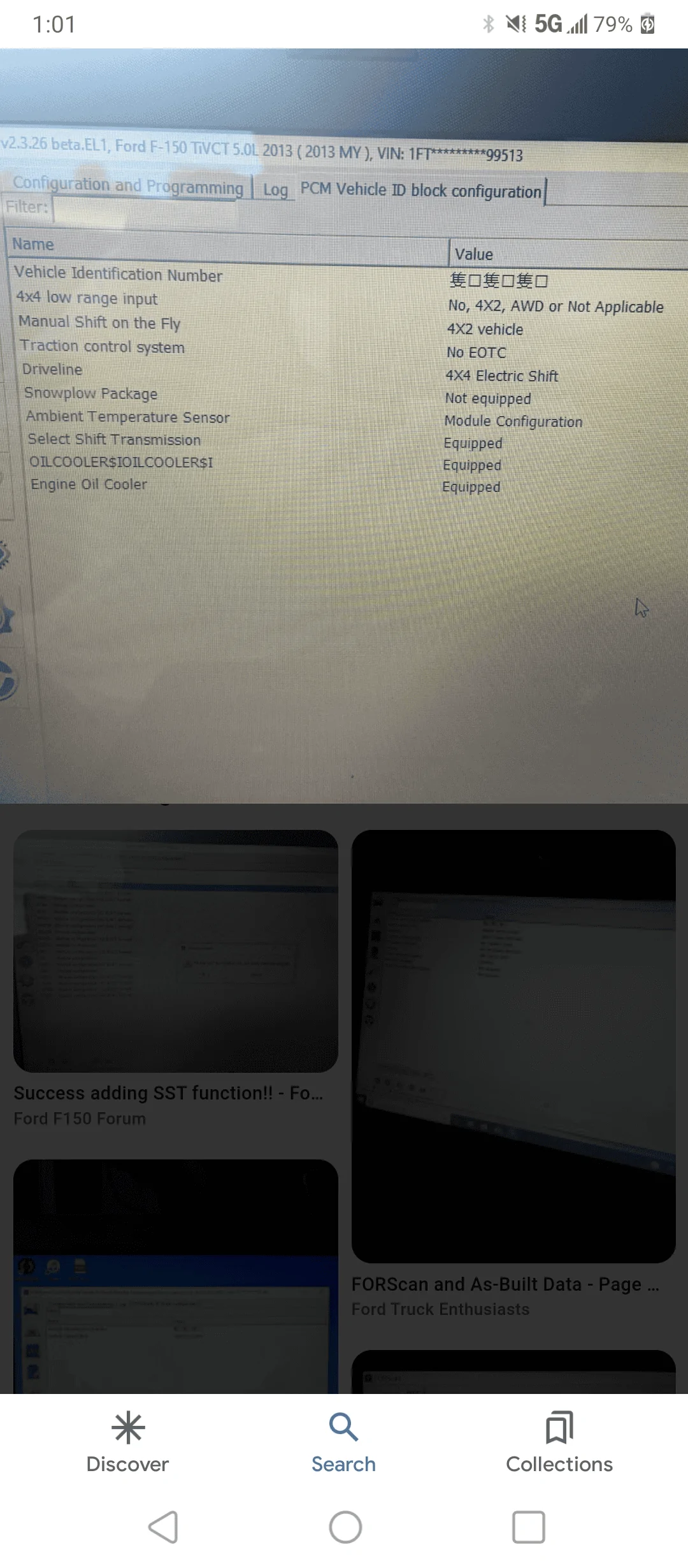

Has anyone tried to go into PCM ID Block configuration and changed it to select shift transmission using forscan to activate this? I will look on my escape next time I am using forscan. On my 2013 F150 this was the only way to make it work by swapping the cluster, column shifter w/shift buttons and enabling the selectshift trans. If the maverick has this ability on forscan or IDS this is probably what needs to be done. The photo below is not mine but It shows what needed to be changed under PCM ID block, from not equipped to equipped and write.

It's more to it than just hexadecimal changes... to answer your question however, yes.
Cdubya2020
May 25, 2022
Iowa
Escape
Ok I am going to take a shot at adding a paddle shift wheel to my escape. I purchased the wheel today and should be here next week. I have a 1.5 3cyl w/8 speed. I already have a PRNDM shifter sitting in my garage. Lets see what happens. I also have a BCM from a Titanium that I can swap in if need be as well. So has anyone actually made changes to the PCM so far?
