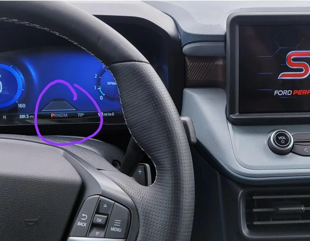

Ive made a lil headway. Waiting on my Bronco Sport rotary shifter with M (Manual Mode) before I can go any further but I have identified missing wiring that I will be adding back in and rechecking my pinout from the PCM to the GSM. Already toggled on the SST setting in the IPC that allows for paddle shifter upshift and paddle shifter downshift operation as well as programmed my Escape digital cluster to show PRNDM instead of the previous PRNDL. Will be looking at programming strategy to ensure there is no difference there. There may still be hope yet!

It is full control meaning the trans wont upshift until you do in manual mode.. in normal mode you will be able to lock out gears but the trans will otherwise upshift before you redline. BUT no one is going to like what you have to do to enable them. I'll share when I'm finished. It's intrusive.

Been really busy so I haven't had much time to work this out but I think I can work in some time next weekend. Most, if not all, will be extremely surprised by what needs to be done. I cannot say this part enough. According to my initial research, which I trust... this is a more "involved" upgrade. No idea why Ford went to such great lengths to ensure this was as difficult as gathering pee from a T-Rex. 😞
