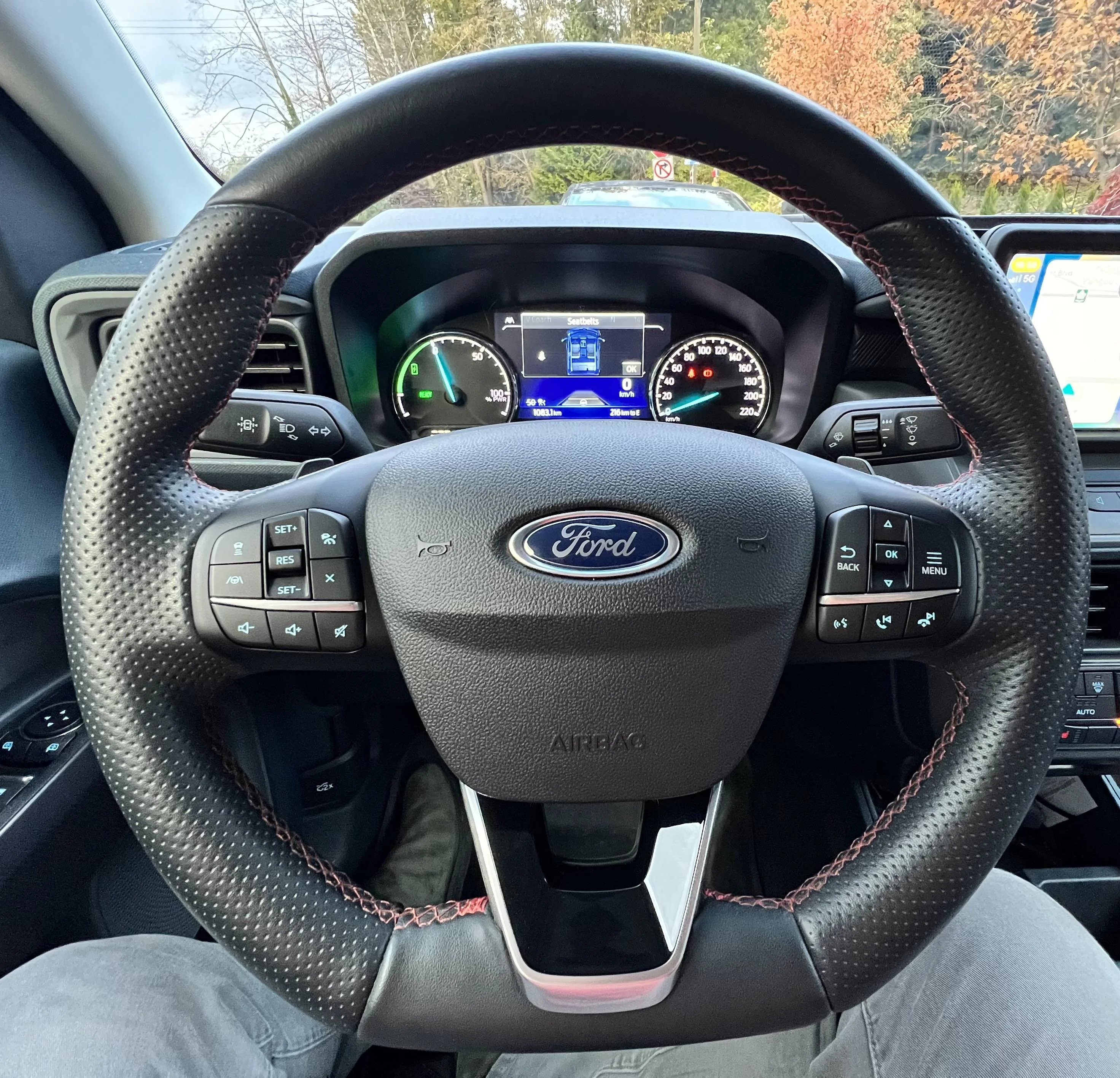

Just swapped the stock steering wheel for the Kuga with paddle shifters. Looks and feels much better.
Fingers crossed for progress. Hoping to use it to turn on and off the L from the rotary shifter. If not then just window dressing.

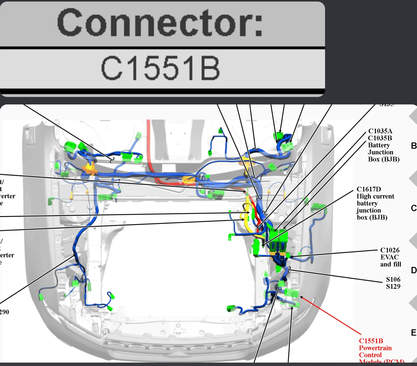

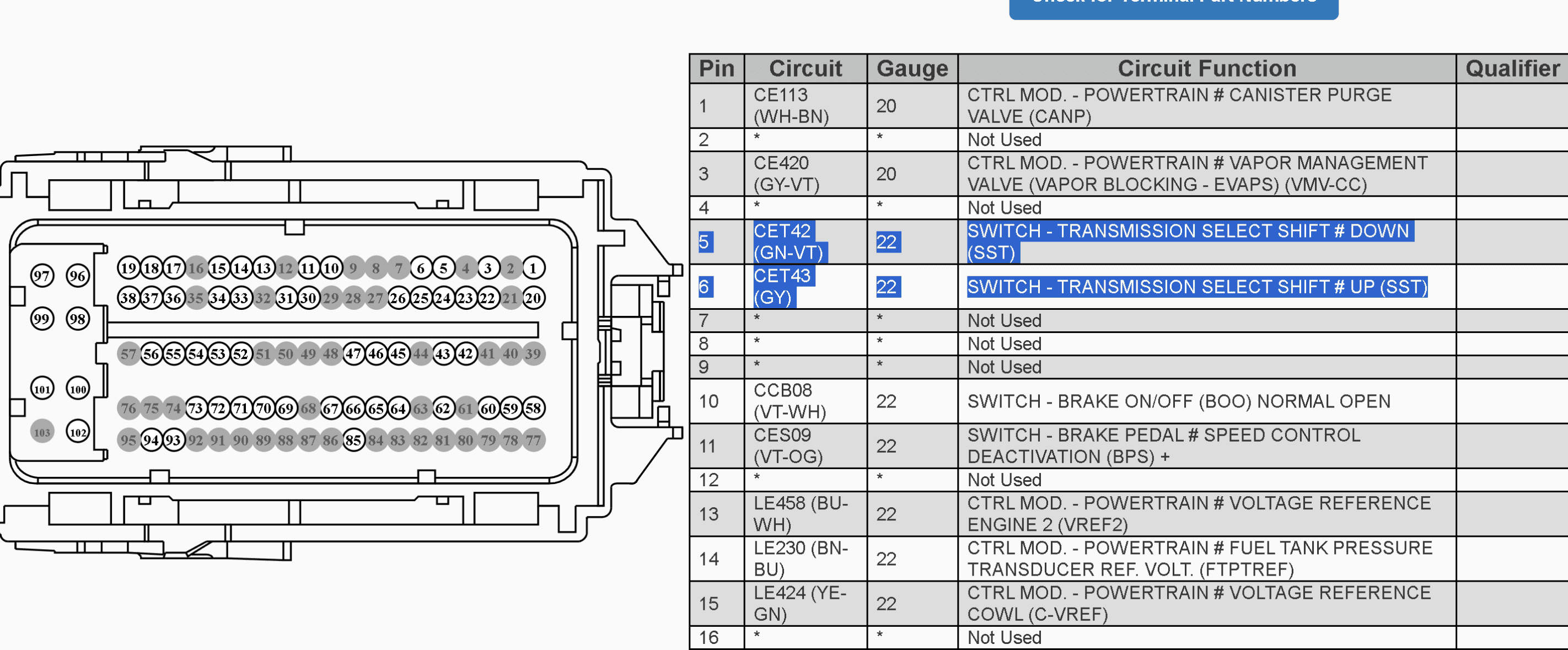

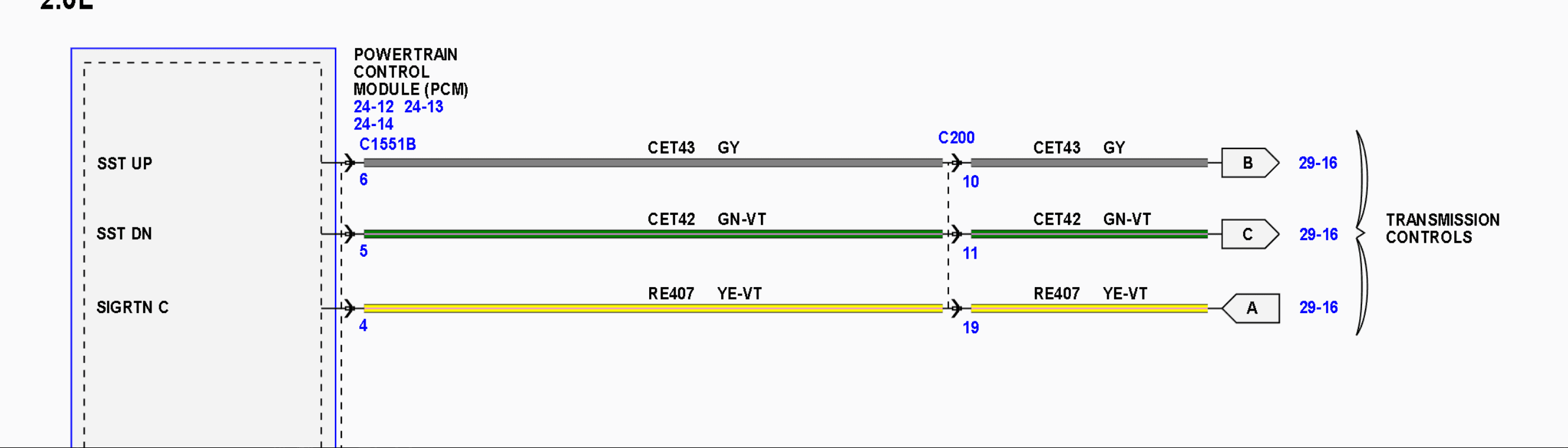

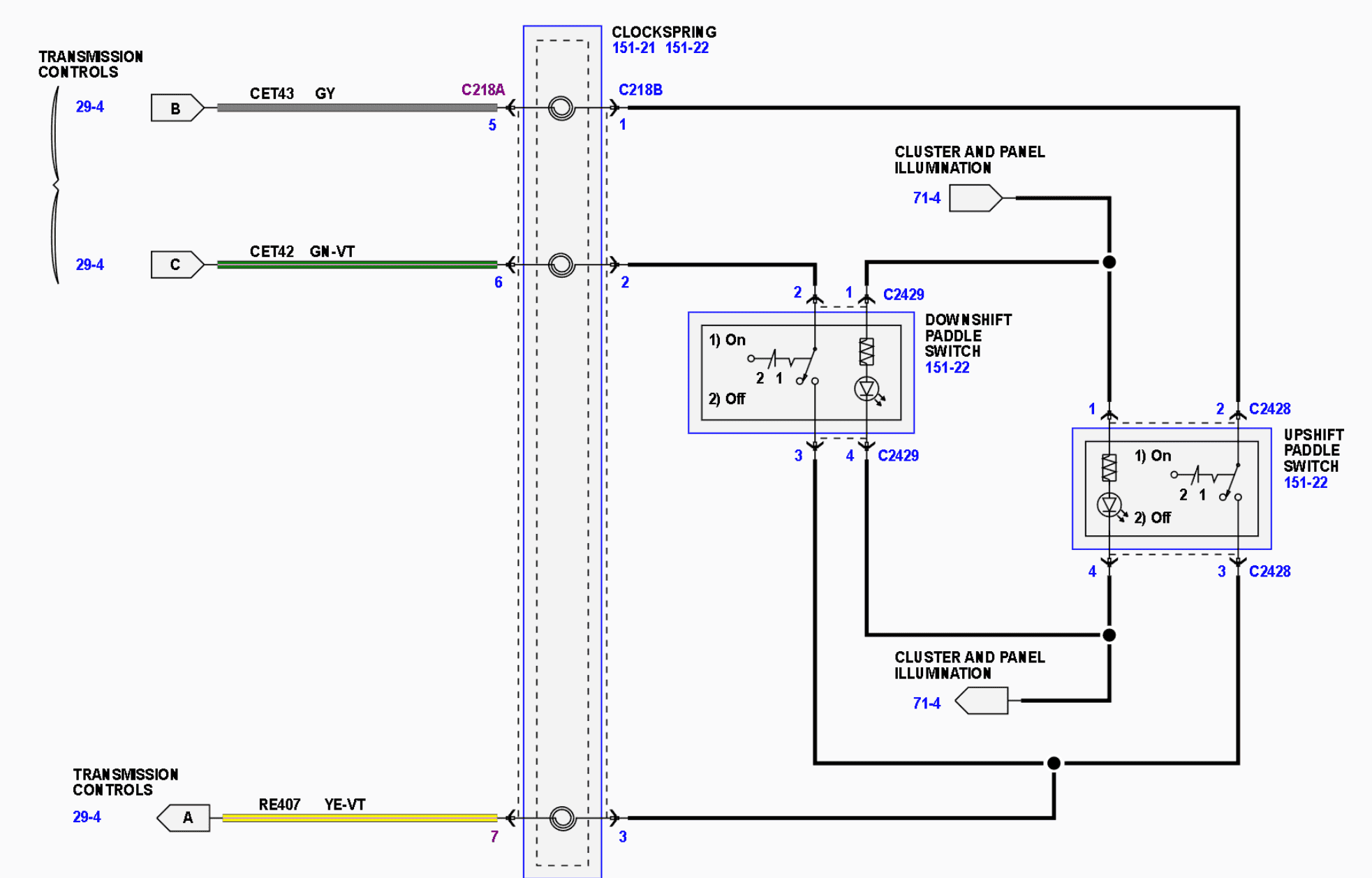

From what i seen we got to add 3 wires from steering wheel control module all the way to pcm.
i will update once i do it trying to find the clockspring wire terminals online they where on back order.
