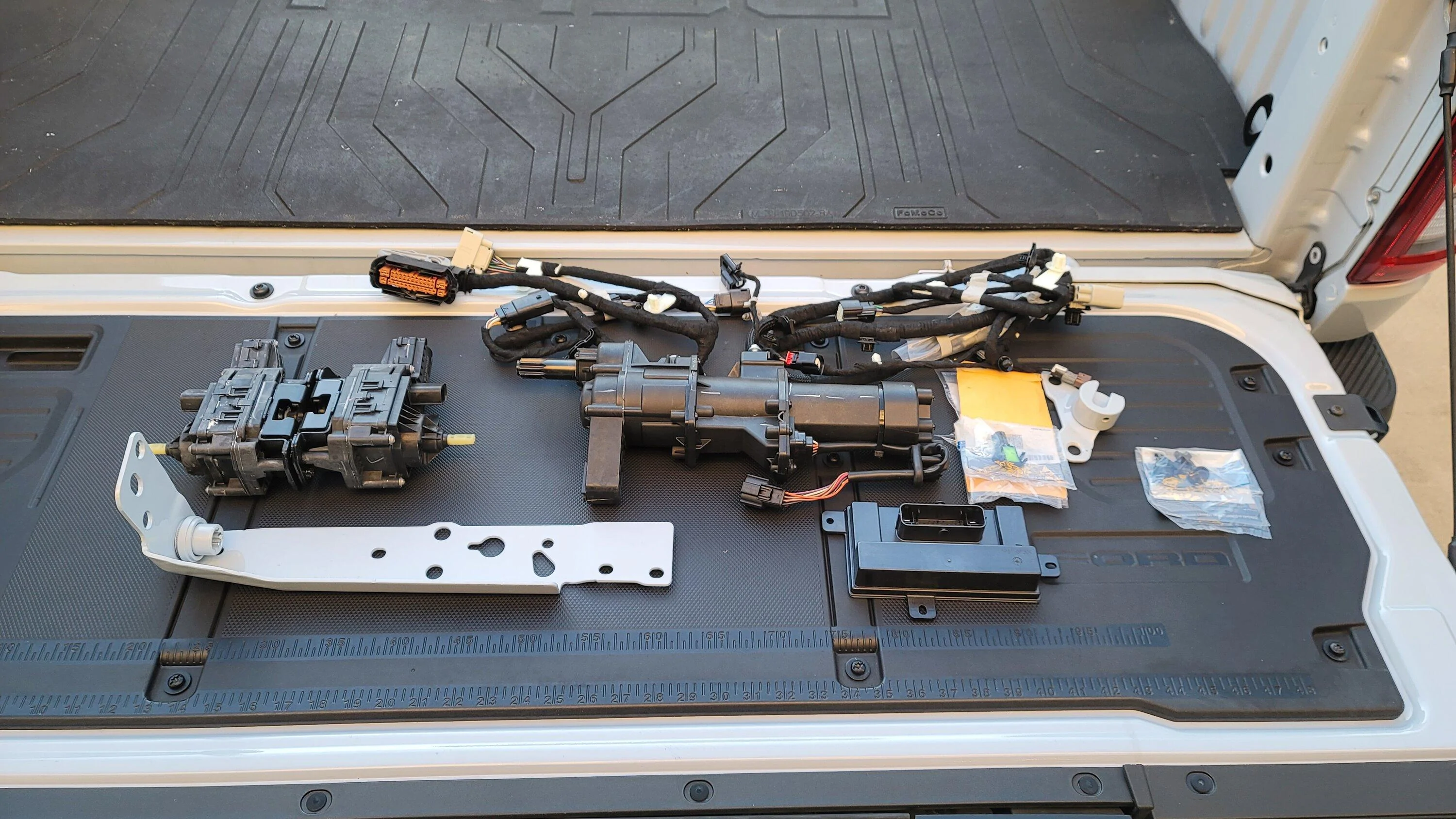

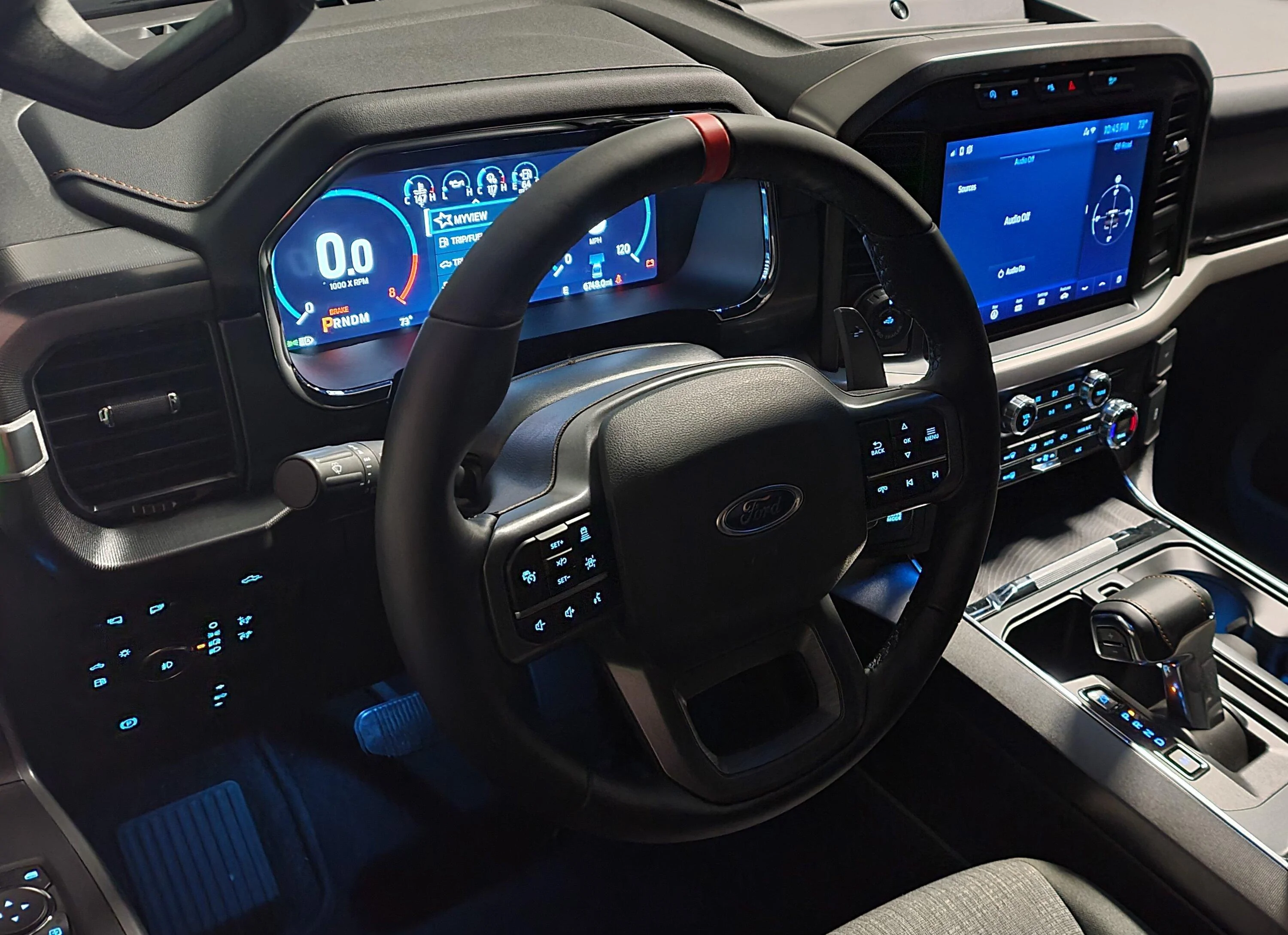

Ok hit a small road block today...BUT I think it's a go on the paddle shifters! The pins used for the wires that need to be populated at the PCM are not common. I have hundreds of various oem Ford pins and nothing I have is what is called for in the locations in the PCM for the SST connections. I'll order what I think they are in the morning. Ford states they aren't available as a serviceable pin. Either way I'll see what's what. Sooo with this said I decided to wire up my 21 F150 single cab for oem heated steering wheel and prewire for power release up/down tailgate as well as some other wiring. Today was still a good day!

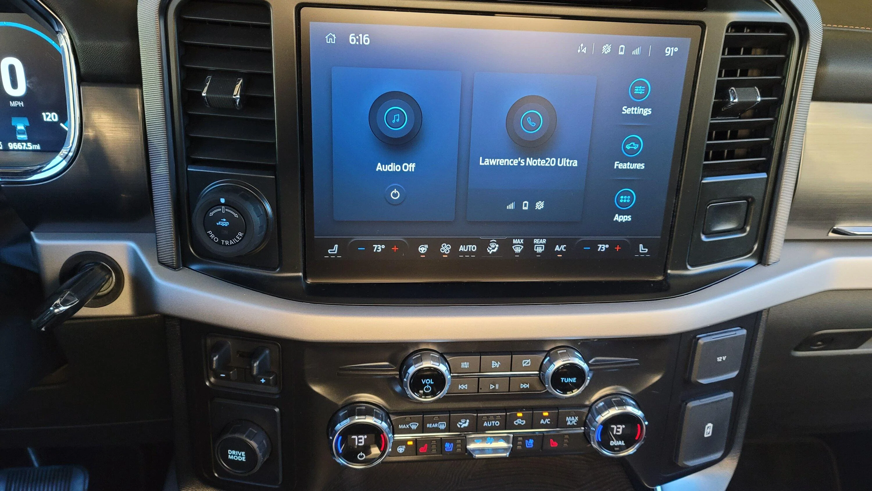

You are THE MAN! I can't wait to see what all needs to be done to get the shifters working. I work at Ford so if you need any part#'s or wiring diagrams just let me know.
Also what screen is that? I've never seen that on any of our 21+ F150s

Thanks for offering diagrams etc. I own a business that creates and builds oem wiring upgrade solutions for a few Ford trucks offered retail thru our website and thru select local Ford dealerships. We have direct access to the diagrams and we use FDRS, IDS, and for our retail mail order customers, FORScan To allow them to DIY there installs. Lol this is why I don't get alot of time on projects like this because I'm either teaching, training or assisting my employees. This one is more involved than it needed to be. Ford could have saved alot of money using the same main engine harnesses as the Escape and Bronco Sport...but we shall see. Thanks again for the kindness..appreciate it. 😉

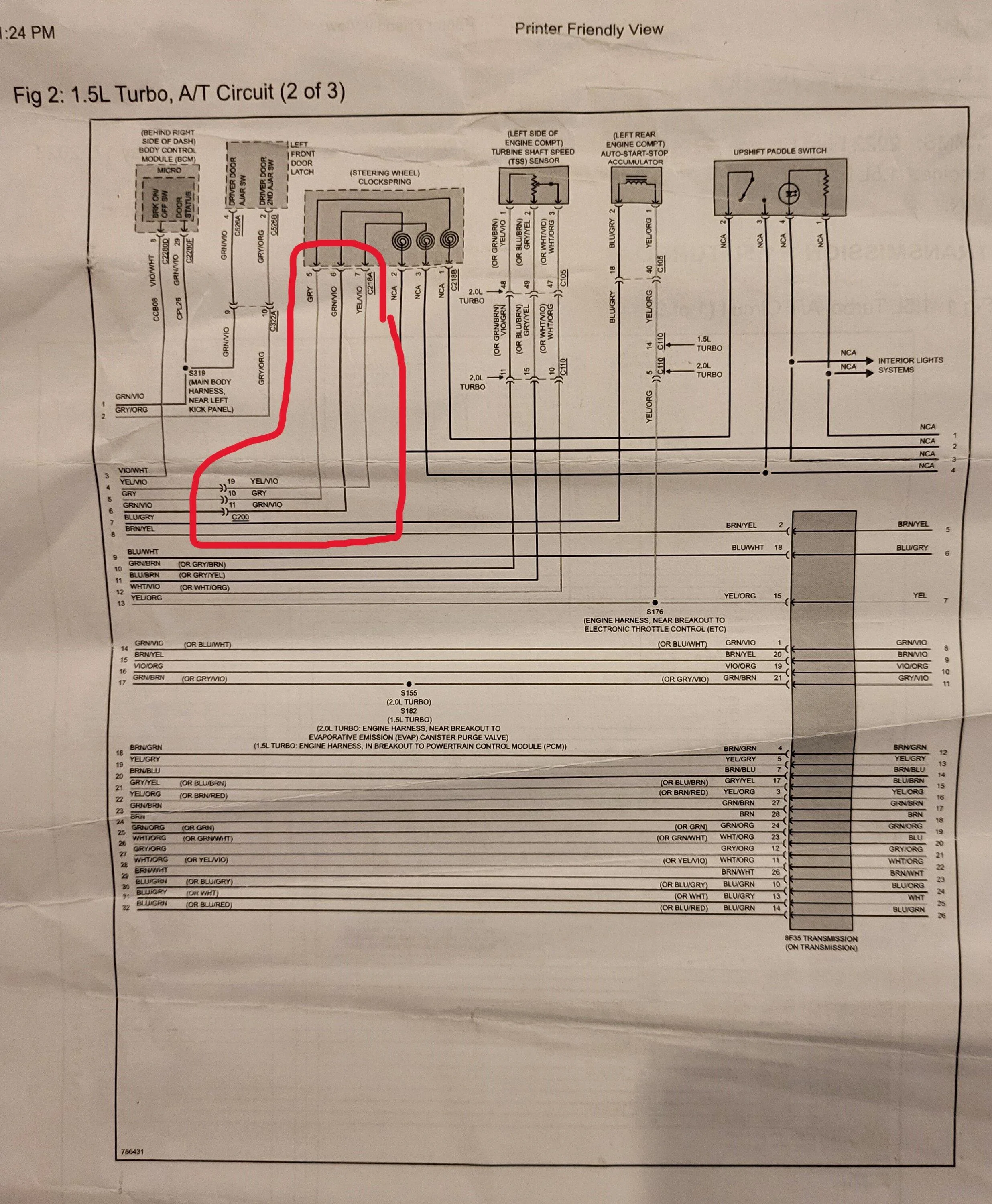

I've been lurking on this thread as I've been hoping someone would crack this nut. I have a 2022 Ford Escape SE and my one big complaint is that I have no manual control of the transmission.
So I bought a Euro Focus steering wheel with paddles and hoped for the best but it does not work out of the box and I think I know why.
The clock spring does have the wires for the paddles but from the clock spring to the car, those terminals are empty. I got my hands on a wiring diagram and it shows these wires going directly to the main ECU or PCM, located near the front left tire. What sucks is that when I looked up how to replace it, there is a spot where you have to drill out, which means you will probably void your warranty.
But, on the wiring diagram it shows these 3 wires going to a 3 pin connector (C200) and then to an unknown location. I wonder if we are just missing that small 3 wire harness? From what I've researched, the PCM wiring harness has the SST wires.
Anyways, I hope someone can figure this out. I'm thinking all the Forscan in the world isn't going make this work till the wiring is complete and it could just be as easy as that.
