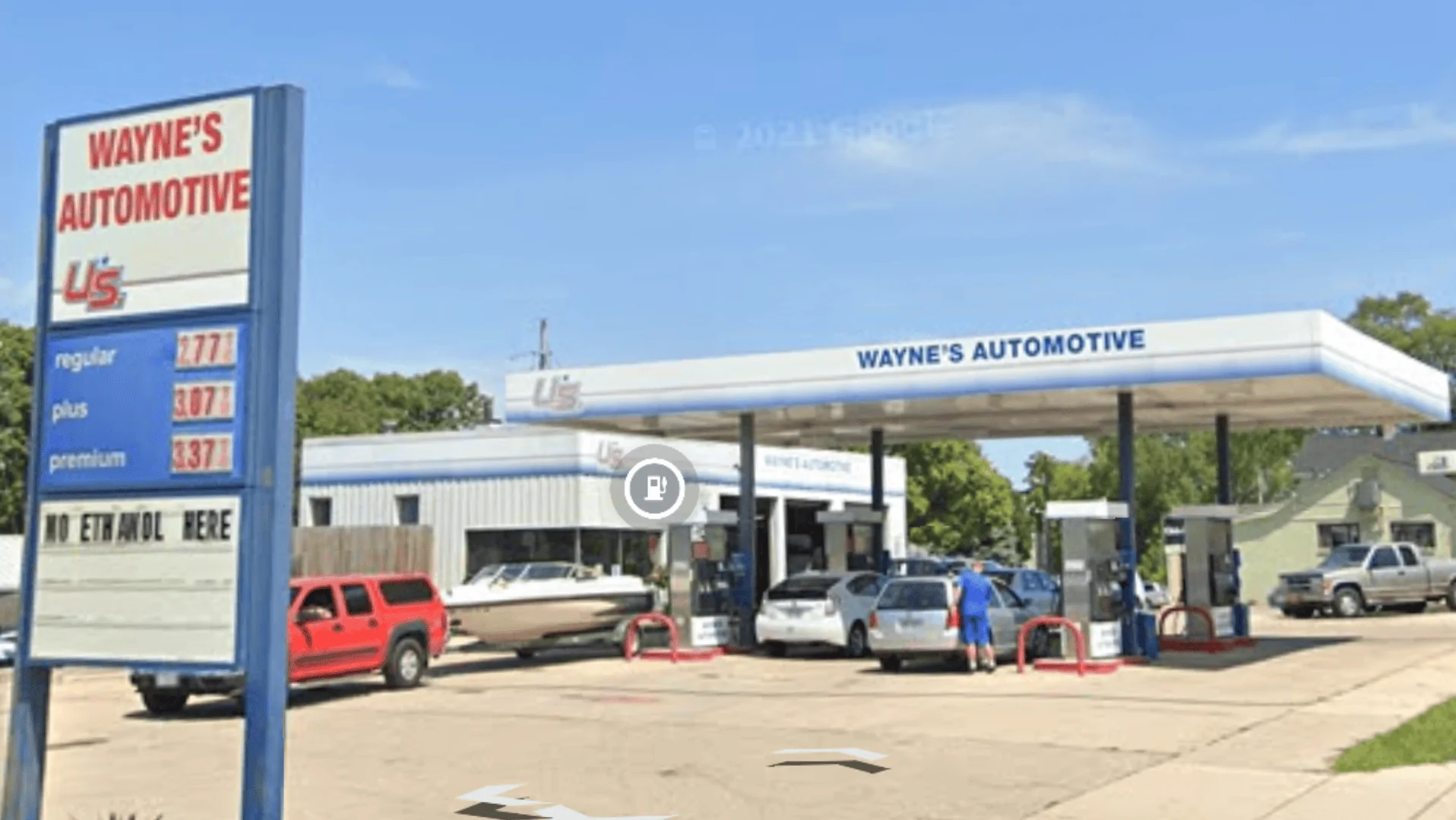

This is a place in town that works on small engines and has no ethanol on all 3 grades. It's 5 miles out of my way so I only go there to get gas for my lawn mower and snowblower, maybe 3 times a year. Picture is from Google maps. Prices are usually ¢5 higher.
