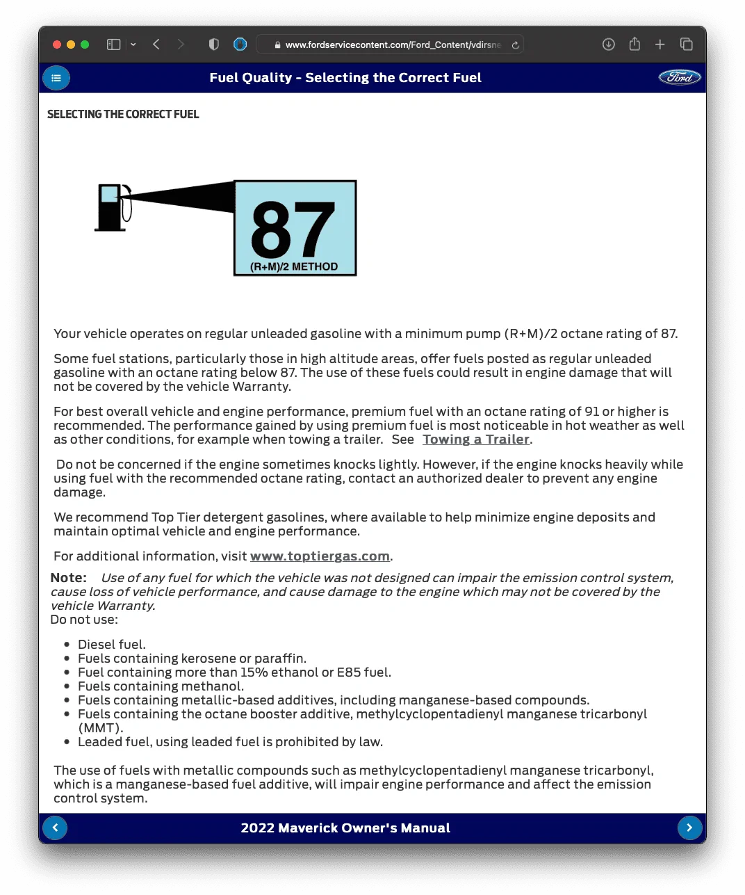

Read your owner's manual. You know, that bulky thing in your glovebox.
Ford Maverick 88 Octane Gas in Maverick Hybrid? Screenshot 2022-12-01 082024

85 octane is not safe for the Maverick. It must be a minimum of 87 octane.

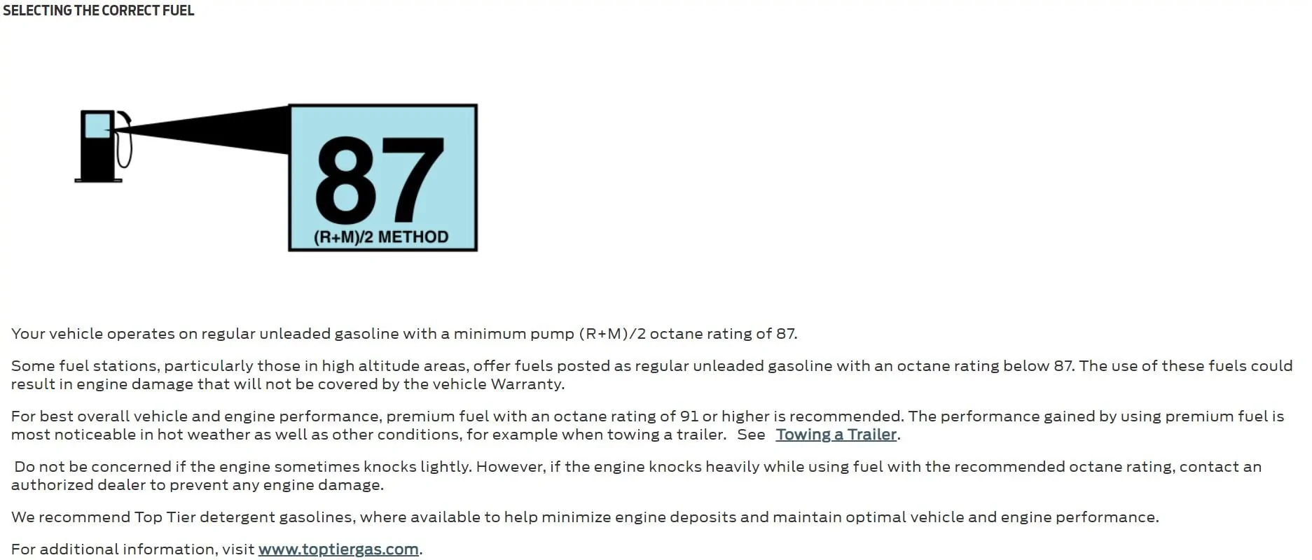

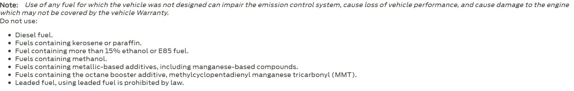

Well, then let's just include that entire section from the manual, shall we?
Indeed, using anything below 87 octane is not recommended.

I'm just going by the owner's manual:
Ford Maverick 88 Octane Gas in Maverick Hybrid? Screenshot 2022-12-01 093000

Then you get this "88 octane" stuff, which is also referred to as E15. Thus, it's 15% ethanol, 85% gasoline. Your Maverick is capable of handling E15/88 octane. However, keep in mind that the lower cost comes with lower fuel economy. Depending on the specifics, it may be cheaper to stick with 87 over 88, but you'd need to do some math to be sure.

No E85 in any Maverick
E10 regular unleaded (87 octane - higher elevations use a lower octane, but Ford recommends against it) is commonplace and perfectly fine.
E15 is also referred to as 88 octane, available in select markets. It's not likely to cause issues but may not be worth the cheaper price per gallon.
Feel free to experiment with higher grades of gas as well as E15/88 octane. Or just stick with regular unleaded/87. It's designed to handle any of those, so long as you avoid E85. And diesel.
