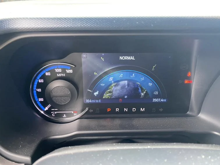

I love ForScan. Used it on my Bronco to disable the double-honk when no fob is inside, enabled the global close for the windows (close windows from the fob), and added Sport driving mode (First Edition doesn't have it by default... here's the before and after of that change):
This is stock -7 Driving modes: Normal, Eco, Slippery, Mud/Rut, Sand, Baja, and Rock Crawl):
Ford Maverick FORScan 101 - Step-by-Step How to Start Guide GroupMe_20211231_21143
This is how it looks now - now I have all 8 modes:
Ford Maverick FORScan 101 - Step-by-Step How to Start Guide GroupMe_20211231_21148
You don't need to buy an Extended License - you can get a trial one and keep renewing it only when you need to edit something, too. All this change took was changing one digit of the ABS module, and restart the Bronco. It took me all of about 5 minutes to do.
