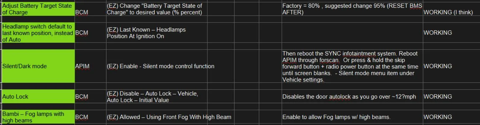

New here, just picked up a Lobo.
I've used Forscan in the past, but learning that the 2025 with Sync4 and 8" productivity screen is different enough that some things don't work or are different than the previous models.
Here is what I've got working so far:
Ford Maverick 2025 Maverick Forscan Codes _ Working 1751254834096-0
Ford Maverick 2025 Maverick Forscan Codes _ Working 1751254865284-d2
Ford Maverick 2025 Maverick Forscan Codes _ Working 1751254907358-ns
Ford Maverick 2025 Maverick Forscan Codes _ Working 1751254945374-b8
Hope this helps someone.
Much of it was from the existing ' 2022-2024 Ford Maverick Forscan Coding List By EONR24 ' spreadsheet. Thank you for your efforts! The spreadsheet from EONR24 : Forscan - Maverick Master List
Some of it I found by trial and error and enabling/disabling until I found the result I was after.

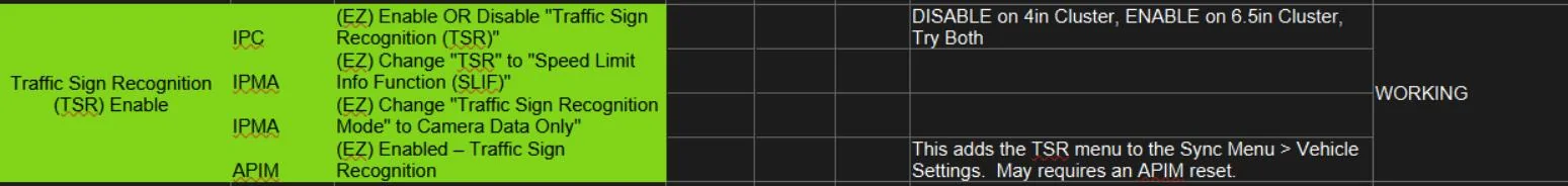

TSR (and specifically the Traffic sign Recog. menu option on the Sync4 display) is from: youtube]vxPqwmCkIIk

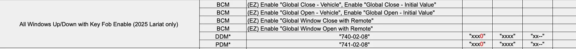

I am unable to get Global Windows Up to work with Forscan (25' Lariet hybrid). Down works fine. Would love to have 'Up' working, when quick summer rains popup out of nowhere.
Same on my 2025 Lariat. Global windows down works fine but unable to get the global up to work. I would really like to have this option. It worked fine on both my 2023 and 2024 year Mavericks.
Hi, it's the same as Escape
I think it's a bug in the forscan soft, showing incorrect values
Try this in asbuilt: (pdm and ddm modules)
edit : not working anymore on new models, go for normal configuration
740-02-08 xxx*-xxxx-xx
741-02-08 xxx*-xxxx-xx
0 = GC enable 1= GC Disable
It worked for me
Just looked into this and the reason it's not working is because the coding for DDM and PDM are moved around on the 2025 compared to the 2022-2024. I just figured out how to get it working and updated the forscan maverick spreadsheet. It is tested and working by @ryan2366. Here is the coding below.

Just updated the spreadsheet with global windows for the 2025. Looks @fcoplo has figured it out as well. I'll add you @r0tax tax to the contributors of the spreadsheet and @fcoplo.
For 2025 models, with Sync4, you should activate all the things also in Apim instead of IPC
Example: Global windows, TSR, and all vehicle settings are managed and stored in APIM
Using normal configuration, there's no need to deal with the as-built.
Kudos to you Sir. I'm traveling & won't be home to make the DDM & PDM changes for several days. Can't wait to try it. Global window 'Up' is a big deal to me. Thank you again!
