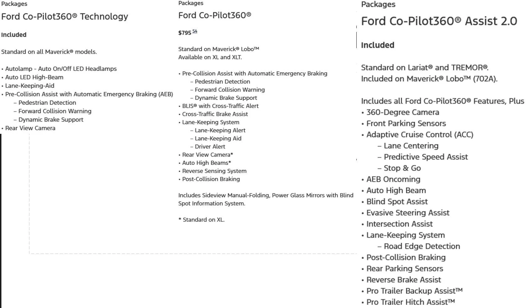

I've been reading this thread and I seem to be on the opposite end. I'd like to add adaptive cruise. I have lane centering via the Copilot package; does that mean I have the hardware needed for adaptive cruise as well, or is that a different set of sensors?

XL and XLT don't have the Crusie Control Module (CCM) radar on front grille that's needed for ACC.
Co-Pilot360 Tech, Co-Pilot 360 Package, Co-Pilot360 Assist 2.0 Package.

XL doesn't have the Crusie Control Module (CCM) radar on front grille that's needed for ACC.
Ah, gotcha, thanks!
