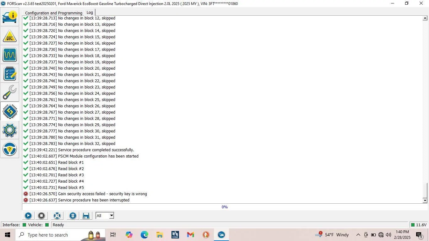

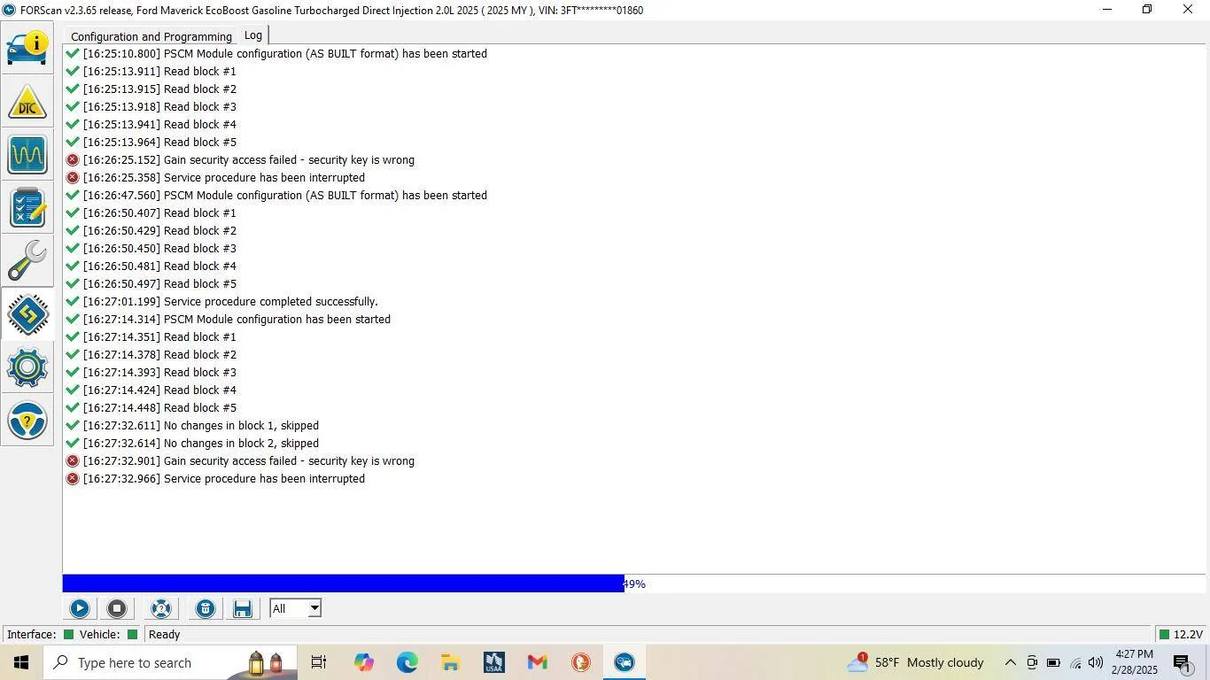

been trying the new Forscan release to disable the start stop feature. I havent been able to write the change to the module this is what i keep getting. any sugestion on what to do next anybody?
I’m getting same error as you.

I just used the test build 2.3.66, to make a back up of all the modules. It was not able to get into the IPMA module, but I could get into everything else just fine. I have sent a message to Forscan support. I'll update when I know more.

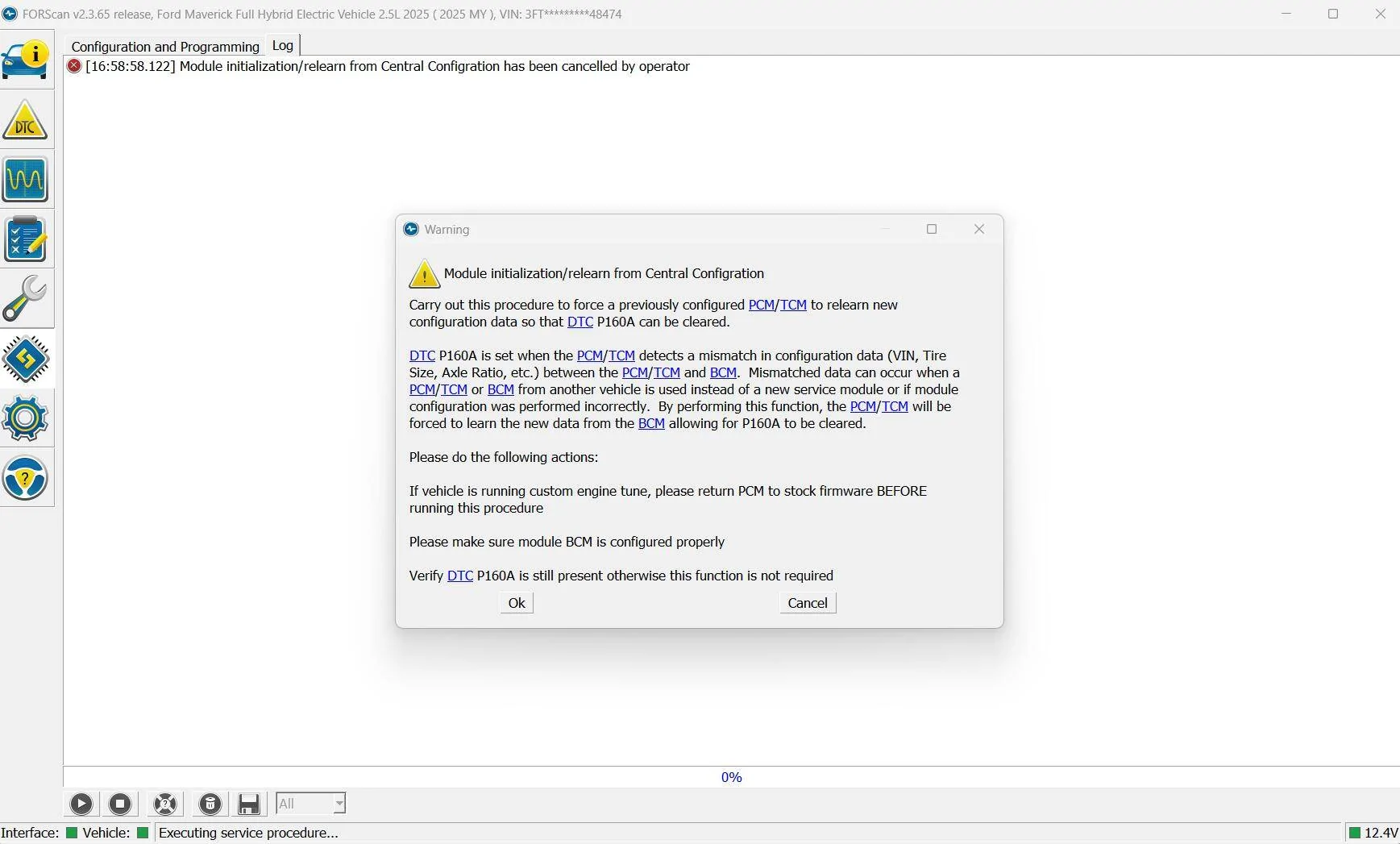

I'm interested in turning off the seatbelt minder with Forscan. I'm getting a message that isn't showing in the tutorial vid however. Should I proceed through this screen?
I haven’t seen that screen before. If I read it correctly, you have DTC code in that module. You can go to the DTC tab and clear it there. The only thing is that it clears all DTCs, no way to clear just one. You should read up on the DTC to see if it matters or not. Sometimes playing with Forscan will throw a DTC as it resets. If I see one that has a timestamp that matches with me doing Forscan stuff, I figure it isn’t a problem. If you can’t, then it might be something you want the dealer to look into.
