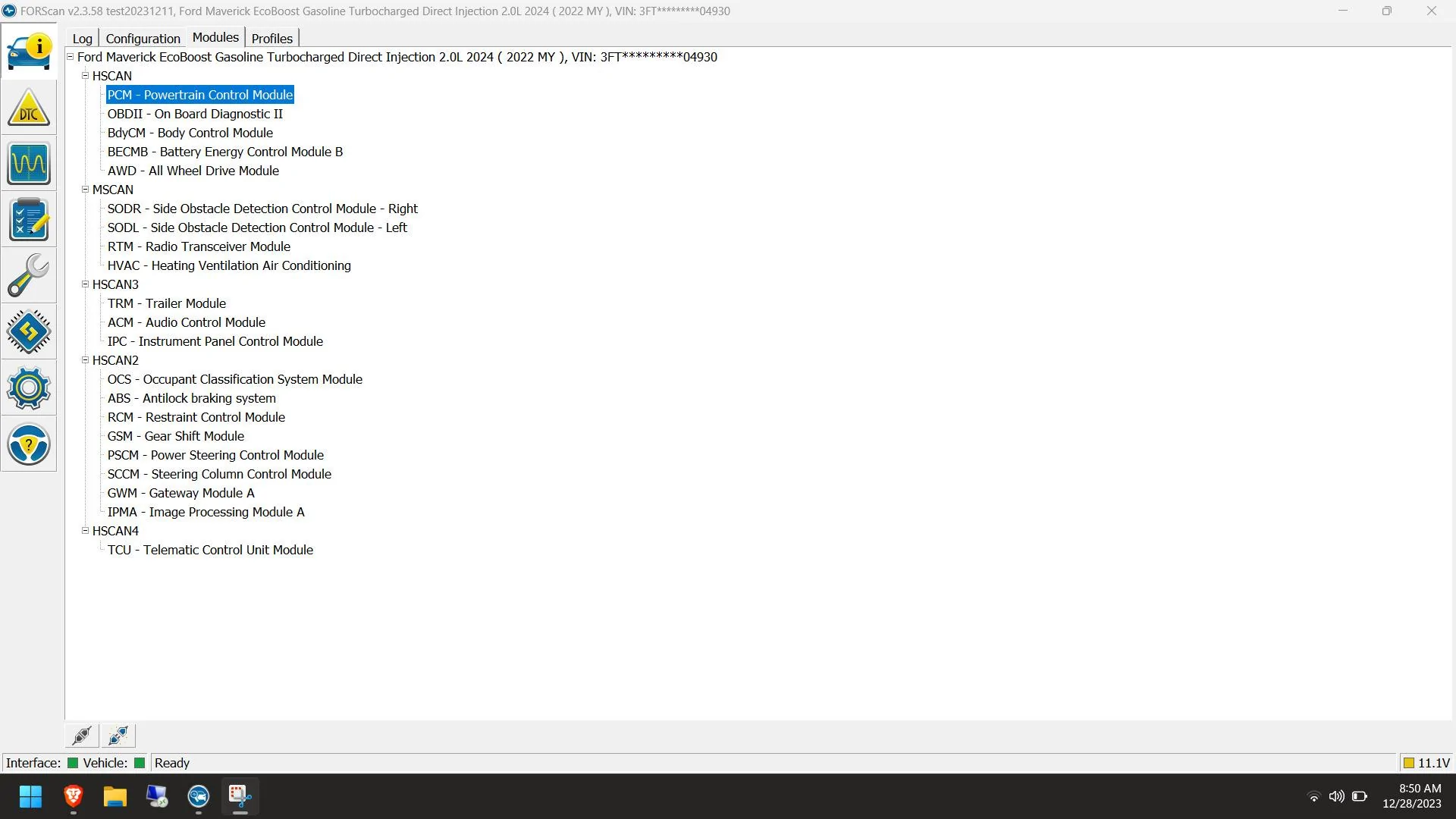

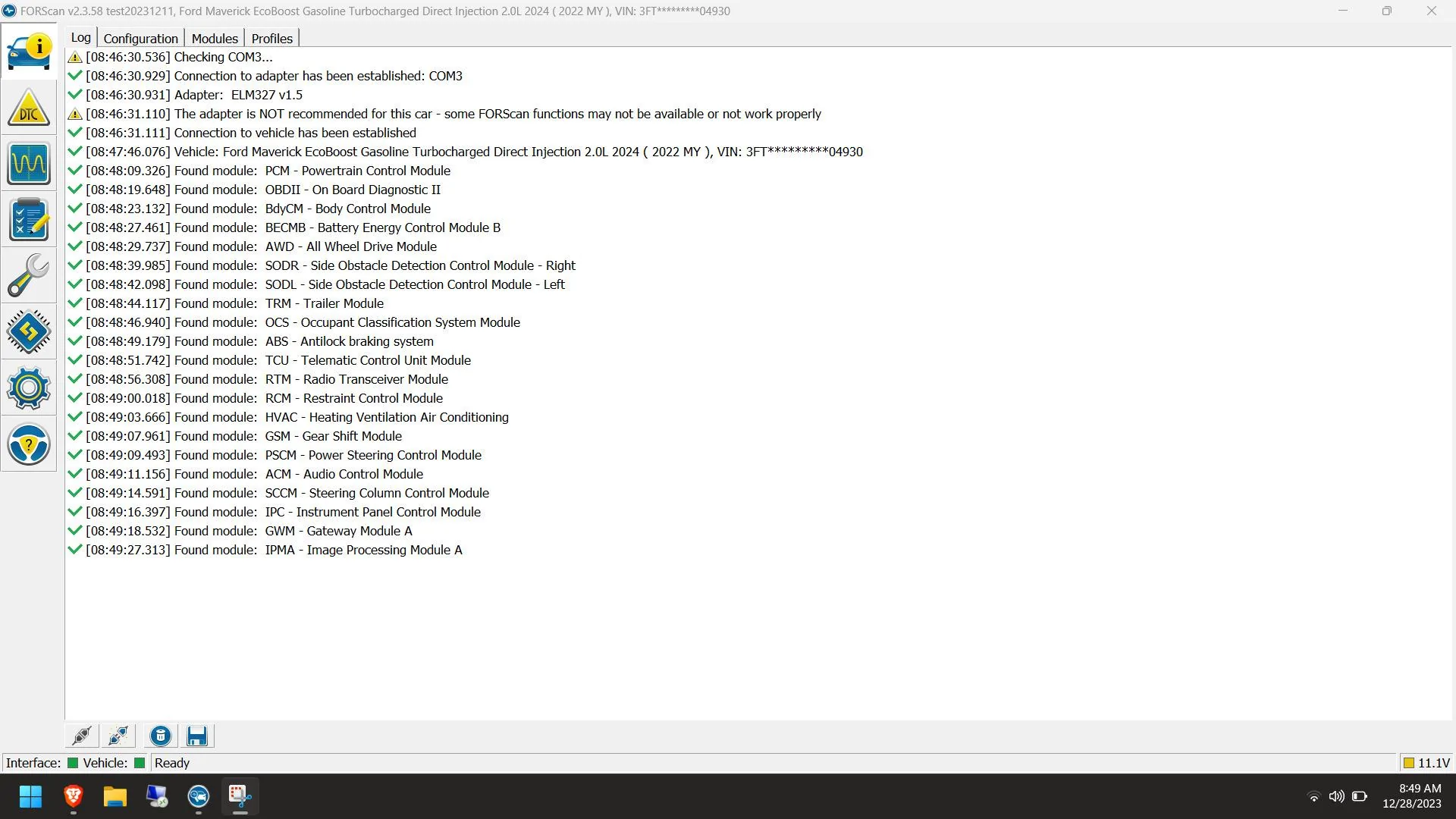

Ford Maverick Anybody get ForScan working with 2024 Mavericks? Screenshot-2023-12-28-085035
Ford Maverick Anybody get ForScan working with 2024 Mavericks? Screenshot-2023-12-28-084954

Can confirm using the test build and code above, it is working on a 2024 Maverick XLT EcoBoost
Sorry for not updating everyone! I was in contact with a developer, he gave me a PCM strategy for a Mach E and I was able to get in. For those with an older update of forscan, try NZ6A-12A650-HC. I did that and got everything I wanted working.
