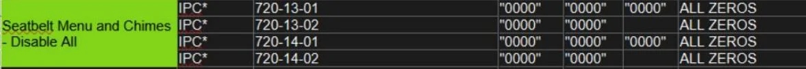

Good work on the Global windows. I'll have to look for that "PEN" module. I know I don't have the DDM/PDM due to my model choice.
You can disable seat belt chimes, i did that first day I had it home. And you can disable the on dash popup that blocks/hides the 'use last mode' popup. Thats in this original post, or the Master spreadsheet. There are some other configurations for seatbelt chimes, and i think you can even disable it with a Ford procedure without Forscan (that is how I did it initially, very similar to the Focus ST procedure with buckle+unbuckle seat belt steps), but I wanted the menu gone.
Ford Maverick 2025 Maverick Forscan Codes _ Working 1752276060839-um
Also, disable that Door ajar chime.. :) Happy hacking.
