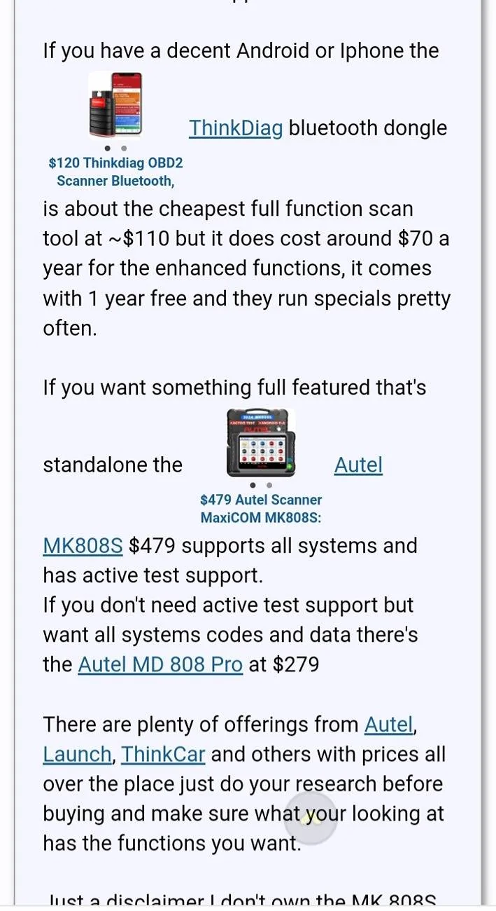

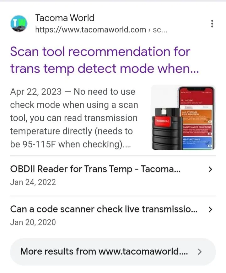

You own a hybrid w/ecvt.
Maybe Toyota Prius forum may have some answers???
Here's a few ideas that I was able to paste up from Tacoma world.
Doesn't cost anything to check them out.
Good Luck
