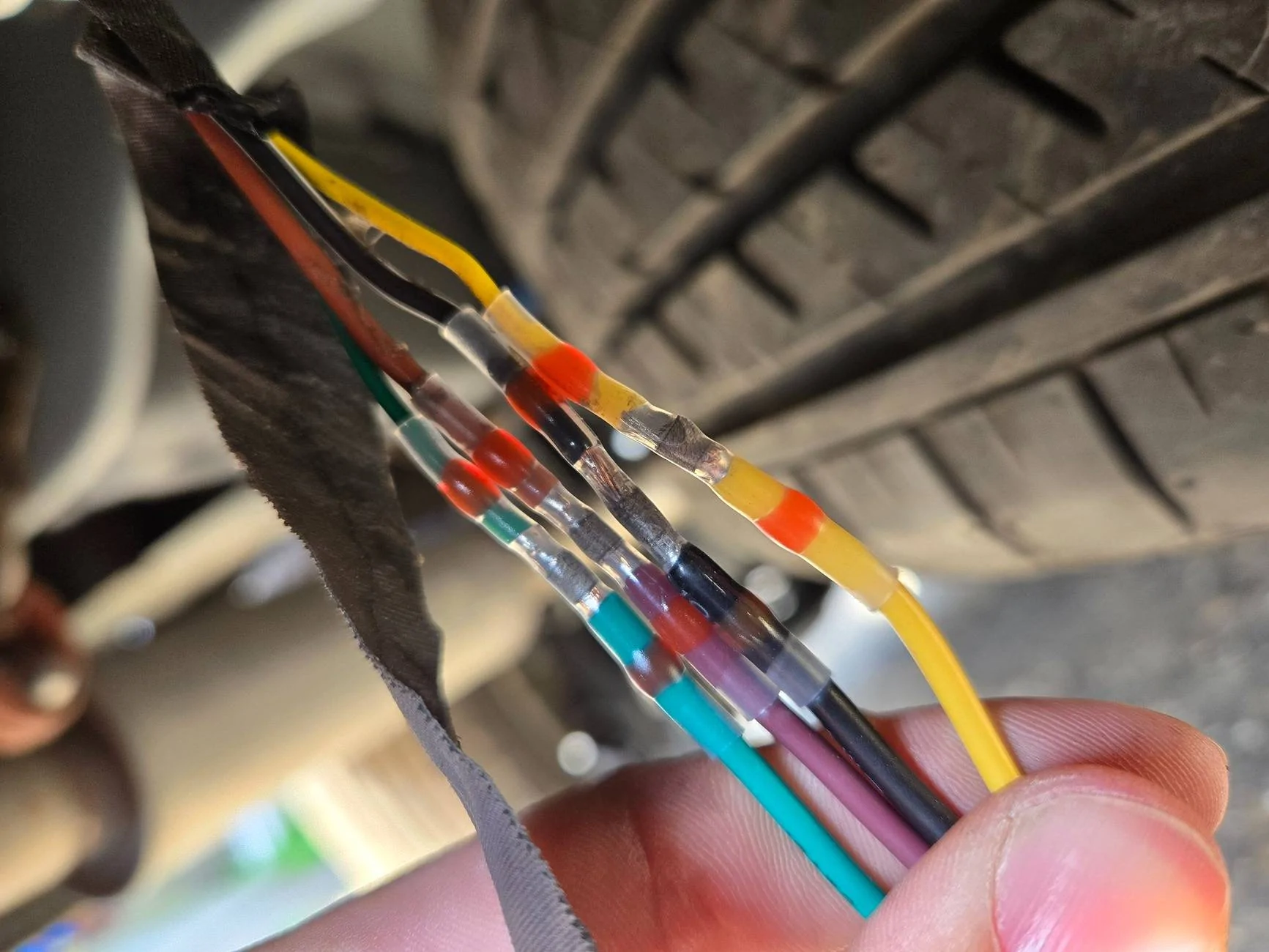

The install of the plug itself was nothing difficult. Since it's an Amazon part, I hooked up a spare flat 4 connector from the trailer side we had and tried all the wires to get the color coding (at least the one we ordered, it actually lined up with the factory color for the wiring). I then used some heat shrink soldier butt connectors and it was done.

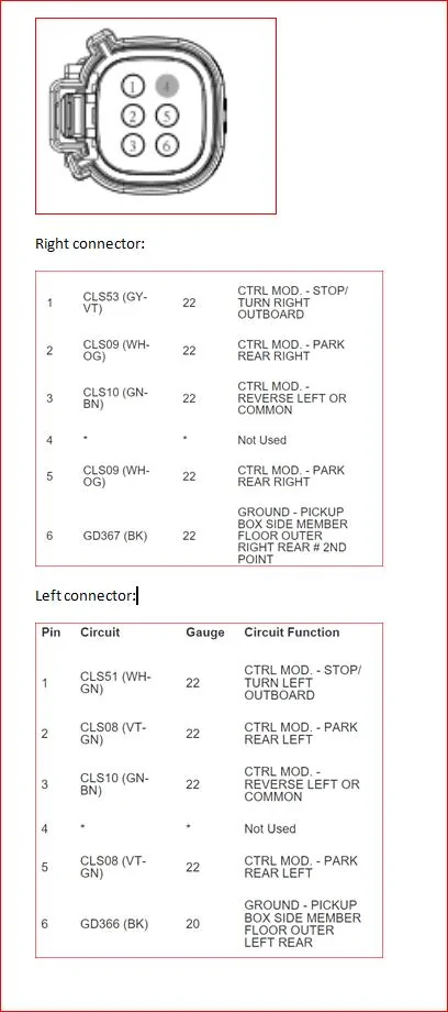

at the taillight harness, green-brown pin #3. I made a jumper so I didn't have to disturb the factory wiring.

Yes. Keep in mind, this is ONLY to tap into the taillight harness for the reverse-light circuit, as I explain above in post #2.
